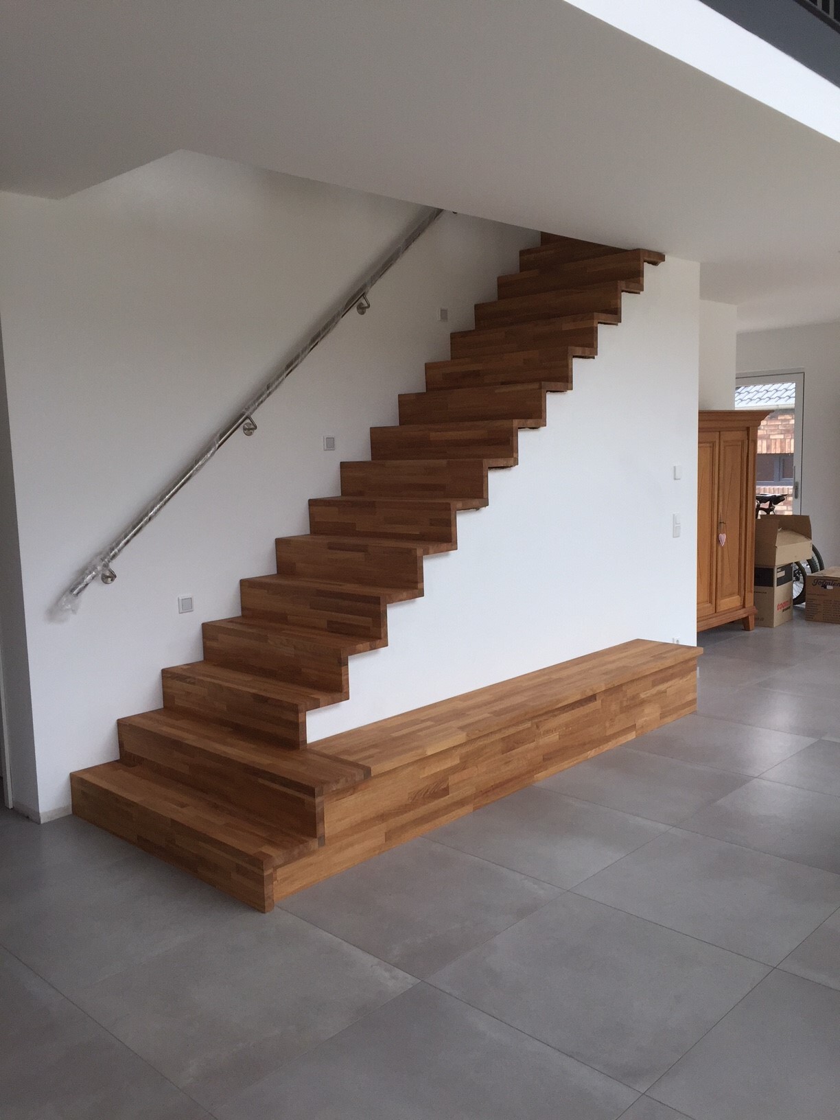

R.Hotzenplotz8 Dec 2017 09:54Haus² schrieb:
Wood covering on a concrete staircase is great. It was also glued down really securely...Wow, that looks amazing!
How much did the stair covering cost for you?
What kind of companies do you contact for a staircase like this?
An alternative would be a pure folded plate staircase – which is probably simpler than using concrete underneath.
In your case, the staircase is viewed from the side, and it is located in the entrance area. A bench there would be nice.
1.
Here (for searching) is a really (!) nice idea for
folded plate staircase + glass + bench + basement access.
Google: SMG stairs wooden staircase HOT 2200
2.
We had ours done a bit differently, as folded plate stair treads on concrete steps by a local joinery (unfortunately it was expensive; the photo is not yet final, a glass panel on a bracket will also be added):
More at #6 here.
https://www.hausbau-forum.de/threads/holzstufen-auf-Betontreppe.24399
The wood provides a nice contrast to the tiles in the house.
1.
2.
More at #6 here.
