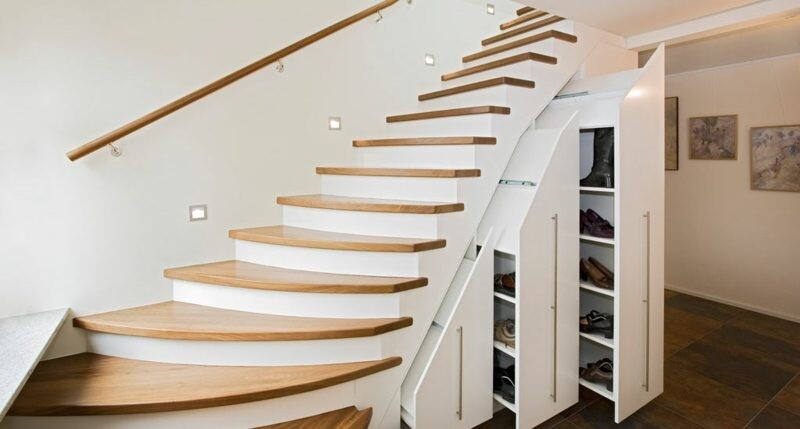

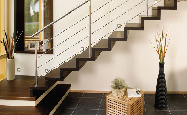

R.Hotzenplotz6 Dec 2017 18:58My wife doesn't like the wall that much but would agree to it. However, she would want a wall at the top as well, not a stainless steel railing. She insists on consistency.
R
R.Hotzenplotz7 Dec 2017 21:10If you choose a wooden staircase, make sure it is properly glued.
At a friend’s place, they only used some kind of foam adhesive underneath, and after 1-2 years it started creaking when walking on it – really annoying!
Also, the concrete staircase covered with wood wasn’t exactly cheap.
Probably only natural stone is more expensive?
R
R.Hotzenplotz7 Dec 2017 21:54Understood. Of course, we need to keep an eye on the costs. So far, the plan has been to cover the currently planned concrete staircase with the same tiles that we will use on the ground floor. On the upper floor, parquet flooring will be installed.
If we were to choose a wooden staircase, how much would the price differ approximately from the standard planned concrete staircase? Would it be a significant difference?
Wood over a concrete staircase does not seem to be a good solution, based on your statement.
