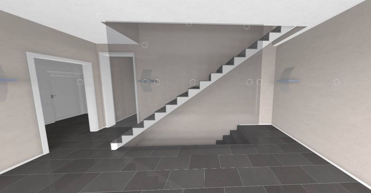

R.Hotzenplotz2 Dec 2017 22:05This is roughly how it will look when entering through the front door. The glass wall in front of the stairs will not be implemented. Originally, the plan was to install a stainless steel railing here. However, I’m not sure if it’s a good idea to have a stainless steel grid right at the entrance, directly overlooking the stairwell opening to the basement.
The lighting designer suggested building a wall instead of a stainless steel grid in front of the stairwell opening. Would something like that look appropriate? It would probably be constructed at the same height as the railing would be, rather than extending all the way up.
Upstairs, the railing can be stainless steel without any problem. Alternatively, a glass infill was offered for about €1,900 extra.
R.Hotzenplotz schrieb:
However, I’m not sure it’s ideal to enter and immediately see the cellar opening through the stainless steel grate. No, with tiled flooring it looks like a descent into a swimming pool.
The lighting planner suggested building a wall instead of having a stainless steel grate in front of the stairwell opening. Would something like that look decent? It would probably be built to the same height as the railing and not all the way to the ceiling. So, rising from the ground floor level up to the handrail height of the stairs leading to the upper floor? I think that would work best. I would then use stainless steel as the top finish of this "railing wall," and toward the cellar side, a handrail made of stainless steel.
