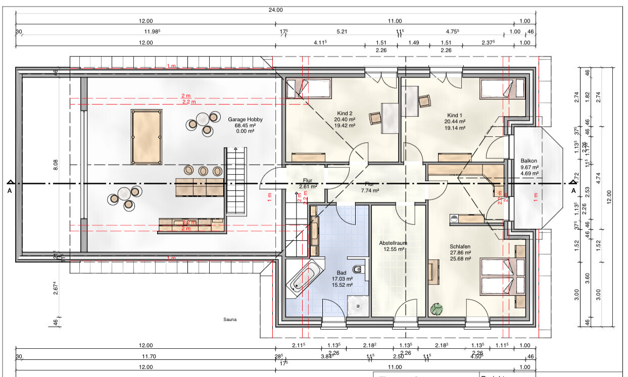

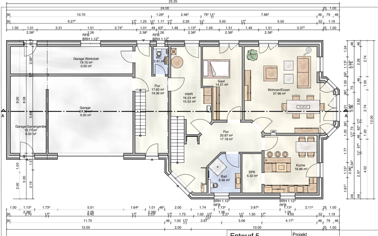

I have been following this forum for some time now, looking at other threads as well as their floor plans and feedback.
My wife and I are already in contact with a construction company, and the floor plan is roughly finalized. I also contributed to the design of the ground floor.
However, I am not satisfied with the layout of the upper floor because you have to walk through the dressing area to reach the bedroom.
I have been planning and moving walls around for about a year now, and I am starting to get somewhat "blind" to the design.
I would really appreciate any constructive feedback, both positive and negative, on the floor plan.
The rooms are quite large, but we prefer it that way (child’s room about 20sqm (215 sq ft), etc.).
Originally, we wanted a full basement, but due to the groundwater level, this is no longer possible.
That is why the rooms are arranged around the garage, with a large utility room including a cloakroom on the ground floor, and a laundry room on the upper floor.

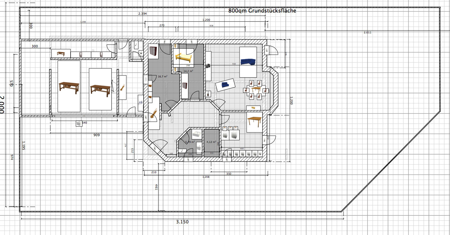

The site plan including the property boundary is provided just to help visualize the dimensions of the plot.
Attached are the floor plans.

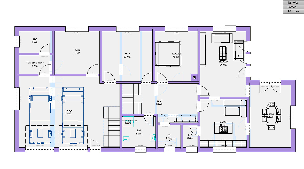

Grundriss eines Einfamilienhauses mit Garage, Gästezimmer, Wohnen/Essen, Küche, Bad, Fluren, HWR, WC.
Architektur-Grundriss eines Hauses mit zwei Schlafzimmern, Küche, Bad, Wohnzimmer und Fluren.
Grundriss eines Hauses: Garage/Hobby, 2 Kinderzimmer, Schlafzimmer, Bad, Flur, Balkon, Sauna.

And regarding the staircase and hallway on the upper floor... yes, they also take up quite a few square meters (square feet), but this way I don’t need a second staircase, which would also occupy a considerable amount of space.
Again, it’s your house, and you have to be happy with it. You’ve heard my concerns. Now you should simply focus on the cost planning. Perhaps that will make you reconsider one thing or another.

Oh man, this kind of thing just keeps bothering me.
Have you considered who is going to clean and maintain all of this? For example, water points:
- Kitchen
- Ground floor cloakroom
- Ground floor guest bathroom
- Garage toilet
- Upper floor bathroom
- Upper floor utility room
Then the storage areas in the garage and on the ground floor, and based on your recent comments, partly also in the party room. I usually pay close attention to sufficient storage space in floor plans, but I think this storage requirement should be reviewed, especially regarding how it’s distributed.
And again, regarding the pantry... you plan to have a freezer cabinet there and definitely a window, so make sure the room is at least about 140 cm (55 inches) wide, otherwise the freezer door won’t be able to open.

Floor plan of a house with several rooms, staircase, hallway, bathroom, kitchen, and party room.
Floor plan of a house: garage (2 parking spaces), living room, kitchen, dining, bedroom, hallway, utility room, WC.

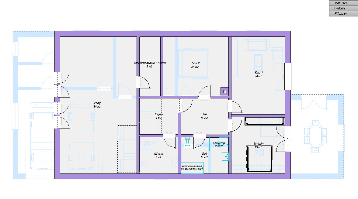

You say the kitchen is at the top of the plan because you don’t want to look at the wooden fence to the east while working in the kitchen. But if I mention that you do end up looking at that fence when sitting on the sofa, and then you say you don’t see the wooden fence to the north... do you see the contradiction?
Yes, I do see it! Because I know my situation, requirements, and wishes well. If the kitchen window faces exactly north, then I would be looking through that window at the wooden fence. But the living room does not have a window facing north, so I can’t see the fence from there. I can only look south into the garden. Of course, I can see the wooden fence around my property from there. But again, please don’t interpret every word too literally — try to understand what I meant. This isn’t about finding loopholes or minor flaws just to criticize the floor plan.
kbt09 schrieb:
And again about the pantry... you plan to have a freezer cabinet in there and definitely a window, so make sure the room is at least about 140 cm wide, otherwise the freezer door won’t open.
We have already simulated this pantry exactly. We manage with 1.35 m (4 ft 5 in). The door can still open easily and there’s space behind it.
In general: If long, narrow rooms are acceptable and 2.8 m (9 ft 2 in) is enough to fit a bed, then what exactly is wrong with the floor plan? I haven’t seen any major improvements suggested so far.
Honestly, the secondary rooms are of lower priority to me. What bothers me is that despite having over 200 sqm (2,150 sq ft), my living room is quite small. That would be one point. But I also don’t want the house to be any larger. So to make the living room bigger, something else has to be smaller. But it can’t be the kitchen.
The water connections in the ground floor bathroom, kitchen, and upstairs bathroom I consider standard. Many houses also have an additional kids’ bathroom upstairs, so that’s +1.
Having a water tap in the utility room is something I like; we’ve seen that with friends and they manage well with it.
An extra bathroom for the party room in the basement is something many others also have. That would certainly be acceptable in a basement. Anyone with a laundry room in the basement will have water connections there. Since my laundry room is upstairs, it should have water connections as well.
So the number of water connections seems reasonable for such a large house. The tap in the utility room could be debated; the rest is “standard.”
I think I have a pretty clear understanding of the requirements. At first, some wrote “it’s nothing special” or “it should be easy” (loosely paraphrased, not literally).
That’s why outsiders don’t really make progress against my points, and why it’s difficult to convince me otherwise. But believe me, if I thought another option was better, I would adopt it. I just don’t see any major improvements right now. So what’s really so bad about my design?
I WANT the second staircase. I think you just have to deal with that. I WANT a hallway as a passage room for coats, etc. I WOULD LIKE to have a kitchen island. If the passageway gets too narrow, the kitchen island will simply be 20 cm (8 inches) narrower.
I critically review my design, and so do you — make counterproposals. But for me, nothing dramatically better has come up. Some ideas are certainly thought through differently and aren’t bad. But when I review everything here again, my design isn’t so wrong. You might not like the angled walls — that’s fine.
I presented a design with a straight corridor and other changes. I wanted feedback on that. But there wasn’t much response. Nobody really discussed the pros and cons of the new corridor layout, always referring back to the old plan. So this keeps going in circles.
