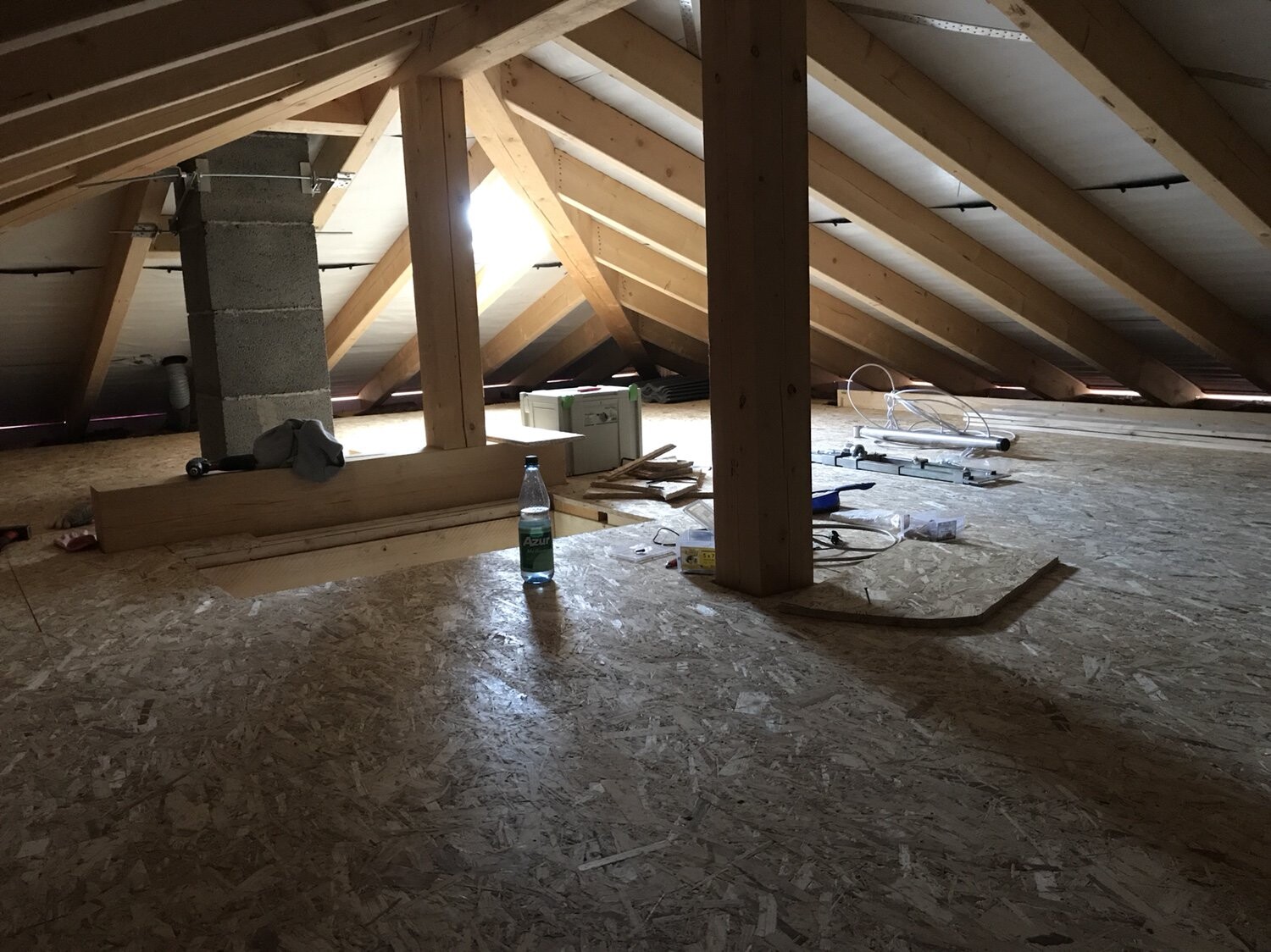

RobsonMKK schrieb:
Still, the roof doesn’t offer any possibility to put anything down.There’s a huge basement for that [emoji2]
RobsonMKK schrieb:
You know, we have that too. Still, I wouldn’t want to give up this space:
And that’s just not possible with a truss roof.I can’t relate to either—the attic or the basement.
For me, storage is a necessary evil. There are things you store, like Christmas decorations, suitcases, extra dishes, or old junk. Accepting cold, darkness, or a steep staircase for that is fine, but it’s not for me. A side storage area, a storage room on the living level, or a built-in closet offers much more convenience.
I’m also not a fan of unused rooms. The fitness basement is chilled, the party room covered in cobwebs. Before I can use such rooms, I’d have to do some work. That’s not something I’m up for anymore [emoji23]
I can't relate to either—the attic or the basement. Both are very useful when you have small children.
For me, abandoned rooms are no good either. The fitness basement is cold, and the party room full of cobwebs. Probably a relic from earlier times. In our case, the basement is wonderfully warm.
RobsonMKK schrieb:
Still, the roof offers absolutely no possibility to place anything. For the builder, the focus here was on aesthetics; there is more than enough space provided underground, and in my opinion, the garage is also generously sized.
