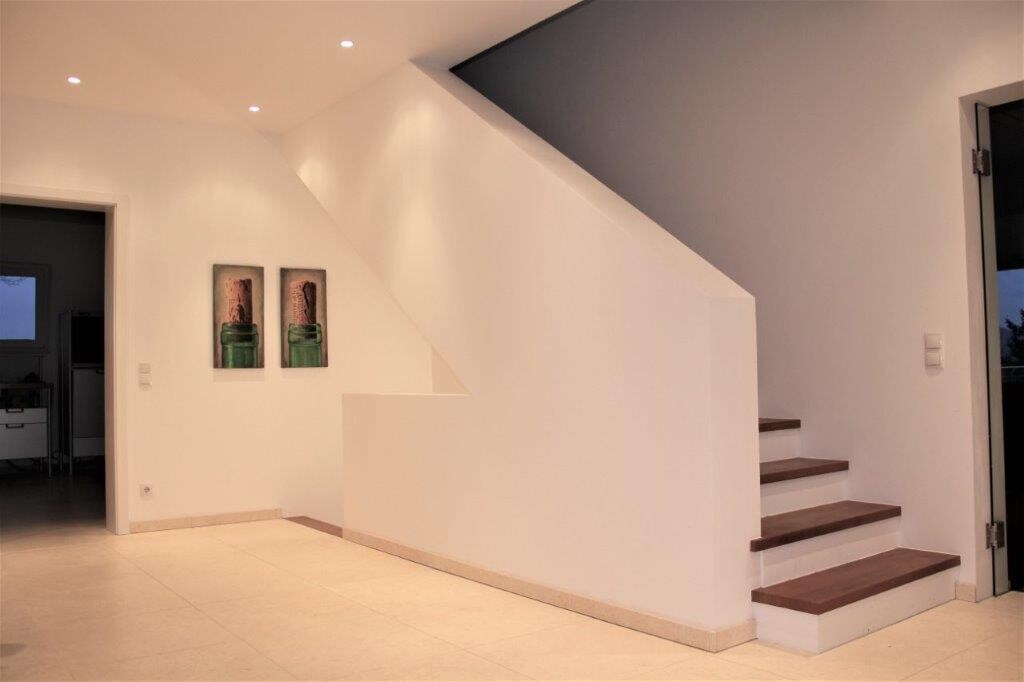

Our stairwell is open from the basement all the way up to just below the roof. The hallway in the basement is heated. You can clearly notice when the heating is off. It is always set at 2-3 out of 6, because a base level of warmth is necessary. All rooms in our house stay warm, regardless of whether they are in use or not. Constant temperature fluctuations are not economical with underfloor heating combined with a controlled mechanical ventilation system. The energy consumption is completely reasonable given the outdoor to indoor temperature difference. Just mentioning this in passing.
