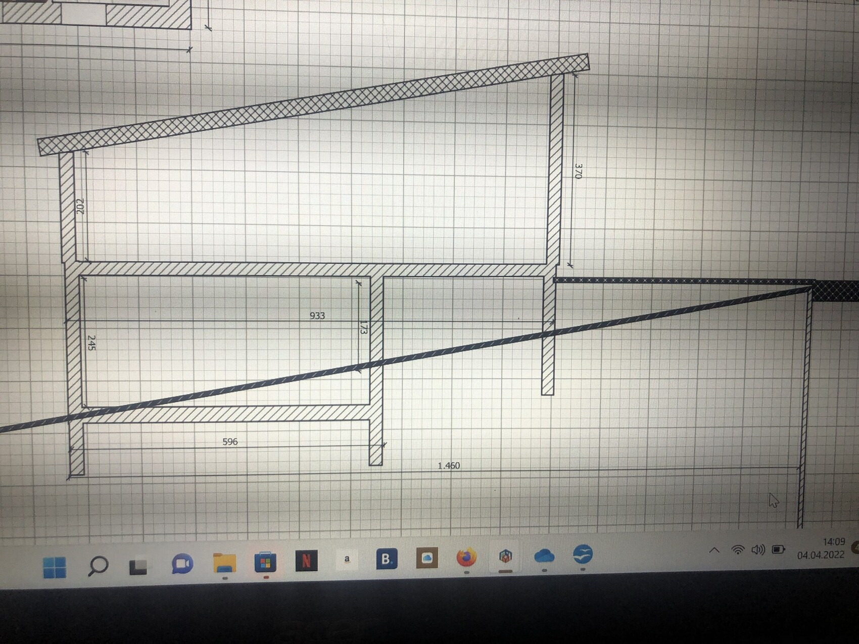

We are actually approaching retirement, and this is supposed to be our last house, so at least the necessary rooms should be on one level. We also want to avoid taking out any more loans.
A basement was never planned but is now necessary because of the approximately 23% slope (we are building with the slope and have the entrance level at street level).
We wouldn’t need an outdoor staircase if the basement is used purely for storage since the north wall of the basement would be level with the garden.

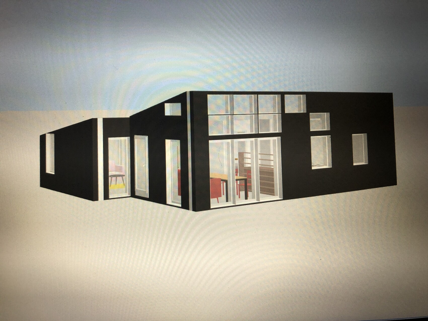

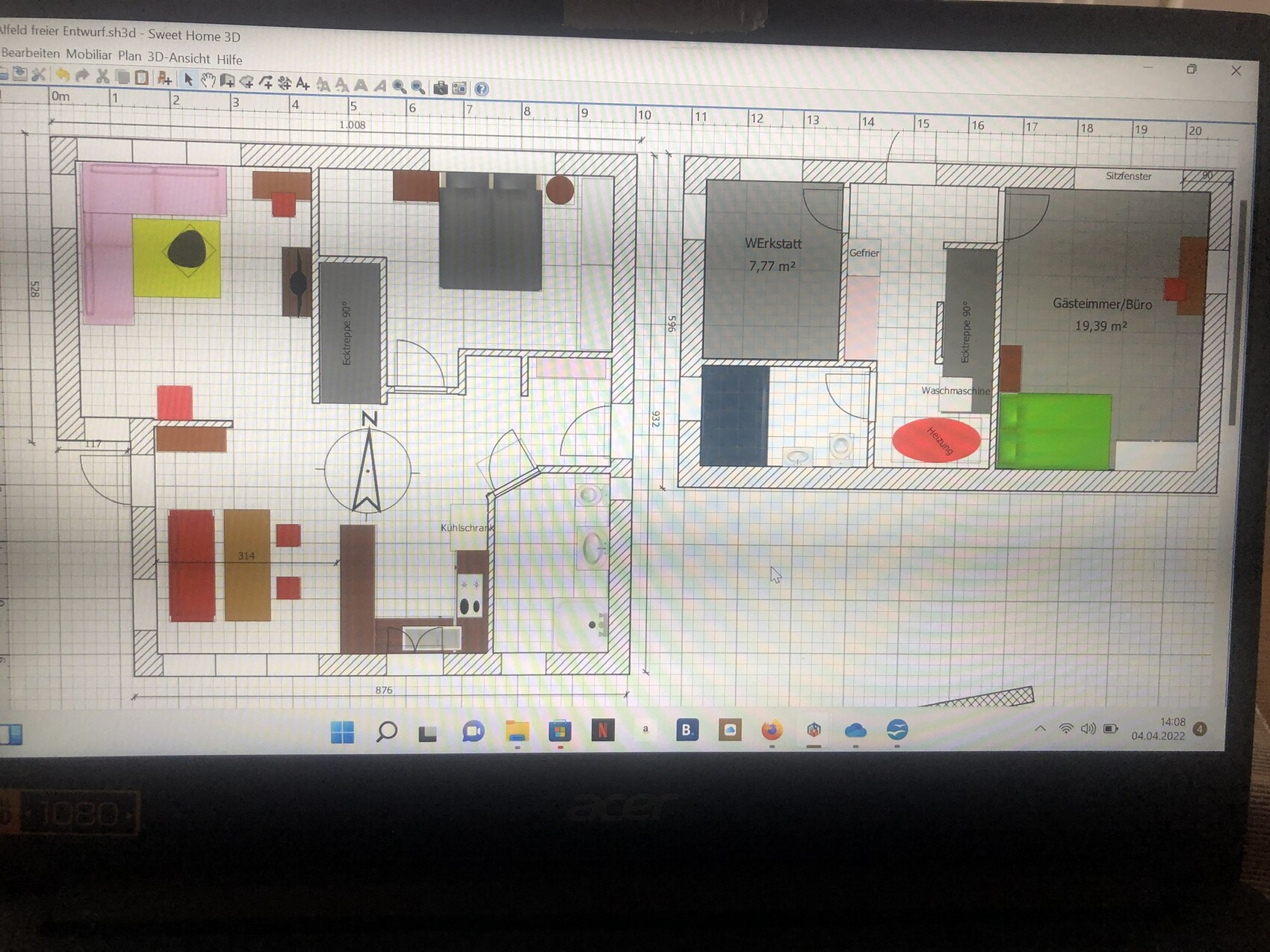

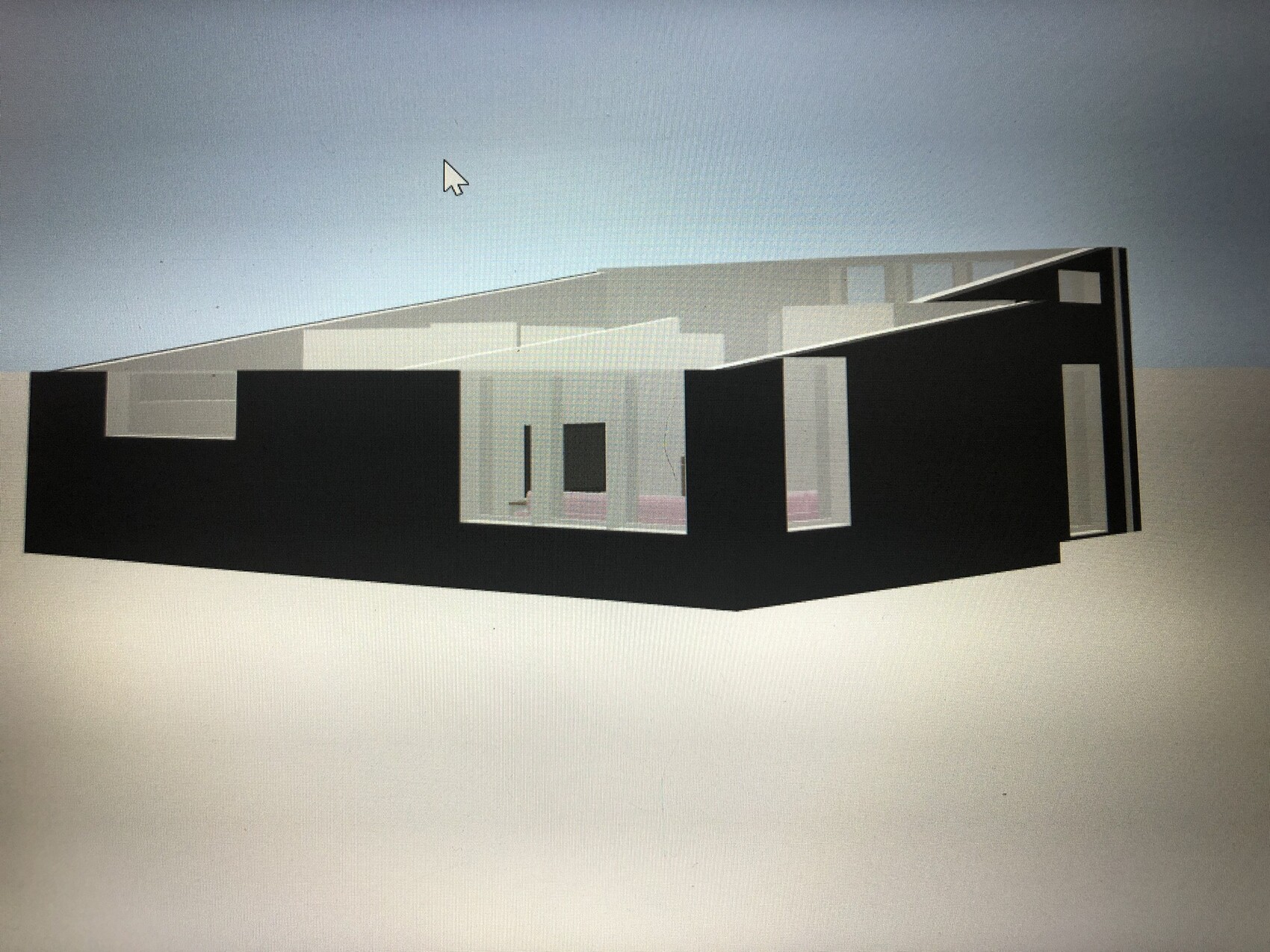

I am attaching my amateur sketch of the house here.
The plan is for a shed roof with the high side facing the street/south to get as much sunlight into the house as possible.
With no other choice, I have drawn the basement next to the house.

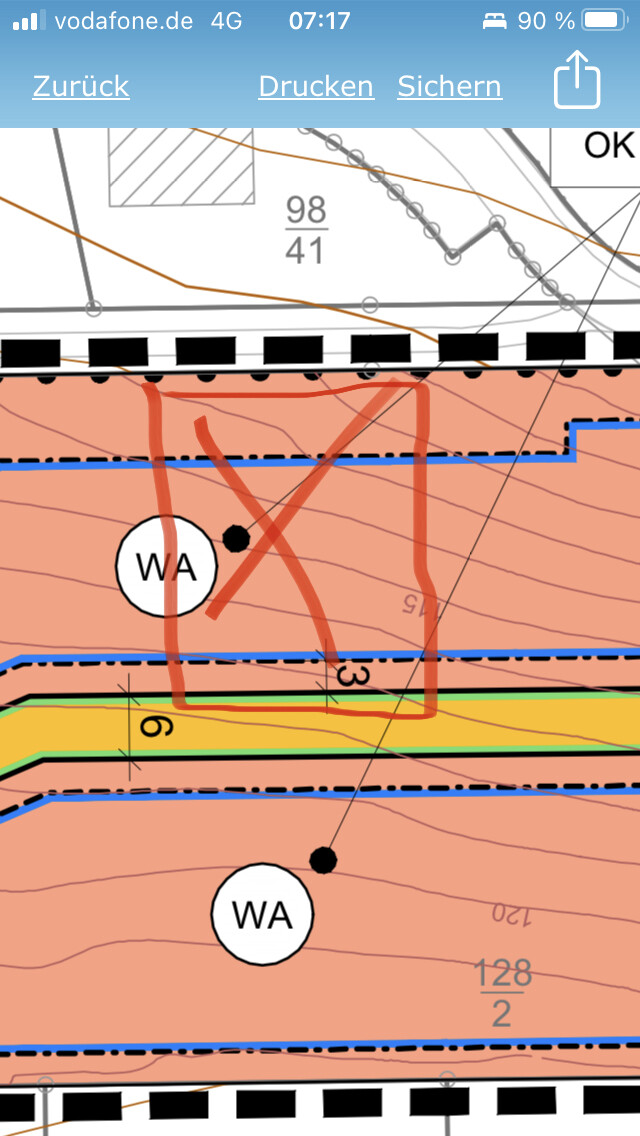

There is a development plan that allows almost everything, the construction road is already built. Sewer shafts are at the end, on the lower side of the plot.
