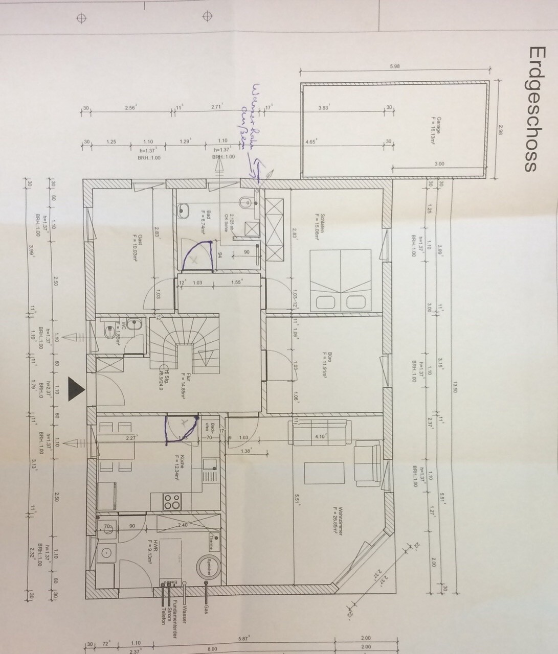

Let’s assume the following: 650 square meters (7,000 square feet) plot size with a floor area ratio (FAR) of 0.3. That means 650 multiplied by 0.3 equals 195 square meters (2,100 square feet) buildable area. If we allocate 30 square meters (320 square feet) for a terrace, you have 165 square meters (1,775 square feet) left. So, an 11 by 14 meter (36 by 46 feet) bungalow would fit. That’s not small. Ours is 10 by 13.5 meters (33 by 44 feet). Basement? Make the roof a bit steeper and add stairs up instead of a floor hatch. Use prefabricated trusses for the roof structure. Then you have an affordable basement.
Who plans something like this? Scanhaus Marlow. They provide tips. Our house was inspired by their catalog, but a local building contractor from Ytong built it. K.

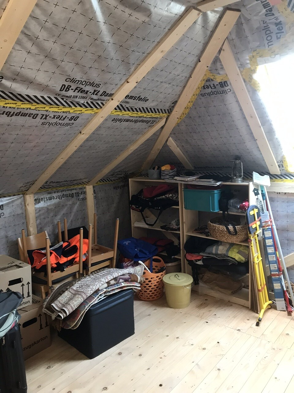

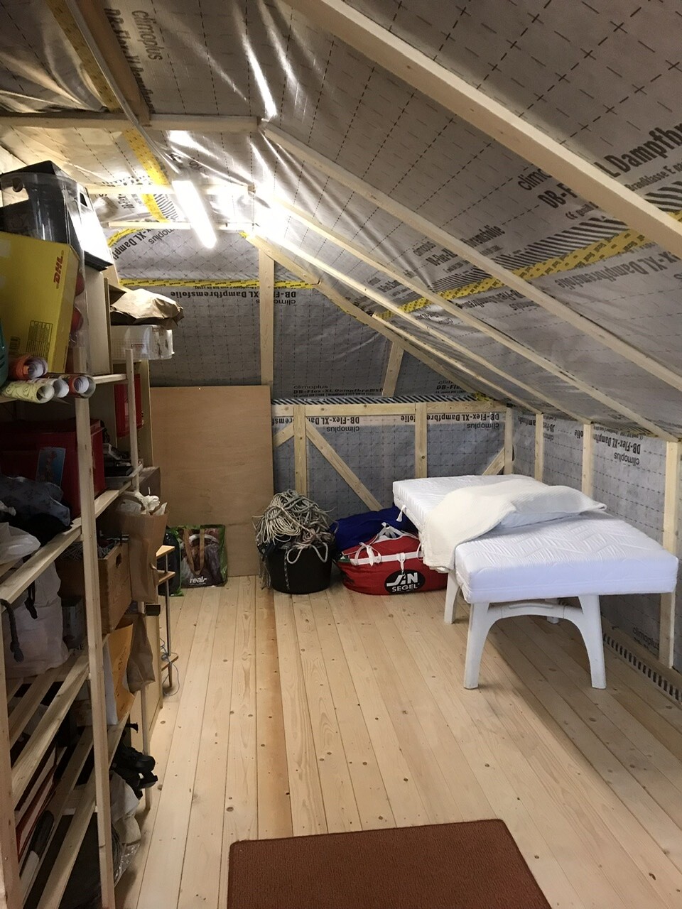

Niriach schrieb:
Eaves height above plinth height max. 3.50 m (11.5 ft); floor area ratio 0.7; pitch 25-30°; open construction style. If this is from the zoning plan / building permit, then having a top floor with a knee wall of only about 70 cm (28 inches) max. and a roof pitch of just 25-30° would not be very comfortable either.
