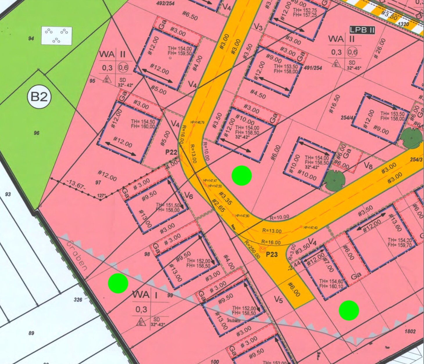

We might have a (rather rare) chance locally in the bidding process to secure a well-located plot in a new development area (edge location, quiet, green views, strategic position for school access, affordable...).
I have attached a section of the development plan (no significant slope – only 0.5m (1.6 feet) incline along both axes).
The problem: We are a family of five with three children. In principle, we could build 2.5 stories (possibly with a basement if needed), but the single-family house building footprint is like a "cut-off semi-detached house" measuring 12m by 7m (39 feet by 23 feet).
We need three children’s bedrooms and a study. Preferably small (10m² (108 square feet)).
Question: Is this at all reasonable on such a small plot (or building footprint)? I’m asking to avoid convincing ourselves it works when it might not. The location is very good for us (the children could stay at their current schools). However, I have never seen a comparably narrow and tall single-family house in a new development. The only thing I found to get a rough visual idea was the Citline 2 model from Allkauf Haus (and that one is longer).
Many thanks!
Development plan / restrictions (see photo)
Plot size: 350m² (3,767 square feet)
Slope: No. 0.5m (1.6 feet) incline short axis, 0.5m (1.6 feet) incline long axis
Site coverage ratio: 0.35
Floor area ratio: 0.7
Building footprint, building line, and boundary: see plan, 12m x 7m (39 feet x 23 feet)
Number of floors: should be 2.5 or 2 with basement
Roof shape: gable (or hip) 30–42° (15–20°)
Orientation: NW to SE
Maximum height limits: 154/160 (presumably centimeters or regulations – please clarify)

Katasterkarte mit grün markiertem Grundstück neben gelber Straße auf rosa Flächen.
Lageplan mit gruen markierter bauflaeche auf farbiger karte
hanghaus2023
30 Sep 2024 10:45
Unfortunately, you have crossed out the reference height in bold green.
But a house with that number of rooms should definitely be possible.

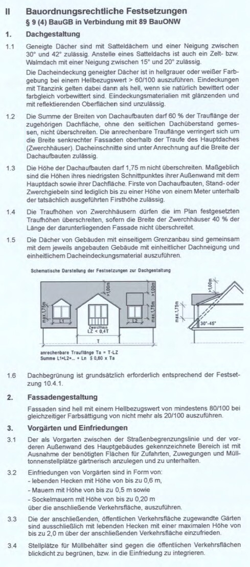

Thanks! Yes, we definitely plan to contact them. I can imagine a semi-detached house in a full duplex of this size over three floors. However, I find it difficult to envision this for such a narrow single house footprint with a semi-detached layout. I’m also not sure whether the garage might need to be included under the gable roof – see point 1.5 of the development plan text below.
But: We really should speak with an architect. This option has come up rather suddenly for us.
Pages of a building regulation plan with roof design and sketches of eaves and roofs
Construction law document with rules for roof and facade design and diagrams.

This also gives me the chance to show the other two plots (light green dots on the left and in the middle).
Right now we are considering whether a larger bungalow with a finished basement (perhaps in the style of a granny flat) would be an option for us. The left plot has a nice, unobstructed garden but can only be built as a single story. In terms of accessibility and possible future rental, that would of course be an advantage.
Regarding the available floor area ratio (FAR): I suppose a loft extension wouldn’t be allowed, right (NRW)?
The middle plot could be built on very traditionally but there is a slope of 0.7 m (27.6 inches) in the garden down to the relatively open street. However, that should definitely be manageable.

Farbig gezeichneter Lageplan: pinke Parzellen, gelbe Straßen, grüne Flächen mit Markierungen.
Schorsch_baut
30 Sep 2024 11:10
I find that rather difficult. Seven rooms spread out on a bungalow footprint? And if the daylight basement only has light wells or courtyards, in my opinion, that results in less valuable living space compared to building upwards. Building higher provides better views and natural light.
