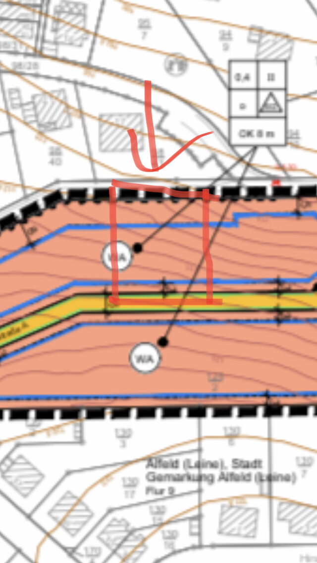

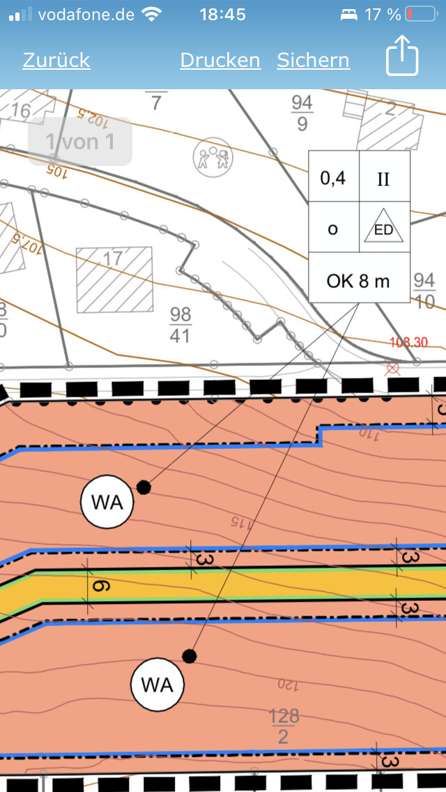

To start thinking about how you can arrive at an affordable solution, it’s important to check what the zoning plan says and what the site plan indicates regarding the blue line or property boundary. It looks to me like there is only a building zone?
However, you still need to know if there are any restrictions.
Unfortunately, I don’t have more information; the new development area has not yet been fully surveyed.

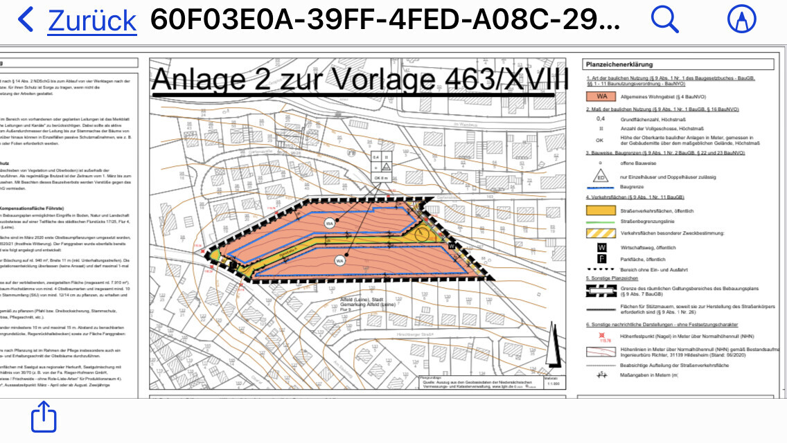

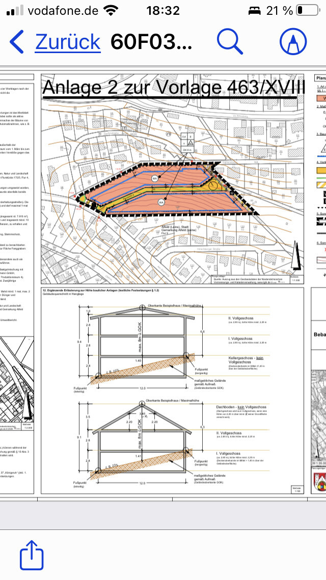

Site plan of the construction project with color-coded areas, outlines, and cross-sectional drawings.

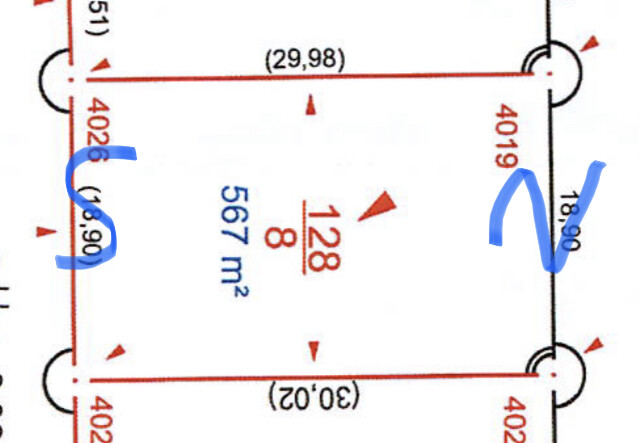

Rectangular plot with red boundary lines; area 567 m² (6100 sq ft), parcel no. 128.
Site plan with color-coded building area and legend on the right, Annex 2 to submission 463/XVII

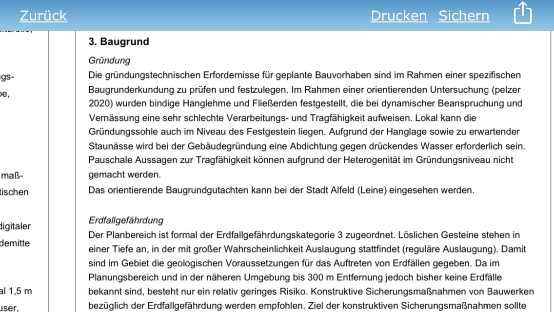

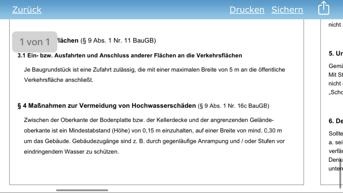

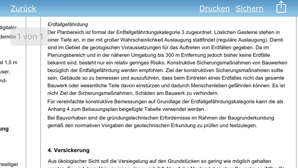

Unfortunately, I am unable to upload the entire PDF document here.
Document page: text sections about building ground, foundation, and sinkhole risk (category 3).

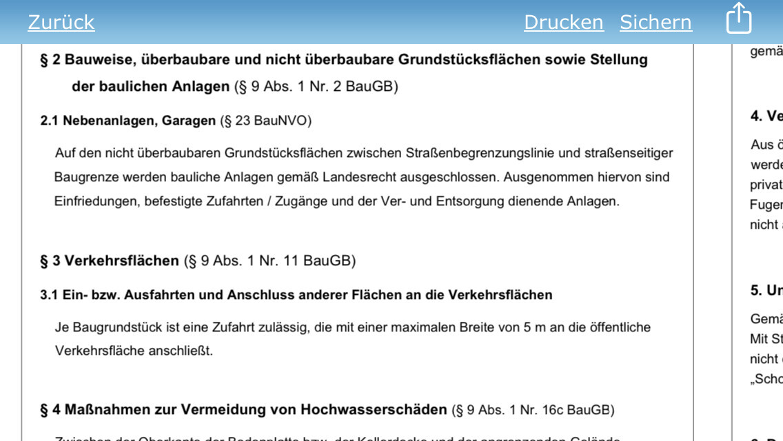

Excerpt of a planning page with text about sinkhole risk and construction measures for stabilization.
Document page with section 1.2 Height of buildings (§16 Building Use Ordinance) and body text.
Excerpt from a legal text on building methods, ancillary structures, and traffic areas (Building Code/Building Use Ordinance).
Document page with headings and paragraphs on access roads and flood protection.

Unfortunately, it hasn’t been surveyed yet. But from my roughly drawn outline, you can already see that the slope does not run evenly toward the northern boundary, but rather diagonally toward the northeast.

Unfortunately, it has not been surveyed yet. However, you can already see from my irregular boundary line that the slope does not run evenly towards the northern border but diagonally towards the northeast.
Here again, in better quality – I really don’t have anything else yet

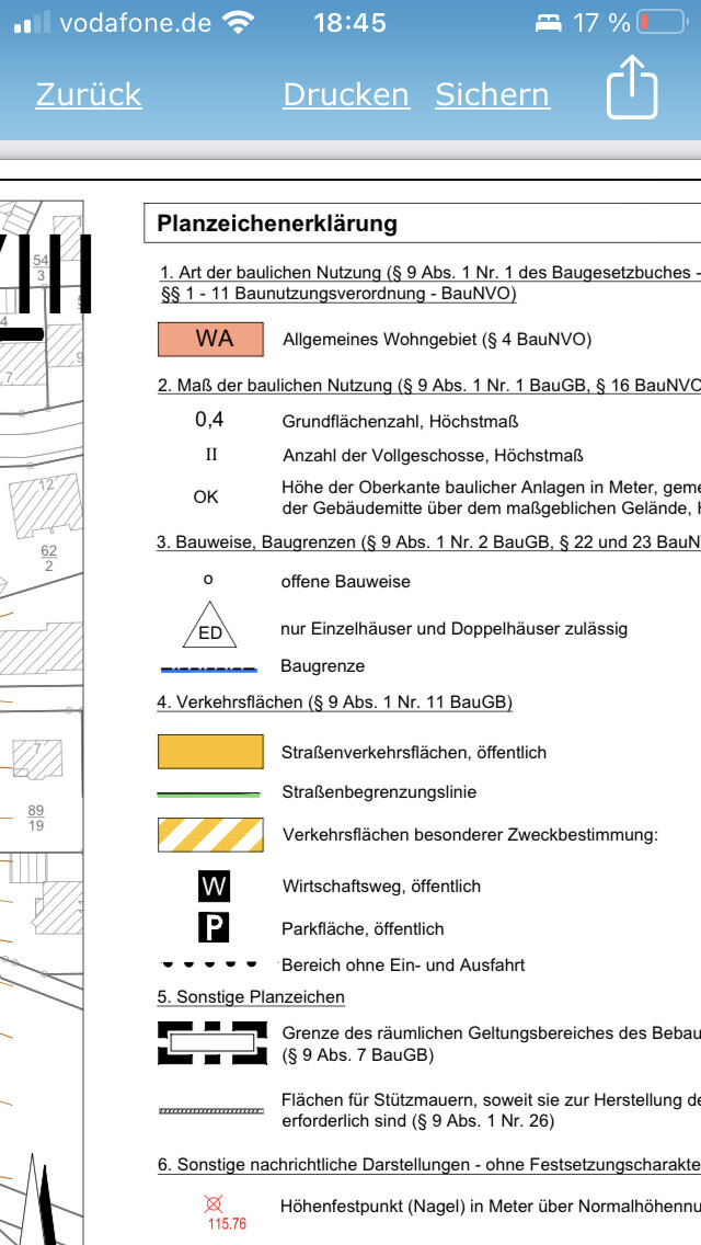

Technical map with orange zones, contour lines, residential area circles, and overlay symbols.
Map legend: Explanation of building and traffic areas (residential area, public green space, road).
