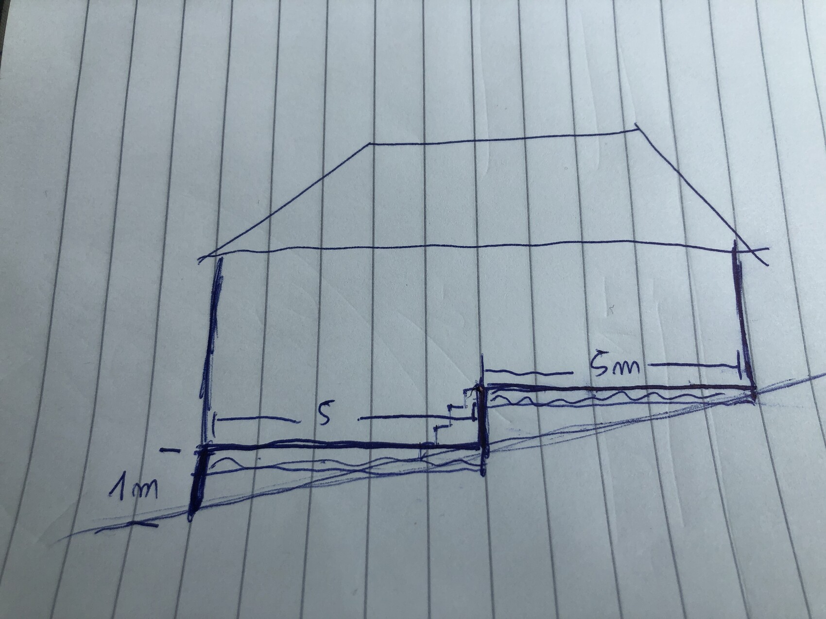

How many meters of height difference can generally be achieved without major issues using two staggered floor slabs? If I assume a 20% slope, the land drops by 1 meter every 5 meters. So, could I create the foundation slab split in half with a 1 m height difference, then build up the lower level by 1 m, and place a standard bungalow on top? The lower level would then have a ceiling height that is 1 m higher. Would this be practical?
Sorry, this sketch was just made on the train.

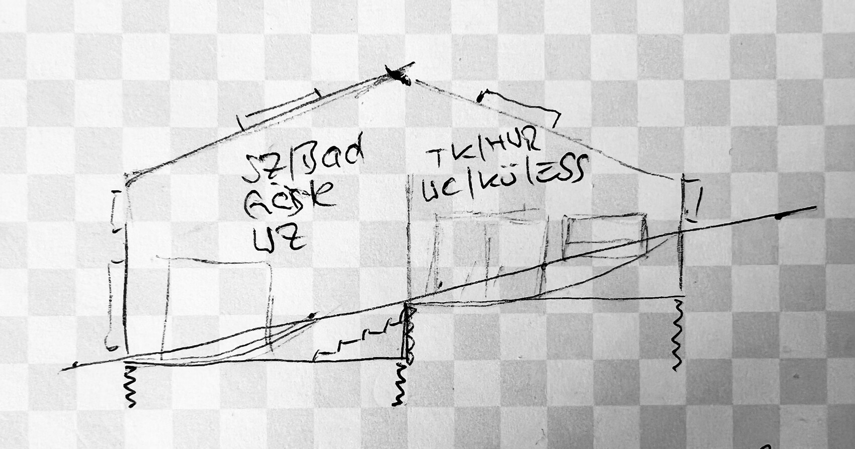

OR, as others suggest, a split-level house where the required rooms are at street level, but the guest room and the utility/laundry room could certainly be on the lower level. That’s my view. Although I have said and explained that the utility room is used about 10 times a day, whereas the bedroom might only be used 1-2 times a day.
I thought we had agreed by now that a partial basement would only be sufficient for utility space (?), I find split-level unsuitable since the goal is clearly an accessible residence suitable for wheelchair users; also, split-level makes no sense if the ground on the building footprint differs in height by a full story. No, you are convinced.
The current design, and I assume the revised one as well, is not what you want or what will work (sorry to say, but I can tell from plans whether something is just an idea or a well-developed concept with potential).
The land and your requirements have been calling out for a professional for days. Anything else is a waste of time. The theoretical questions keep repeating as well.
Edit: with split level, the front part of the building would be buried about 50-100cm (20-40 inches) on the south side… first I would design the platform for parking..

So, could I now create the foundation slab split with a 1 m (3.3 ft) height difference, build up the lower level by 1 m (3.3 ft), and then place a standard bungalow on top? The lower level would then simply have a 1 m (3.3 ft) higher ceiling height. Would that be practical? That would just turn the nonsense of building a hillside house not on a basement but on a 2 m (6.6 ft) high concrete block ring into a “same thing, just in two steps” version. No, it’s not really sensible, but maybe amusing. Instead of having more ceiling height in the lower part, I would rather go back to the shed roof idea.

Ultimately, if really necessary later, one could also install a stairlift for the small height difference in the split-level area. If you want to avoid a stairlift, you can just build with full-height floors in the usual way. Split-level is not “half multi-storey” by concept, because there is no such thing as “half pregnant.” It is multi-storey; it just varies the floor levels by half a story.
HalloClarissa schrieb:
a split-level house where the living spaces are on street level, but the guest room and utility/mudroom could be on the lower level. The basic concept of “everyday living on one level, with stairs only for occasional-use rooms” can be implemented either with half-storey offsets or with classic full-storey stacking.
