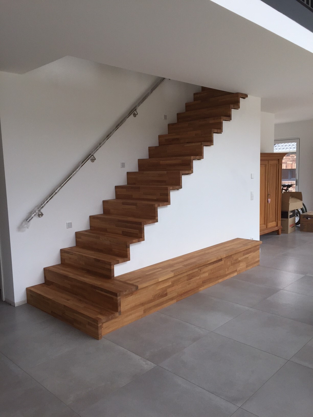

If yes, I can still see the option of installing a new folded-stringer staircase (with treads and risers) on top of the concrete stairs, gradually gaining height and resting on the concrete stair structure (the folded-stringer staircase can also support itself alone if needed, and is generally easier to build than a surface-mounted version). This would cost around 7,000 gross, plus about 1,000 more for extensive painting and filling around the edges.
Here’s how ours looked (at the time, still under construction and without the glass wall):
Of course, it looks a bit odd when the concrete stair is cantilevered, because the wood on top and concrete below visibly don’t rise symmetrically or parallel.
