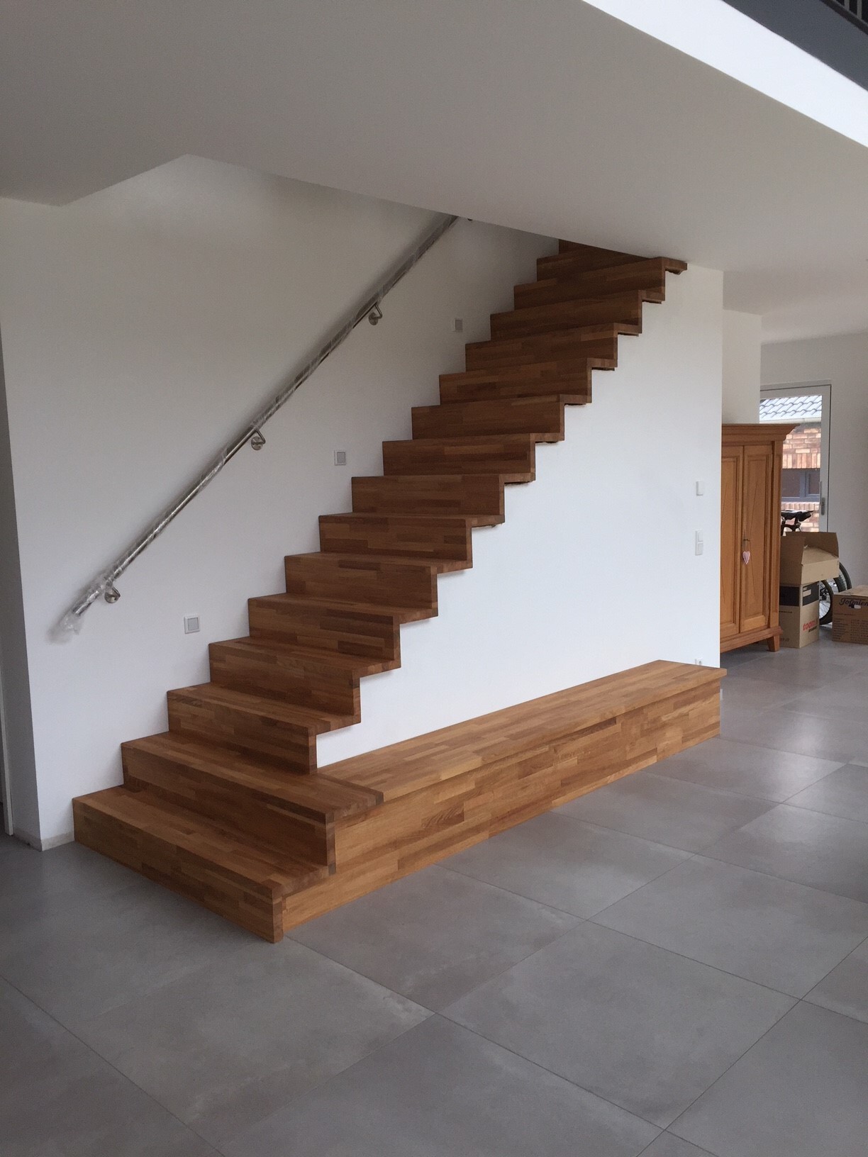

Here is a brief update on our ground floor to first floor staircase, unfortunately only a photo taken with a phone for now.
The 3-part glass enclosure is still missing. Unlike in the photo, the painter has already finely finished the steps.
The staircase is quite steep and has a narrow tread depth, but we are managing well with it.
The steps were adjusted using two thick Spax screws each into the concrete, on which the steps rest on the screw heads. Steps 3 to 8 were glued on site as a single folding element (with lamella connectors under the riser), followed by further elements from the bottom upwards. The staircase was assembled and disassembled about 15 times to ensure everything fit. It was finally glued and fixed (to the concrete) with Ponal static adhesive, solid and firm without any hollow sounds.
In short: labor-intensive—and unfortunately one of the most expensive ways to enhance a new concrete staircase….
Work involved for 2 staircases:
1 day for measuring and planning
3 days for preparation and delivery
2 days installation with 4 people (!) (for 2 staircases)
Half a day for finishing work, oiling, etc.
+ 3 additional painting sessions (filling, painting, wall connection).
+ some sill work by the tiler...
