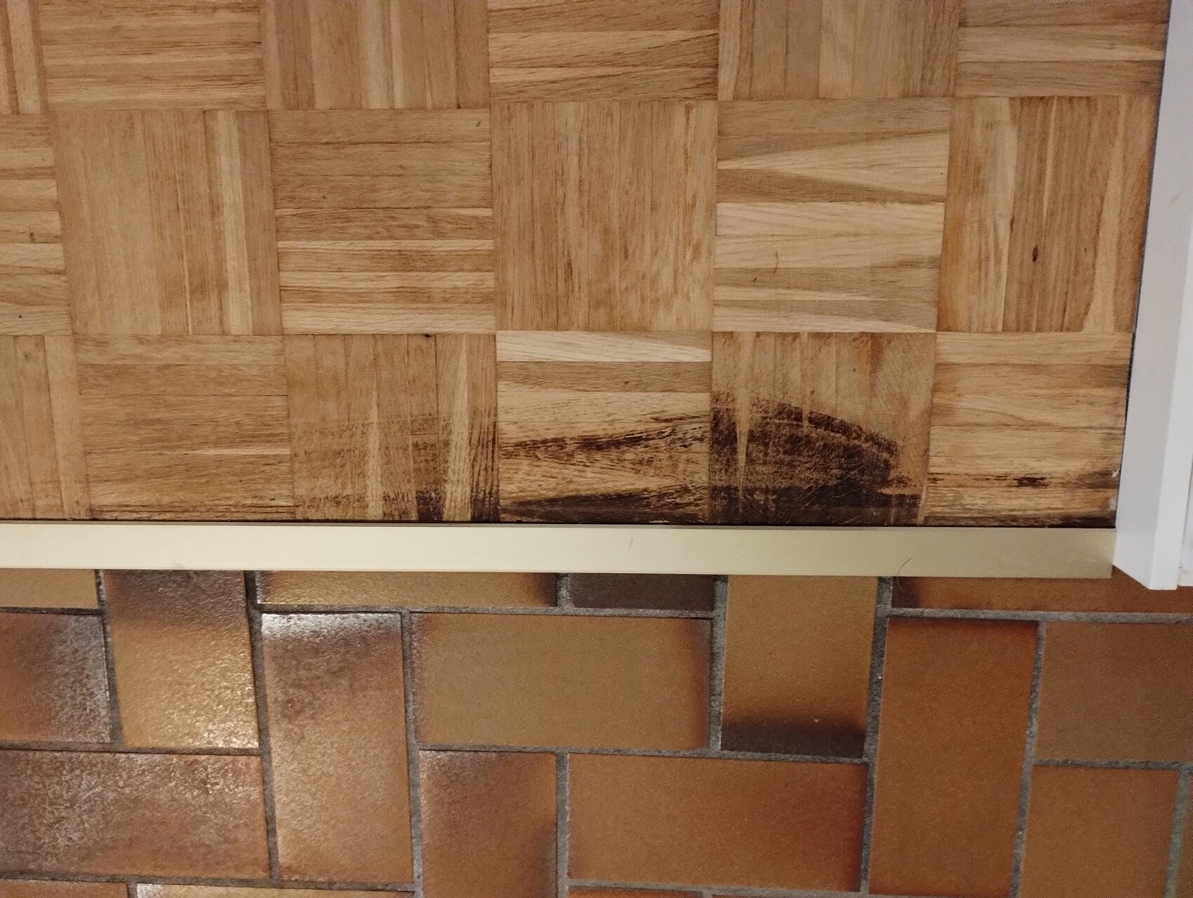

ᐅ Wood Flooring Has Black Stains from Mopping Water – What Can Be Done?
Created on: 30 Jul 2024 19:21
HafenguyM
MachsSelbst30 Jul 2024 20:03What do you use to clean your tiles? Hydrocyanic acid?
chand198630 Jul 2024 21:05Hafenguy schrieb:
The tiles were cleaned with baking soda and all-purpose cleanerWhy use baking soda? The whole point of the all-purpose cleaner is that it is neutral. Baking soda makes it alkaline. Why this mixture?With mildly alkaline cleaning agents on wood, it depends on the surface treatment. If the parquet is oiled and not sealed with varnish, it requires fat-restoring soaps. Your approach does not provide that.
If in doubt, sand down and re-oil.
Bertram10030 Jul 2024 21:15There are cleaning products that remove water stains from wood. The black discoloration is caused by the oxidation of metal traces in the wood. It will disappear over time. Afterwards, re-oil the area if the parquet flooring is oiled.
MachsSelbst30 Jul 2024 22:22Let a professional handle it. The risk of making it worse is high.
