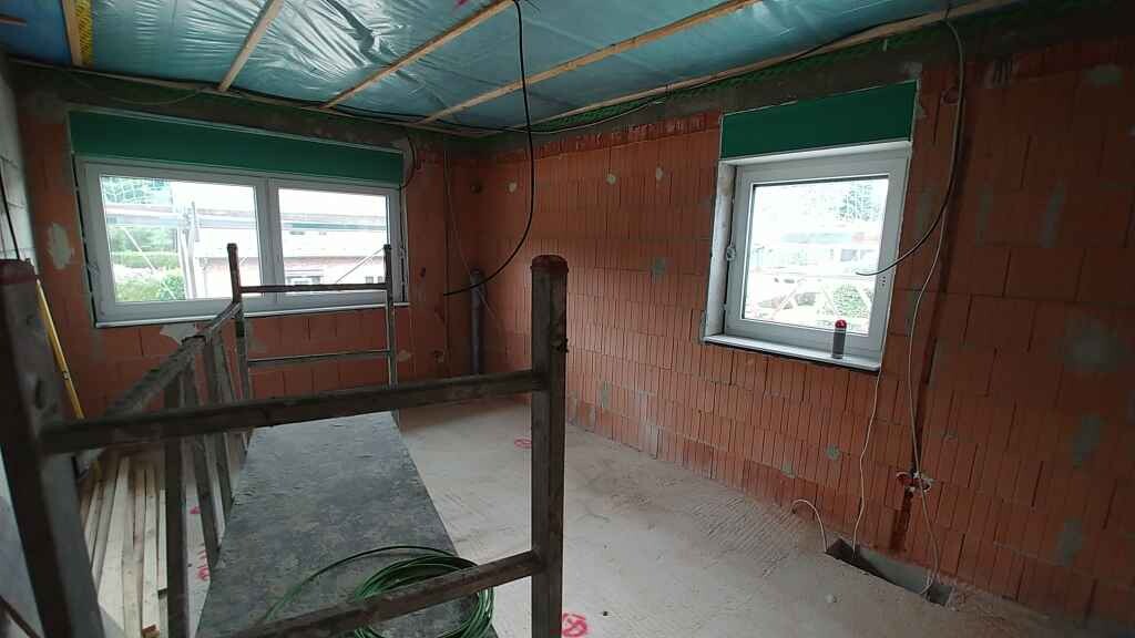

In Child’s Room 1, I find the windows too small for the large space:

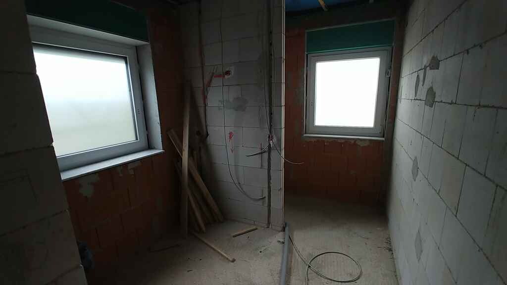

Master bathroom:
The bad part is that at the vanity’s half-wall, where it’s in view, there is now no space left for a shelf. We will probably have to buy a mirrored cabinet or install a shelf. I believe this is also a big problem.

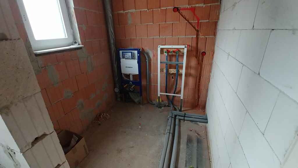

Guest toilet:

Master bathroom:

Guest toilet:
