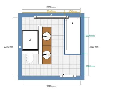

The bathroom seems a bit cramped, and the passage from the sink/bathtub to the shower feels slightly narrow.
Therefore, consider placing the children's room on the left side of the plan, the bedroom at the bottom right, the guest room at the top right, and slightly expanding the bathroom in that direction.

I’ll add to what others have said: juggle several possibilities! However, the waste pipes for the toilets should be aligned vertically, so place the toilet as close as possible to the ground floor toilet.
The hallway to the bedroom is terrible – better to leave it out and use the opportunity to change the bathroom door.

The bathroom actually feels quite tight to me as well. Do you possibly have better ideas to fit everything in?
I would prefer not to swap rooms, since I’d rather have a smaller bathroom than bedrooms that are too small for children.
