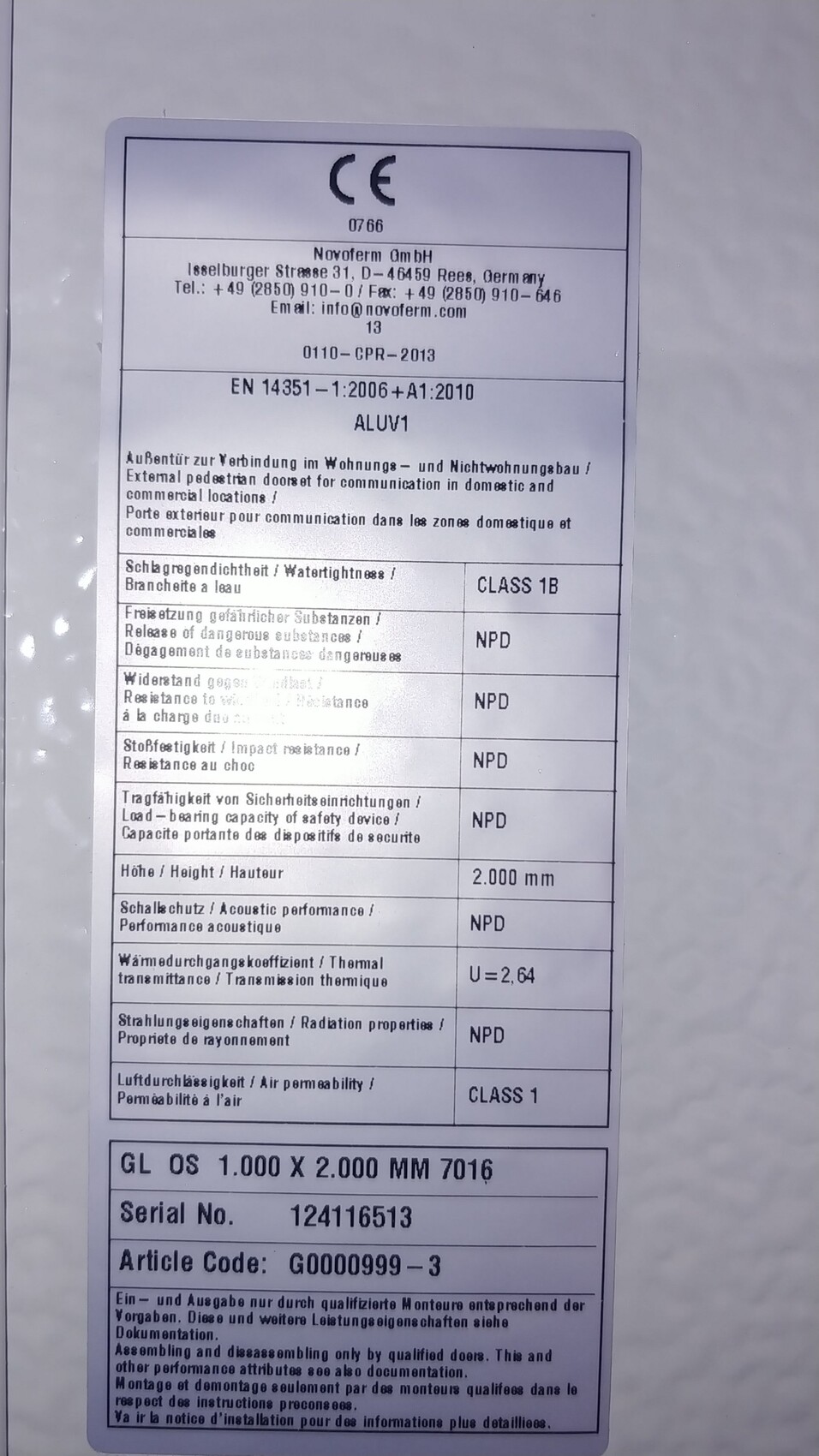

Here is a nameplate from the rear door. It is 2 meters (6 ft 7 in) high... really inconvenient. Accordingly, the gate next to it is also "high."

But two meters (6.6 feet) is completely sufficient, isn’t it? Standard interior doors aren’t any taller either.

Inside, we’ve specifically planned for taller rather than standard interior doors. Whether something is sufficient or not is ultimately decided by the client based on what they request. I definitely don’t find it comfortable to walk under this grid structure at only 1.89 m (6 ft 2 in) height! And I also don’t see any reason to want different door heights at the front and back.

Nice picture (-:
I didn’t really pay attention either, just made sure the cars would fit well at the front...
However, I wasn’t aware until the end that our garage wouldn’t have any screed at all.
hanse987
10 Sep 2018 00:41
What is the slope like in the garage? The floor will slope down toward the main door, right?
Maybe the idea was that with a higher floor at the back, a lower door would be used.
Is there no drawing or plan for this?
