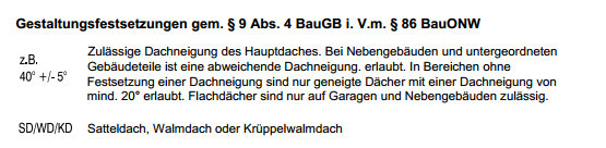

Section of a construction plan showing information about the allowed roof pitch and roof types.

This is the excerpt from the regulation; now you need to check the development plan for your plot number to see which specific roof type is assigned to your property. If all three are listed, that's fine. If only a hip roof (WD) is specified, then the garage may have a hip roof with a different pitch or a flat roof.
I find it attractive when the garage and the house share the same roof style and pitch – but that is a matter of personal preference. In your specific case, I would ask the builder to create a 3-D view for you.
