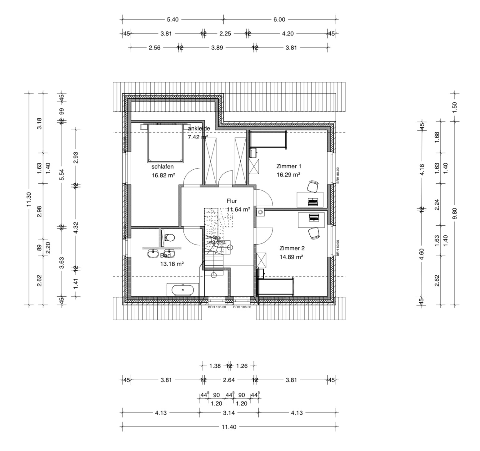

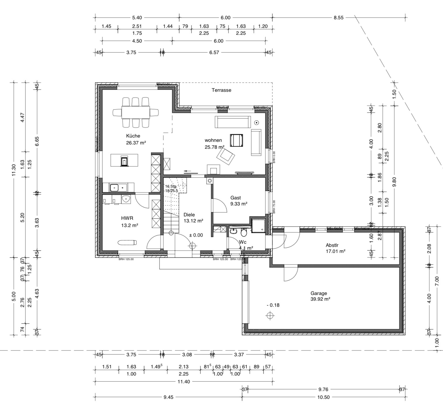

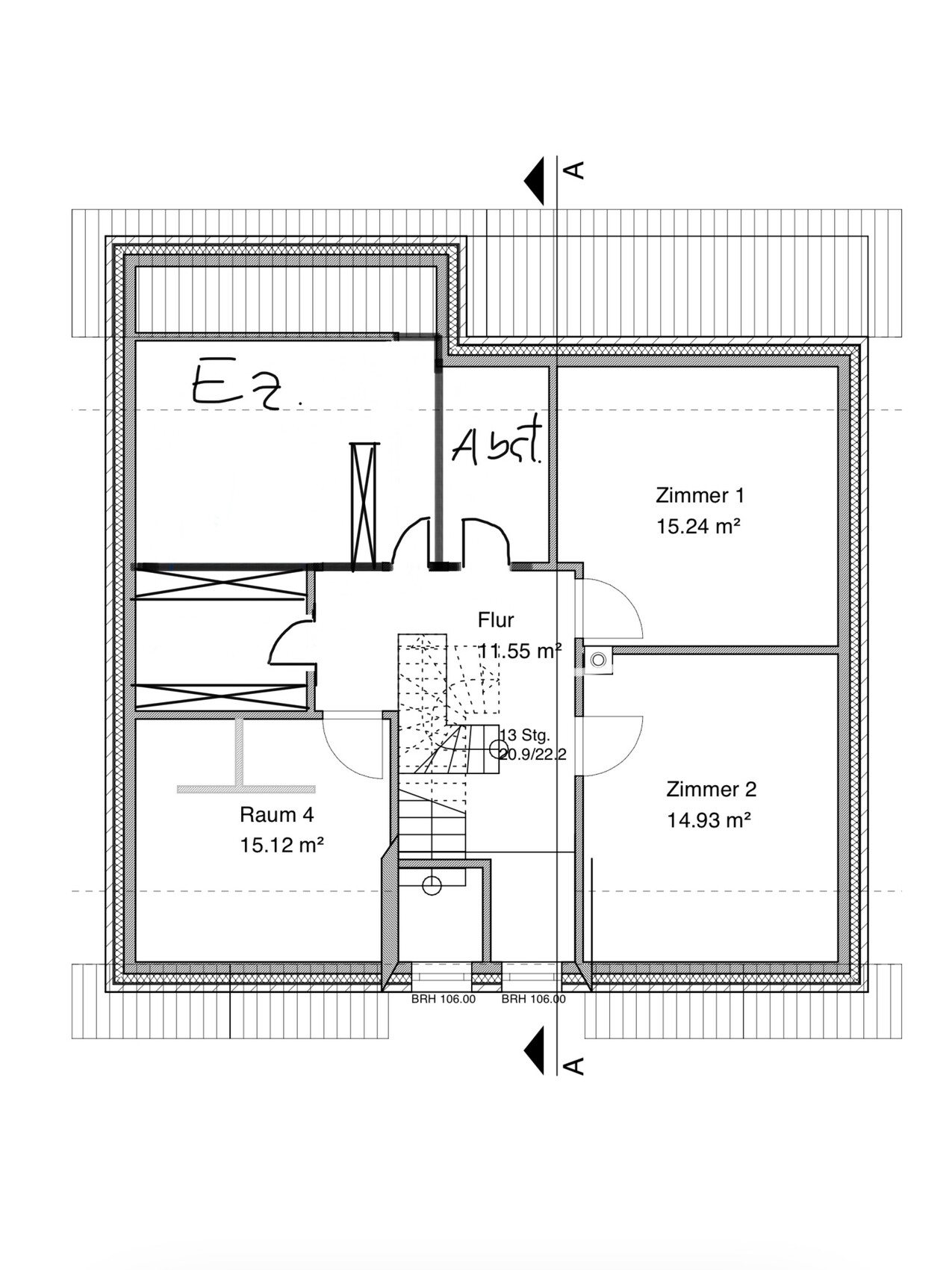

Hello dear house-building forum!
I have already done a lot of reading but still haven't found a suitable solution or optimization for our single-family home. Maybe you can help me further?!

What is the most important/fundamental question about the floor plan summarized in 130 characters?
Can the rooms in the house still be optimized, e.g. on the first floor?
How can I fit a sauna with a small lounge area in the garage without feeling cramped?

wrobel schrieb:
I’m probably just misinterpreting the toilet as a passageway to the garageNo, you’re interpreting that exactly right!
Muc1985 schrieb:
Sorry, either I missed something. Even though this has been discussed many times in the forum, the budget absolutely won't work...What do you mean by that? Set far too low? We still plan to contribute a lot of work ourselves...Similar topics
