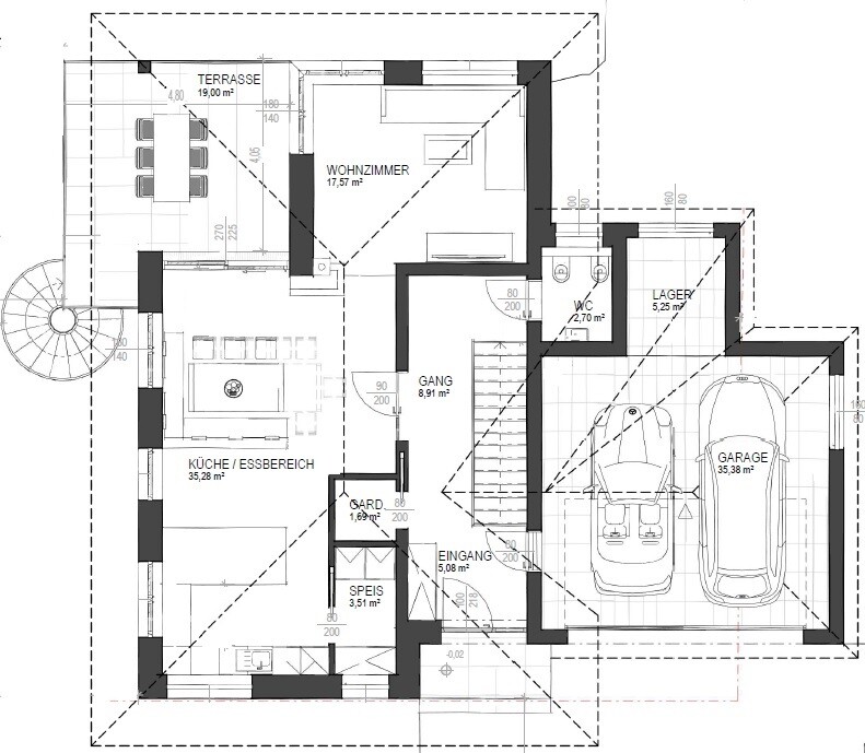

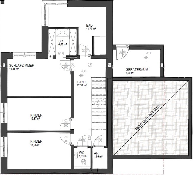

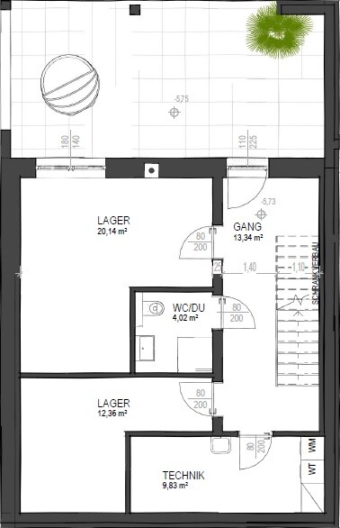

chistarHello,
we are currently planning our single-family house.
Due to the sloped site, it will have a ground floor, basement, and lower ground floor.
Because of the view, we decided to place the living area on the top floor.
Key data and our requirements:
- Number of floors: 3 (due to the slope)
- Living area: approximately 140–150 m² (1500–1600 sq ft)
- Roof style: must suit the house (flat or shed roof not allowed as per building permit / planning permission)
- 2 children’s bedrooms
- Living area on the top floor
- Provision for a fireplace
- Separate toilet
- Terrace on the upper floor
- Double garage
Open issues:
- Final room layout
- Window arrangement

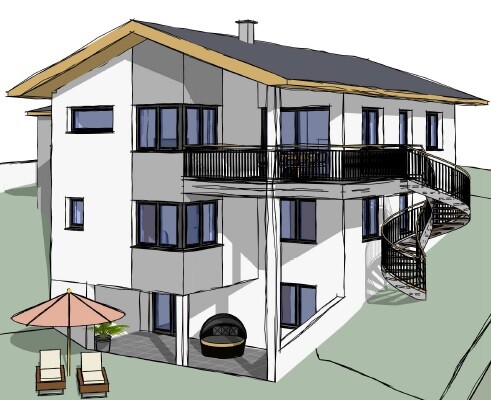

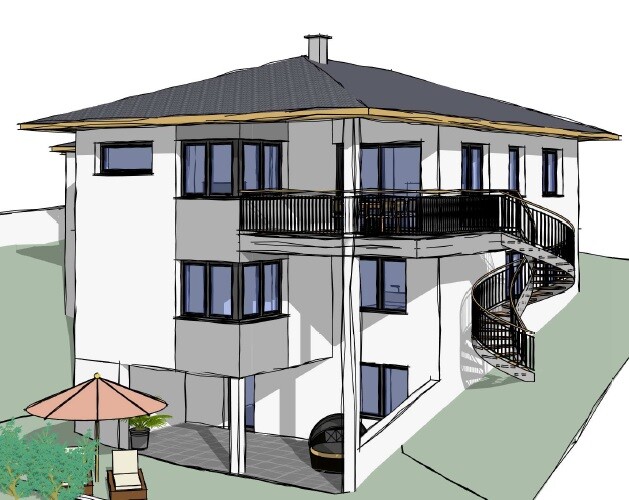

- Roof style (attached are two proposals)
- Wall construction
- Facade design
We would be very grateful for opinions and suggestions!

Personally, I don’t like either option. Somehow, nothing really fits together. Above all, you need a large budget for this kind of design. Nothing is standard anymore, and special structural solutions are certainly required. The fact that the garage isn’t built on a basement is nice and all, but you still have to construct foundations and fill in. Overall, in my opinion, the floor plan is also missing a few square meters to properly divide it across three floors.

Why didn’t you include terraces with the house like @sichtbeton82 or @Mellina?
Of course, a flat roof isn’t possible and you are building smaller, but somehow it doesn’t appeal to me at all. Also, that the basement is really just expensive storage space—the room has garden access.

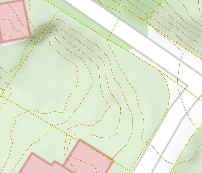

Plot size 700m² (7,535 ft²)
Slope yes
Building envelope, building line, and boundary: 5m (16 ft), except for outbuildings (garage)
Number of parking spaces 2
Number of storeys
Roof type no flat or shed roof
Style no specification
Orientation no specification
Maximum height / limits Absolute height specified → only 1 storey above street level allowed
Additional requirements Roof pitch 15-35°
Access only allowed from the east (see attachment, north-oriented image)

Complicated plot: slopes down on three sides, distances to neighbors, street (see attachment, north-oriented image)

Front part of basement possibly to be developed later

Stefan2.8412 Nov 2020 15:48If possible, enlarge or widen the garage. It looks like it is 6 x 6 meters (20 x 20 feet). I have two future neighbors who are quite dissatisfied with a 6 x 6 meter (20 x 20 feet) garage. They would definitely make it wider.
