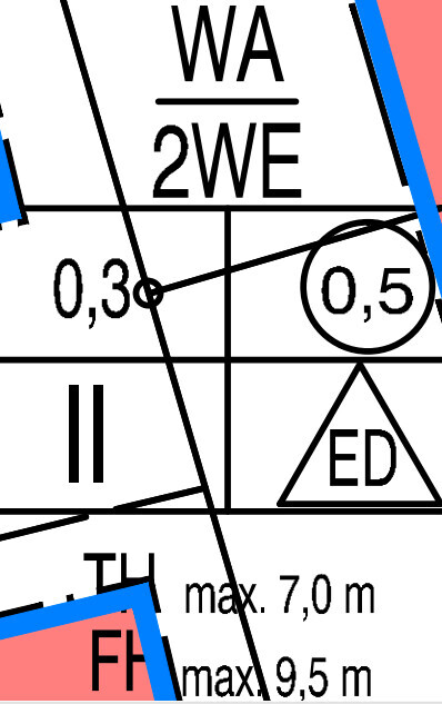

I’m a bit unsure and puzzled about how to design the garage.
I’m interested in whether my idea is even feasible.

Bauexperte5 Nov 2014 10:59Hello,
Based on the information you provided, you are free to choose the roof style for your garage; of course, any roof overhangs must be included in the calculation.
In the end, your budget will decide, since a garage with a saddle roof, hip roof, or probably a half-hip roof is more expensive to build than a garage with a flat roof.
What does your planner say about the property requirements, zoning plan, or textual regulations?
Regards, Bauexperte

According to what you posted, you are free to choose the roof design for your garage; of course, any roof overhangs must be included in the calculation.Do roof overhangs generally count towards the floor area or the individual dimensions?
For example: Garage length x width 7 x 8 m (23 x 26 ft) = OK, overhang 0.5 x 1.0 m (20 x 39 inches) = total garage size 7.5 x 9.0 m (25 x 30 ft) => not allowed to build.

What does your planner say about the plot requirements, zoning plan or textual land-use regulations? What do you mean?
Bauexperte5 Nov 2014 11:22Hello,
You can assume that "building beyond the property boundary is generally not permitted because it affects neighboring properties." This means if you decide to have a roof overhang on the garage, the length of the overhang must remain within the boundary line. There are very few exceptions, which are described in the written regulations of the zoning plan (for example, in the direction of the sidewalk).
No, not really. When looking at cost increases, the shed roof (FD) is the most cost-effective, followed by the gable roof (SD) and the hip roof (WD), with the half-hip roof being the most expensive.
Usually, homebuilders choose an architect or a trusted supplier who explains the specific building regulations as well as the financial aspects.
Regards, Bauexperte

You can assume that “building beyond your own property boundary is generally not allowed because it would affect the neighboring properties.” This means that if you decide on an eave overhang on the garage, you must keep the length of the overhang away from the boundary. There are very few exceptions, which are described in the written regulations of the zoning plan (for example, towards the sidewalk).…I never said I wanted to build onto the neighbor’s property.. 😉
The question was only whether the roof overhang counts towards the garage footprint?
Bauexperte schrieb:
No, not really. Considering cost increases, a flat roof is the cheapest, followed by a saddle roof and then a hip roof, with a half-hip roof being the most expensive.Okay, thanks.
Bauexperte schrieb:
Usually, homebuilders choose an architect or a trusted service provider who explains the building requirements to them; including the financial aspects 😉That makes sense, but we just wanted to check whether the plot suits us before going deeper.Best regards

Of course, you must not build roof surfaces extending over the neighbor’s property. The issue of boundary building applies to all plots.
However, you should plan the house according to the plot, not the other way around—unless you have an abundance of building land?
