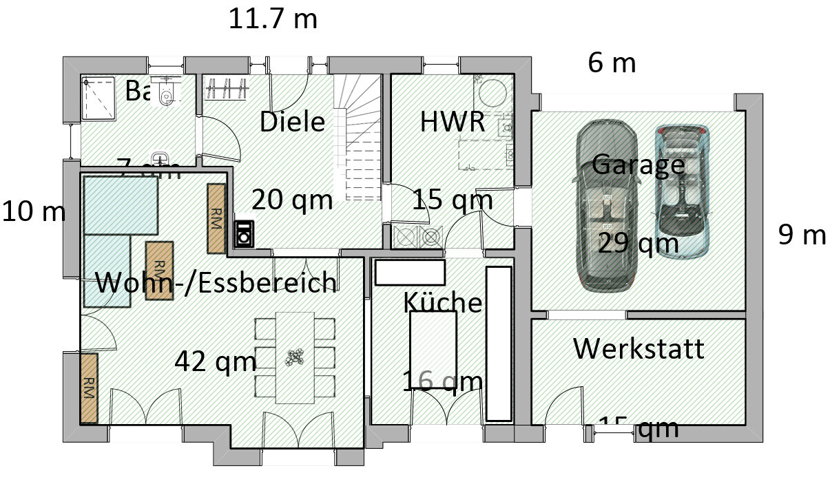

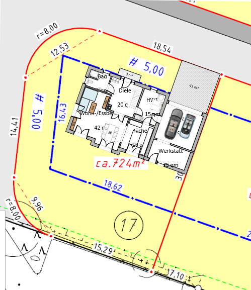

The photo of the plot is oriented north, right? Then I think the house orientation is almost as good as it can be. The sun is in the south around 12 or 1 o’clock and then shines almost directly into the windows, so you also get sunlight in the morning. With windows on two sides, the sun will also shine inside until the evening. I don’t quite understand the problem 😉
From the sunny side, I don’t see any problems.
What immediately catches my attention are the three doors in the utility room. This reduces its usable floor space by several square meters and it seems intended as a passage to the hallway? Experienced readers will know my opinion on using the utility room as a foyer for homeowners or delivery entrance.
Also, 20 square meters for a hallway is quite generous, especially since it is not meant to be used as an entrance.
The cloakroom area will likely not be sufficient either.
I would be interested to know the length of the shorter living room wall. It might be worth considering swapping the kitchen and living room. A missing window won’t be an issue in the living room.
You could also think about moving the house further south – after all, a courtyard with a depth of 6 to 7 meters (20 to 23 feet) is not to be underestimated. The plot is large enough.
Five meters (16 feet) seems too small to me anyway. You can park a car comfortably in front of the garage, but there is hardly any room to walk around it, considering how long cars are nowadays. This also applies to the garage itself. It won’t work the way you imagine.

Unfortunately, the hallway is quite large but still offers little space for your wardrobe. For the utility room, I would suggest installing the door to the kitchen as a sliding door.
I would definitely enlarge the driveway in front of the garage to at least 6m (20 feet). Otherwise, either the rear end of the car will be sticking out onto the street, or the bumper will be blocking the garage door 😉

Obstlerbaum11 Mar 2019 14:24The hallway on the ground floor wastes too much space, and in my opinion, the guest bathroom is unnecessarily large. The chimney flue is a bit of an issue, as it always seems to get in the way. Otherwise, I wouldn’t change anything regarding the orientation and position within the building plot. The garage’s distance from the street should be fine – it should be about 6m (20 feet).

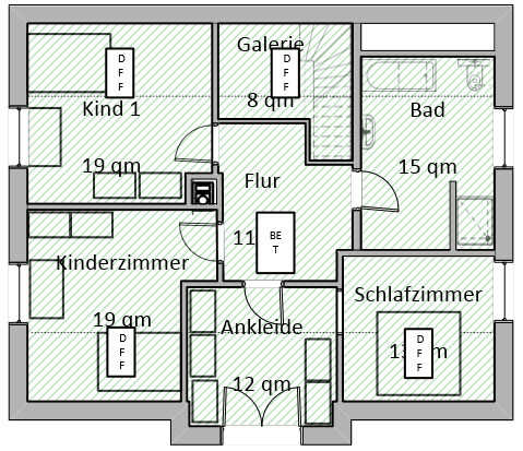

hampshire11 Mar 2019 14:26I find the design and layout quite coherent overall. Many details can only be properly assessed with knowledge of the daily habits, while others are a matter of personal taste. I believe the house will work well in practice if you are disciplined about managing jackets and shoes in the entrance area.

- generous children’s rooms
- separation between the master bedroom and children’s rooms through the walk-in closet
- entry from the garage into the house
- workshop at the end of the garage
- one family bathroom upstairs instead of several smaller ones
- enough space in the living/dining room to turn the dining table sideways when there are many people
- limited space and light in the kitchen
- too much circulation area (entrance hall, corridor)
