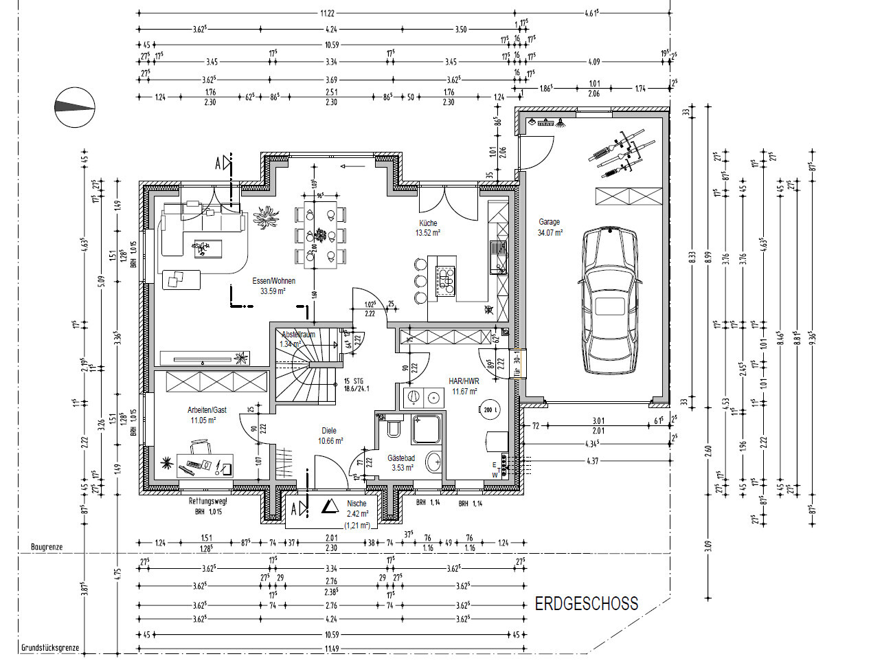

URGENT!!! First, just relax
The silly thread title alone wouldn’t have been a reason to delete and repost the thread while I was already replying :-(
The dressing room door still needs to be moved away from the edge of the first step, otherwise I don’t see anything that needs to be changed. Is the BMW to scale? (If it’s a 3 Series, probably yes, then everything fits).

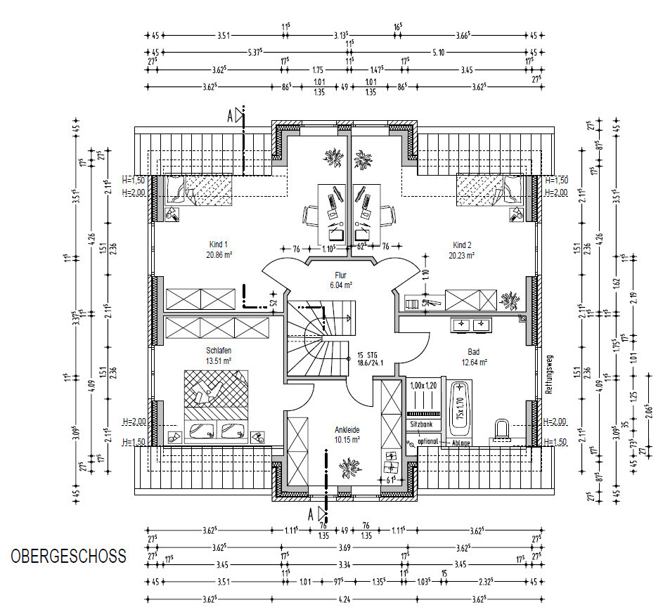

pagoni202010 Jul 2020 19:51I also think this is a floor plan that feels right at first glance.
Often, the "new standard" of having a separate bathroom for the kids creates space issues on the upper floor. Very spacious kids’ rooms, a large bathroom where you might want to make some adjustments depending on your taste, and the guest/office/shower/WC area is basically handled in the entrance zone. It works!
The sofa might be located a bit far from the TV, or the space in between could feel somewhat empty, but you probably have an idea for that. Maybe add some more windows on the south side of the living room, since there’s no natural light coming from the hallway and the kitchen side facing the garage is closed off.
Yes… it all looks coherent!
The floor plan is very good, but what bothers me is the north arrow. If it pointed downwards, everything would be easy, but as it is, one children's room faces south, the other north, the bedroom faces south without morning sun, and the kitchen is far from the terrace. The floor plan is great if the top faces south.
what bothers me is the north arrow. If it pointed down, everything would be easy, but as it is,
one child's room faces south, the other north,
the master bedroom faces south without morning sun, the kitchen is far from the terrace, and so on.
The floor plan is great if the top is south. Hehe, that could be fixed quickly, with a magnet or an eraser.
In my case, it was also the living room, where I thought that side needed more glass or an exit, also because of the south side and the furniture layout.
Now that you mention it, I would also swap the bedroom and bathroom because of heat in the bedroom. I find sleeping on the north side nicer.
But the kitchen has a large door, and the terrace could be extended around the house or divided.
