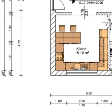

Floor plan attached.

I have a question about the kitchen. How large should an island be, and how much space should there be between the island and the cabinets? Our kitchen measures 3.95 m by 3.80 m (13 feet by 12.5 feet). We plan to extend the cabinetry along the left side (no seating area) and are considering adding an island. Assuming the cabinets on both sides are 60 cm (24 inches) deep, there will be about 2.60 m (8.5 feet) of space between them. I was thinking of an island about 1 m (39 inches) wide and approximately 1.60 to 1.80 m (63 to 71 inches) long. This would leave around 80 cm (31 inches) of clearance between the island and the cabinets. Is that enough?
80 cm (31.5 inches) is quite narrow but still feasible if you only need a walkway. However, the problem could be that when the dishwasher door is open, the passage is blocked. I would think this over carefully and probably opt for a 90 cm (35.4 inches) island if it really has to be that way. It’s best to check this out in a kitchen showroom.
It might be more practical to choose an L-shaped layout plus an island, which can also be made deeper. That way, it compensates for some of the base cabinets in a U-shape.

80 cm (31.5 inches) is quite tight but still manageable if you only want to walk through. The problem, however, could be that when the dishwasher door is open, the passage is blocked. So I would think this through carefully and probably go for a 90 cm (35.5 inches) island if it really has to be. It’s best to take a look at this in a kitchen showroom.
It probably makes more sense to plan an L-shaped kitchen plus an island, which can also be deeper. This will compensate for some of the base cabinets in a U-shaped kitchen. We are still in the planning phase :-) We can also imagine a U-shaped kitchen with a small table for four people in the middle.
Tom1978 schrieb:
A small (4-person) table in the middle In the middle of the kitchen? Never. It doesn’t fit. Besides, it would be right in the shortest path between one kitchen cabinet and the other.
Man, it’s really frustrating when you want to change the plan now and the space gets really tight – I remember so many people advised you otherwise…
I think 80cm (31.5 inches) is too little when it comes to kitchen and cabinets. The doors will be quite bulky and it will feel cramped.
With a table, it would be similar or even tighter because someone will be sitting there. Then there’s really no space left.
I can’t fully picture your room dimensions, but keep in mind those are rough structural dimensions. You’ll lose a few centimeters (inches) later on.
Also, kitchen cabinets don’t usually align perfectly flush with the wall. For a closed, not too large kitchen, 90cm (35.5 inches) depth is sufficient. Otherwise, it becomes too bulky. Surely you have already calculated your necessary running meters and cabinet area – maybe you can manage with an L-shape? Or use the room “across” differently? …move the door to the pantry… However, you should also note that U-shaped or galley kitchens with a central island can work against ergonomics, unless everything is on one side. You’ll have to walk around a table too.

That will leave about 80cm (31.5 inches) clearance around the island. Is that enough?
Tom1978 schrieb:
We’re still exploring options 🙂 We can also imagine a U-shaped kitchen with a small table for four in the middle.
Man, it’s really frustrating when you want to change your plans now and space becomes really tight—I remember so many people advising you otherwise…
I think 80cm (31.5 inches) is too narrow when it comes to the kitchen and cabinets. The cabinet doors will be quite bulky, and it will feel cramped.
It would be similar with a table, even tighter, since someone will be sitting there. Then there’s basically no room left.
I can’t quite picture your room dimensions, but remember these are raw construction measurements. A few centimeters will be lost later on.
Also, kitchen cabinets don’t necessarily sit flush against the wall. For a closed, moderately sized kitchen, a depth of 90cm (35.5 inches) should be sufficient. Otherwise, it gets too bulky. Surely you’ve already calculated the necessary linear meters of cabinets and storage space—maybe an L-shaped layout would work? Or consider orienting the room the other way? …shift the door to the pantry… however, you should keep in mind that U-shape or two-row kitchens with a central island can be less ergonomic unless everything is on one side. You’d also have to walk around a table. It may be true that many want a larger kitchen, but we are not among them. 15 square meters (raw construction size, yes) is completely sufficient; for us, it’s even very large. Now it’s about making the best out of it.
The floor plan is fixed. We don’t want to wait another 9 months.
