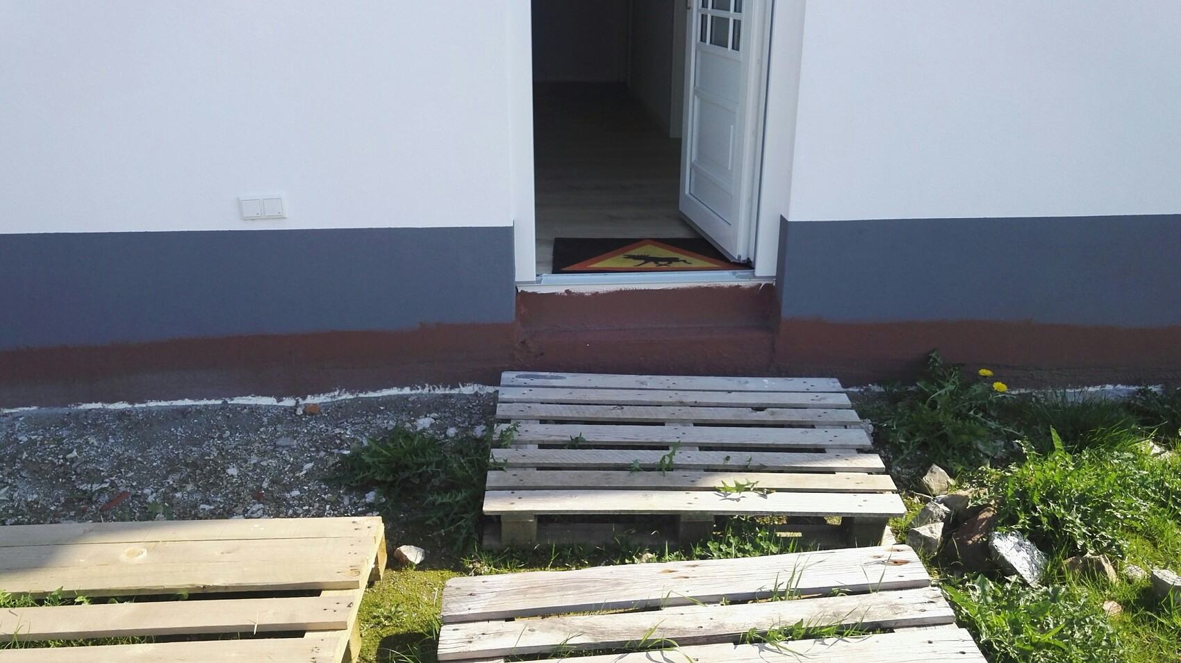

here is a picture as well.
hampshire9 Apr 2019 09:42Leave a 2cm (1 inch) gap, fill it with gravel, and that’s sufficient.
Mottenhausen9 Apr 2019 10:27From the photo, I would say that the planned surface covering should possibly be installed all the way into the door opening. With paving, this might result in a height that is too high.
