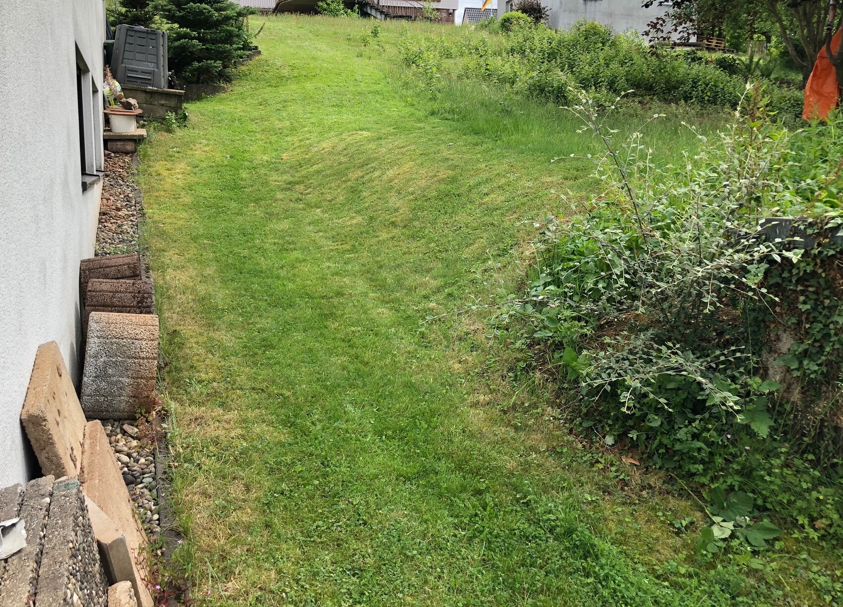

We need to remove a lot of soil from another area of the property and would like to use it to fill in this spot. We are not yet sure how high or how much we will fill; this is still being considered. Depending on how high we build up the ground towards the street, we might need to create 2-3 steps, but we would prefer not to do that since this path is often used to carry heavy items or wheelbarrows, so maybe it’s better to slope it gently instead?

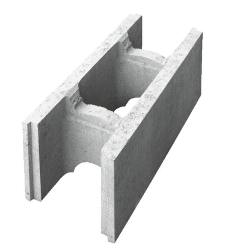

Along the house wall, there is a stone strip. How would you approach this? Would you simply place concrete blocks like in the photo on top of it, to create a gap from the wall?
We want/need to try to keep costs low.
We would really appreciate any tips or ideas.

Gartenfreund17 Jun 2019 06:27I would probably do it like this.
Remove the existing lawn edging.
Fill the area with soil and compact it.
Reinstall the lawn edging.
Fill the area by the house with stones (like it is now) accordingly.
The only potential issue might be the windows, especially the upper one, since the stones already reach up to the windowsill there. If the soil level is raised above the windowsill, the lawn edging won’t work well due to its low height. Alternatively, paving slabs like the ones leaning vertically against the house wall at the bottom of the slope could be used.
These can project out further.
