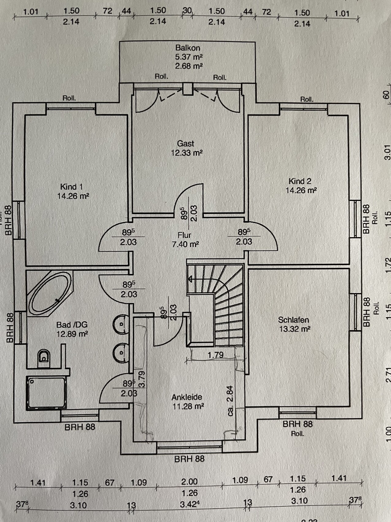

Dear Home Building Forum,
my partner and I strongly disagree about the layout of our walk-in closet. The original floor plan does not include a door to the bathroom. My partner really wants to add an entrance to the bathroom, but I am concerned that this will make it difficult to fit enough wardrobes. What are your opinions? Should we install the door or leave it out?
Best regards, Carolin

26 Mar 2022 07:32
1. A bathroom with two doors is inconvenient because you can't lock it.
2. THIS is a walk-through room and unusable as a dressing room.
K a t j a26 Mar 2022 08:07
You are absolutely right. The second bathroom door is pointless and a waste of space. Don’t listen to your husband! They usually have no idea about clothes and how much space they need. 😉

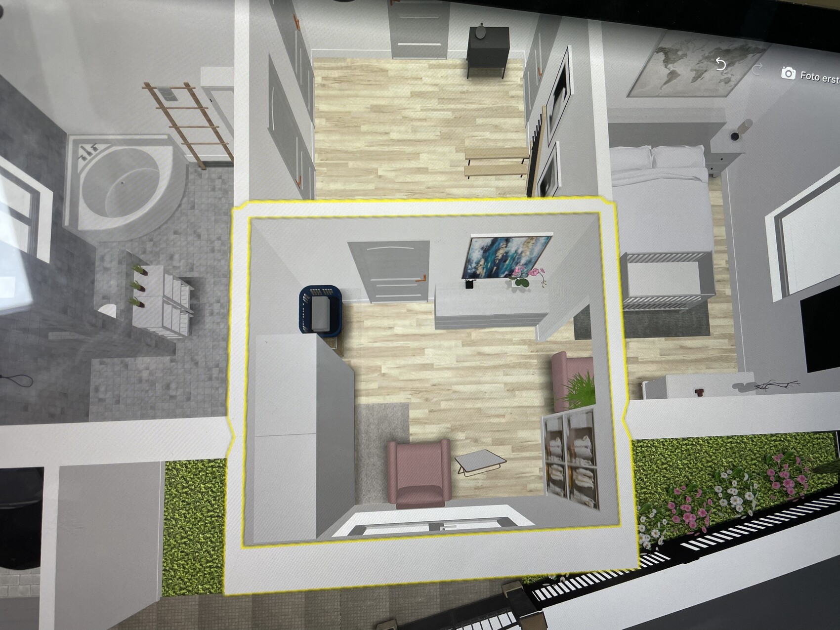

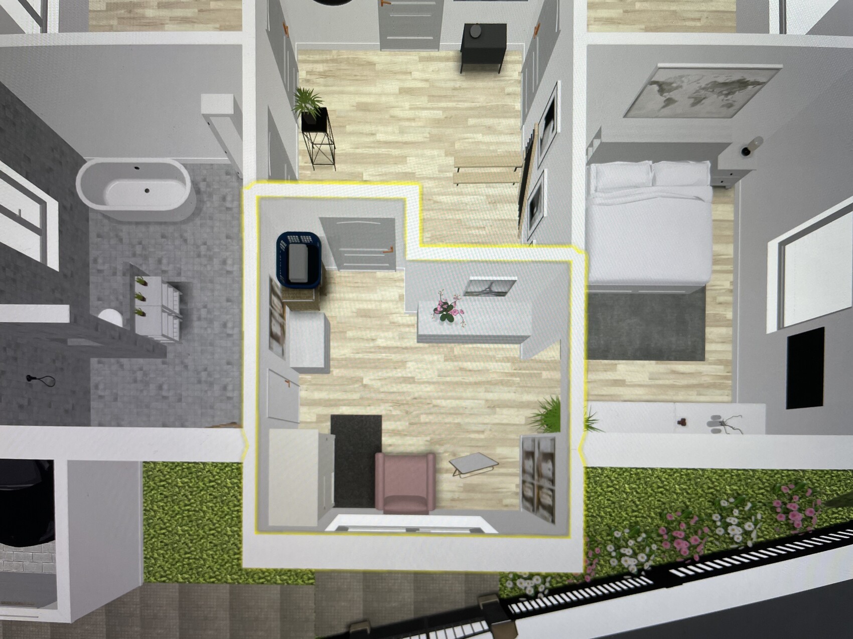

Hello everyone, thank you all for your feedback.
Here is my idea for setting up the walk-in closet without a door. With the door to the bathroom, a wardrobe up to 1.20m (4 feet) wide would fit in the corner at most.
We are also considering moving the wall towards the hallway slightly, as the hallway seems quite large to us. This would also make the walk-in closet a bit bigger.

kbt09
26 Mar 2022 12:45
Is that supposed to be a stairwell?
Broken-up cabinets... is the space sufficient for two people? Seasonal clothing, etc... what about bedding, towels, and so on?
To me, that would be too busy of a passage area.
Myrna_Loy
26 Mar 2022 13:13
It looks like a storage room, which is really a shame given the amount of space.
I would remove the door to the hallway. That way, you would have a long wall for cabinets. Where does the hallway get its light from?
Caro1404
26 Mar 2022 13:30
kbt09 schrieb:
Is that supposed to be a stairwell there?
Broken-up cabinets... Is the space enough for two people? Seasonal clothing, etc... What about bedding, towels, and so on?
To me, that seems like a too busy passage area.
Unfortunately, the design app didn’t represent the staircase correctly. Bedding and towels could be stored in a dresser in the bedroom.
