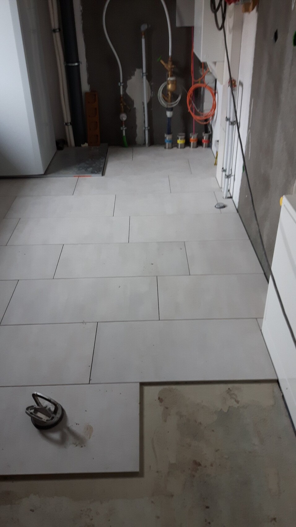

I thought the brine-to-water heat pump was supposed to be installed on the screed and not set up beforehand?In my case, the air source heat pump is placed on a separate pedestal. It was excluded from the screed and installed on insulation. Therefore, the drying program was run using the air source heat pump without the electric heating element and without photovoltaic panels. At that time, the hybrid inverter was not yet installed. That only happened after tiling the utility room. Fortunately, our screed heating program took place in August. The weather was already quite warm outside, so the air source heat pump didn’t need much power.N
Neubau20223 May 2022 15:04We don’t have the brine-water heat pump yet, so we will be using the construction dryer. It will get interesting once the screed is applied. Even now, with the interior plaster dried and the floor being light, the house has suddenly become so bright.
Neubau20223 May 2022 15:17TmMike_2 schrieb:
Make sure to ventilate regularly. When it is warm and dry outside, you can even leave the windows open all day.
Will the utility/technical room be tiled?
If yes, it makes more sense to install the brine-water heat pump later on anyway.Yes, tiles will be laid on the floor. Drying won’t be a problem. I can go over there several times a day after work.
