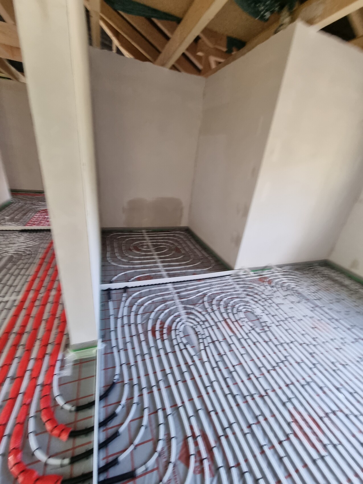

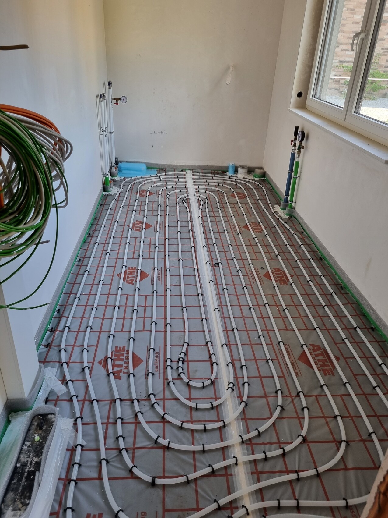

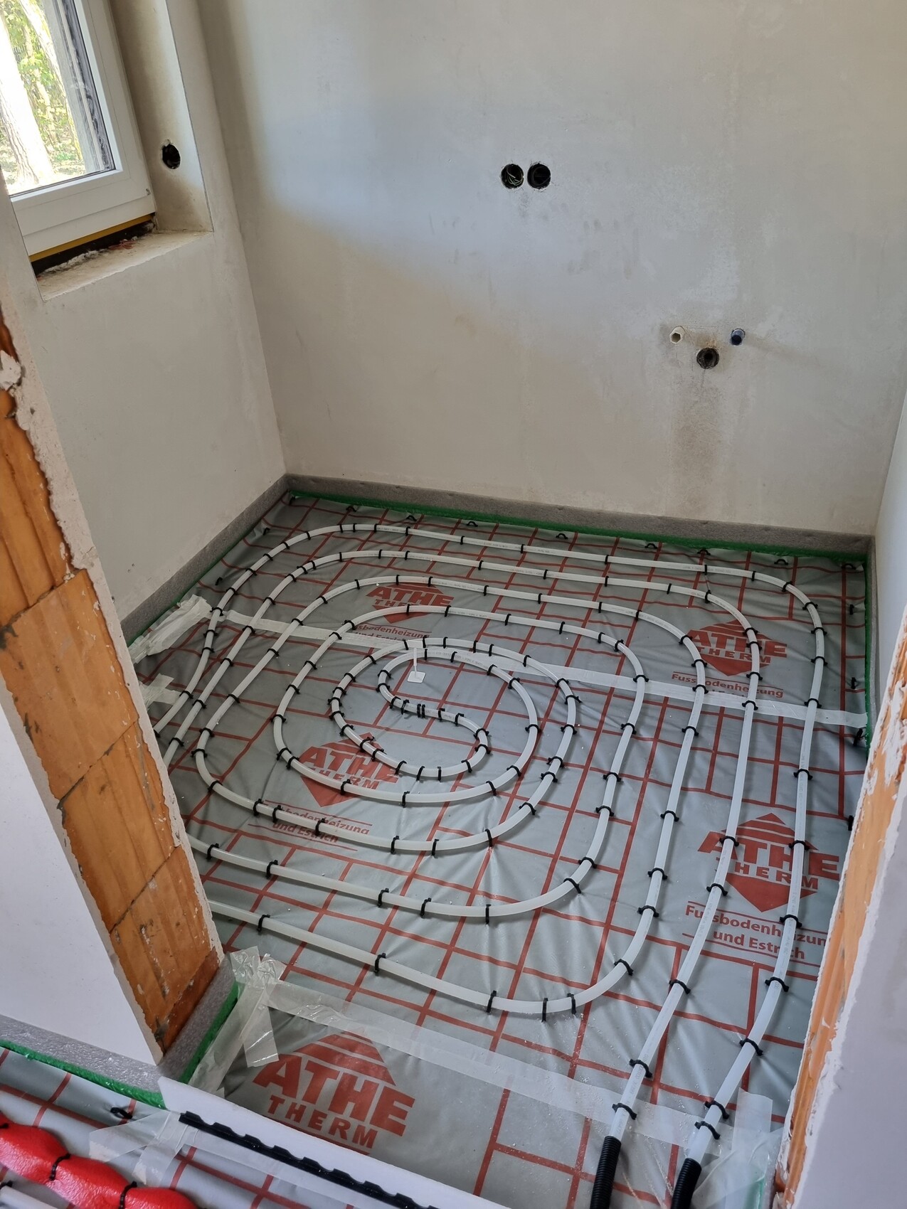

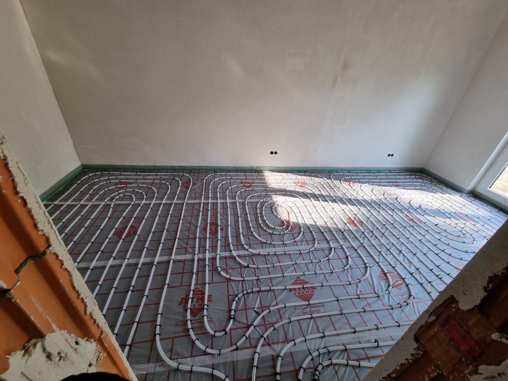

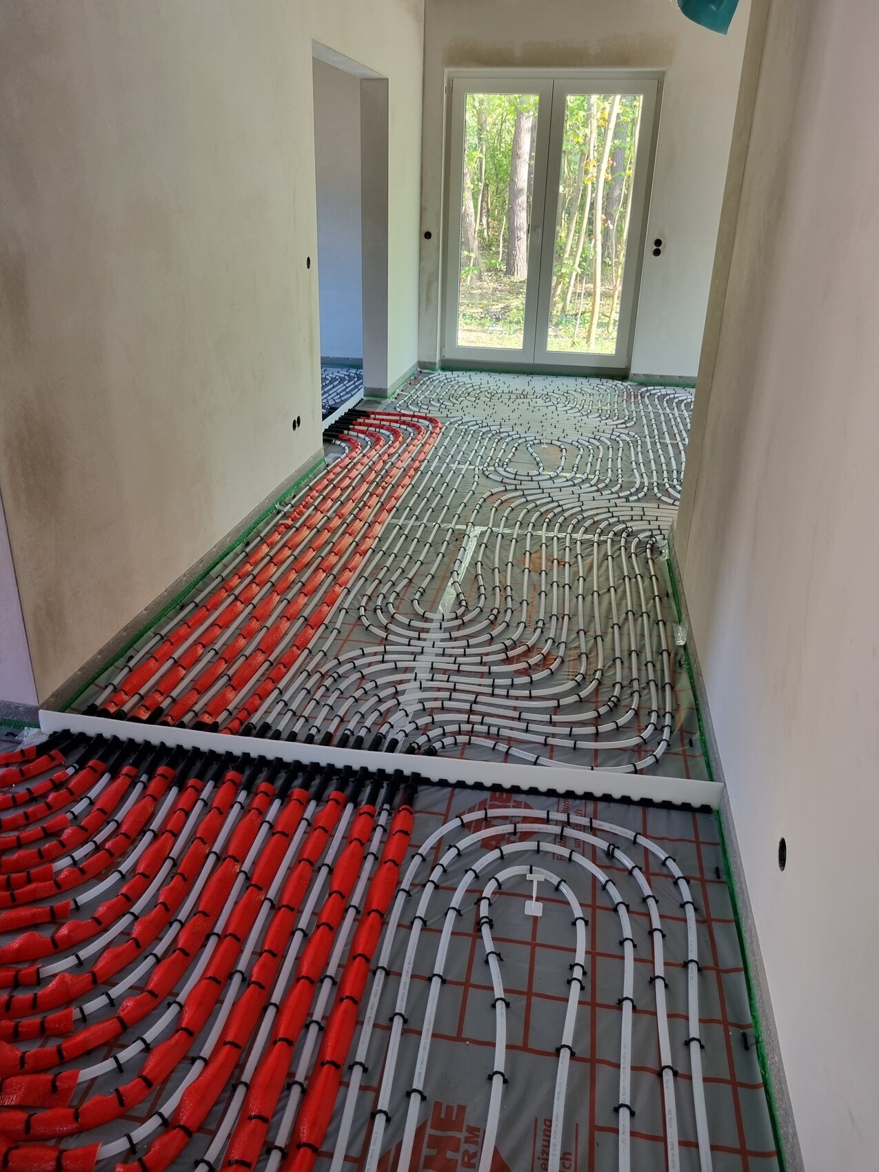

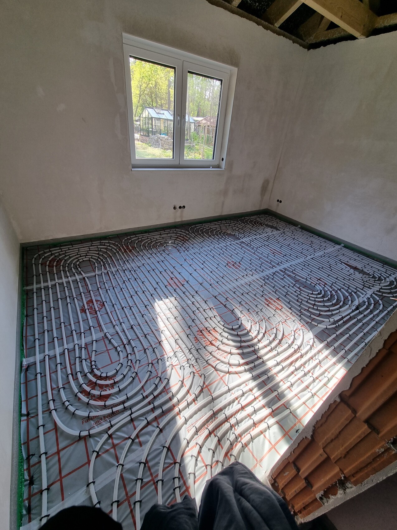

With the installation spacing and desired temperature in reference to KfW55 (20°C (68°F)), the flow temperature will hardly exceed 26°C (79°F). (We are talking here about outside temperature -14°C (7°F), so a rather cold winter) Does this mean that the installation spacing determines the flow temperature? If the installation was done based on that, can nothing be changed in the settings afterward? I still don’t understand the relationship between the flow temperature, the underfloor heating installation, and the heat pump settings.
