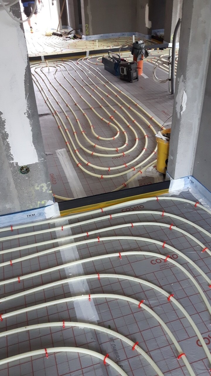

Neubau20223 May 2022 13:43Mahri23 schrieb:
You definitely won’t have to worry about being cold. It looks really good. 😉
How is your mechanical ventilation system with heat recovery coming along? Is it still on schedule?The latest date from the Bosch representative is end of June / beginning of July. Let’s see. By the way, how are the slots for supply and exhaust air installed? In the floor or the ceiling?
Heating program is with continuous flow water heater
Definitely the ceiling, as the floor is too late, and the ceiling has many advantages in a bungalow.
1. Warm exhaust air rises upwards.
2. Fewer issues with the feeling of drafts.
3. Less labor involved.
Neubau2022 schrieb:
The last mentioned date from the Bosch representative is end of June / beginning of July. We’ll see. By the way, how are the “slots” for supply and exhaust air installed? In the floor or ceiling?
Neubau20223 May 2022 14:35TmMike_2 schrieb:
The heating-up program is definitely done with a continuous flow heater.
It should be in the ceiling; for the floor, it’s too late, and a ceiling installation has many advantages for bungalows.
2. Fewer issues with the sensation of drafts.
3. Less labor involved. The screed will be poured on May 13th. Heating will start on May 16th. The briefing for the construction dryer is also on May 16th.
We would prefer if the outlets were in the ceiling 😎 I will ask the heating technician, who also planned the mechanical ventilation system, about this.
Neubau2022 schrieb:
Starting from May 16th, the heating process will begin. The instruction on how to use the construction dryer is scheduled for May 16th.So, still without the heat pump? Have your horizontal ground heat exchangers been installed yet? Will you at least use your photovoltaic system to power the construction dryer then?N
Neubau20223 May 2022 14:49Mahri23 schrieb:
So, still without a heat pump? Have your horizontal ground collectors already been installed? Are you at least using your photovoltaic system to power the construction dryer?The photovoltaic system is not registered yet. Only the panels have been mounted so far. The horizontal ground collectors have not been installed yet, apparently due to significant staffing shortages. I thought the brine-water heat pump would be installed on the screed and that it wouldn’t be installed beforehand?
On a different note: the planned move-in date is mid-July. We have now terminated the apartment lease for August 31. Better to be safe. We can manage one last rent payment of 550 € (about $600). Plus, it gives me more time for renovation work and no moving stress :-)
