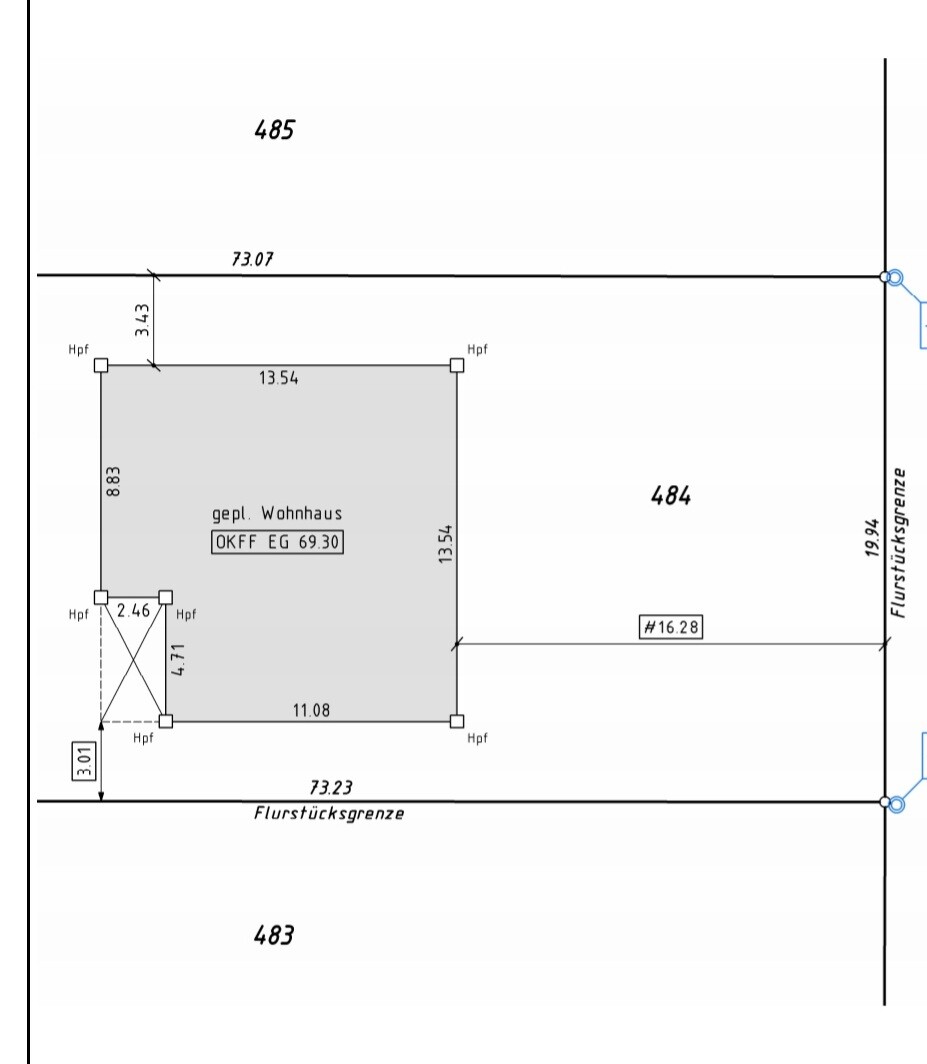

Floor plan attached.

The 16.28m (53.4 feet) mark is the required building line. We wanted to make full use of it to maximize the distance from the street. After subtracting the house, we still have a garden of about 42m by 20m (138 by 66 feet). The setback distances from the property boundaries are 3m (10 feet) each. On the right side, there is already a neighboring building, so we wanted a slightly larger setback there. On the left side, there is a forest.
