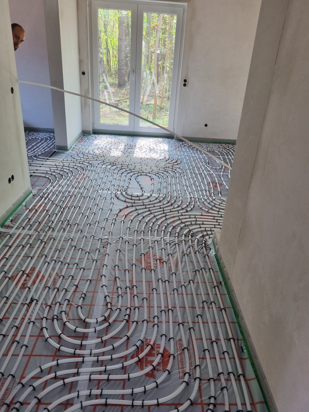

Benutzer 10013 May 2022 08:00Neubau2022 schrieb:
Can I just sit back and drink cheap whiskey with cola? 😎No, you still have responsibilities on your part. :p
Expansion joints, so off to the tile or parquet installer, etc.
Leave space for the fireplace.
At least that was what could be deciphered. The 35° (95°F) setting is only there so you can’t lock it at 30° (86°F) if your electricity usage is too high.
What’s good is that the rooms were calculated with realistic values and the heating circuit lengths were followed.
Heating loops in the shower are great.
Neubau20223 May 2022 08:07Offtopic schrieb:
No, you have responsibilities on the construction side :p
Movement joints, so those go to the tiler/parquet installer, etc.
At least that’s what could be made out. The 35° is just there so you can’t fix it at 30 if your electricity consumption is too high.
What’s good is that the rooms were calculated with realistic values. And the heating circuit lengths were followed.
Heating loops in the shower are great. Everything is already taken care of. The construction company is coordinating everything. Also, tiles will be installed instead of parquet, which they already know. Except for the rooms where vinyl will be installed, that will stay.

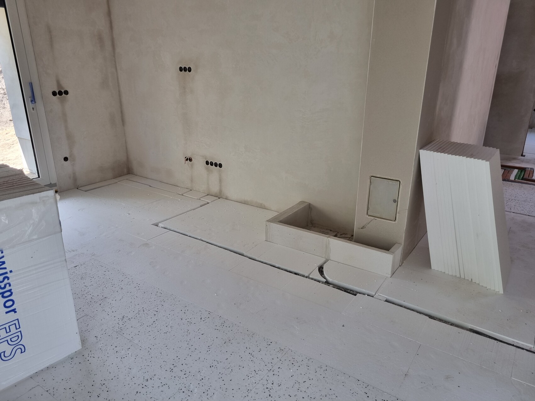

Neubau20223 May 2022 11:37N
Neubau20223 May 2022 12:01TmMike_2 schrieb:
@Neubau2022 I know that feeling. Seeing the progress of physical work is extremely satisfying, isn’t it?Yes. That’s why here are two more photos :-)
