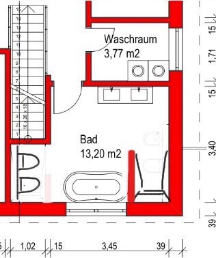

I have a question about our bathroom planning. We want an open shower next to a tiled wall, so no glass or glass door.
The niche behind the stairs (around 175 cm long (69 inches)) initially seemed suitable for this. But now I’m worried that the wall might be too short and splashing water will end up in the bathroom. I guess the wall shouldn’t be longer than about 1 m (39 inches) to still allow comfortable passage?
What do you think? Alternatively, the shower could be placed on the exterior wall. The knee wall height is 2 m (79 inches). Does that make sense?
Thanks and best regards
PS: I just quickly edited the second picture on my iPad... Not exactly perfect

Definitely the first option. Our shower is about the same size as yours (1.80m long (5 ft 11 in)) with the opening on the side as well. We even hang towels inside the shower, and they never get wet. The floor outside the shower opening also stays mostly dry.
Open showers without doors that face forward are much more prone to flooding the bathroom. In that case, the shower screen should be at least 2m long (6 ft 7 in) or even longer.

I would definitely prefer option 1 – option 2 is really problematic because of the roof slope and would likely lead to the bathroom flooding if no door were installed.
Our shower is 2.4 m long (7 ft 10 in) with a side entrance that is one meter wide (3 ft 3 in).
