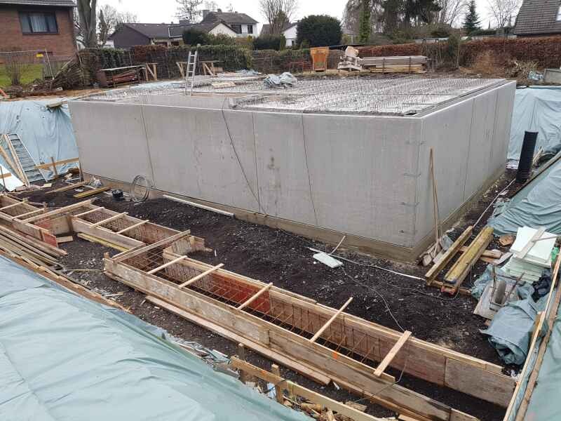

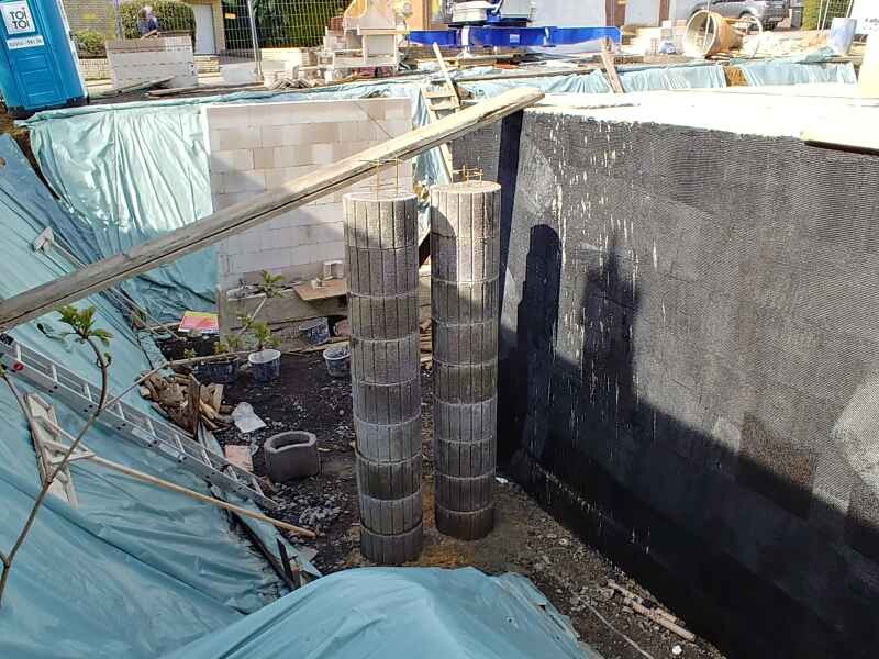

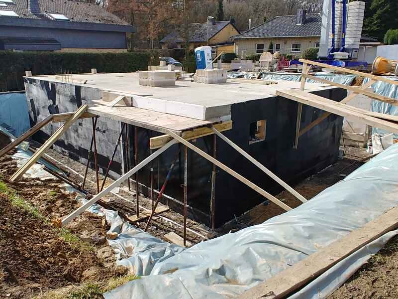

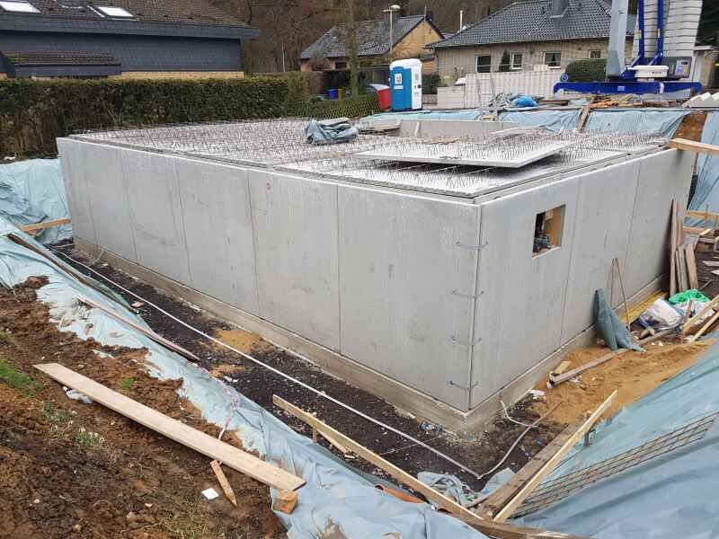

R.Hotzenplotz19 Aug 2018 20:13So, I spent another two hours at the house earlier.
The waterproof concrete itself seems fine to me. The walls show no signs of moisture penetration. If any water is coming in from outside, it must be entering between the basement slab and the waterproof concrete wall. Those are also the spots showing moisture marks, which in one room reach about 20cm (8 inches) high – the water level in the basement could never have been that high.
The construction manager called. He is on vacation, and tomorrow a substitute site manager will contact me and visit the construction site. I will be there as well. He said he absolutely cannot imagine that anything is leaking through the waterproof concrete and that the basement is not sealed. He has been monitoring this the whole time; his inspector approved the basement before backfilling, our inspector did the same and even praised how well the basement was built. This is what it looked like:
Instead, the construction manager believes the plasterers must have had a leaking hose or forgot to turn off the water, and then perhaps they claimed that the water came from rain. According to him, since they left the site when it was not perfectly dry, that’s why there is trouble.
Besides the damp spots near the base of the basement walls, I also noticed and investigated the following today.
a) Condensation droplets are already forming on parts of the basement ceiling.

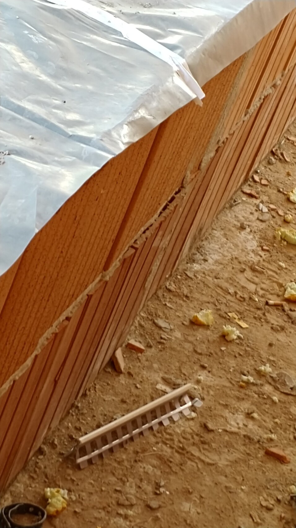

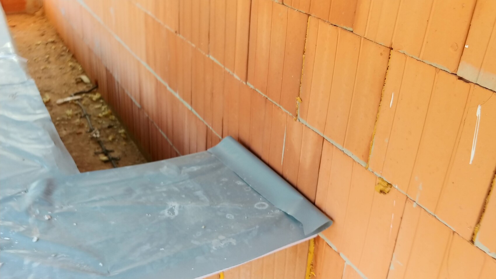

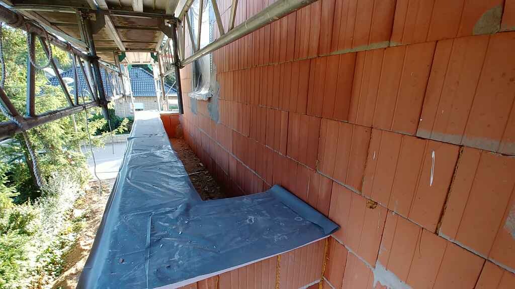

b) Only three Halox cans are wet, specifically the three in the kitchen, which is located under the flat roof of the kitchen bay. I was on the scaffold and took some photos from outside. I would guess the darker Poroton bricks are soaked? On the left wall, there is also a spot in the Poroton that doesn’t look very reassuring.
c) What they told me about water having entered the guest toilet, I don’t see any evidence at all. Both the pipe of the vent stack was completely dry and I couldn’t find any other wet spots in that area.
So, in the ground floor, only the issue with the kitchen outlets and the flat roof needs to be clarified, and in the basement, the cause of the moisture. Hopefully, the plasterers just made a mistake. Considering the amount of water that must have come in, it probably can’t be from rain. It rained even before backfilling, and no water got in then. It just doesn’t add up logically.
