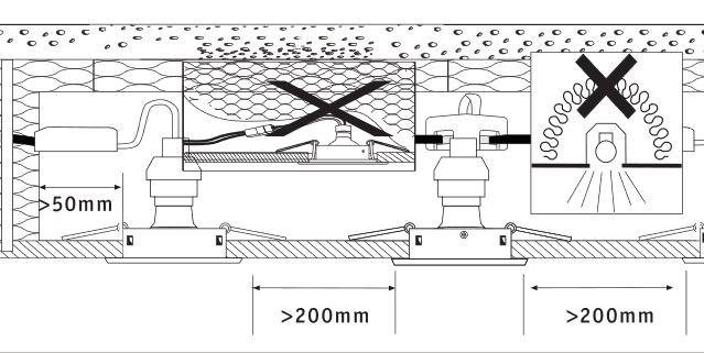

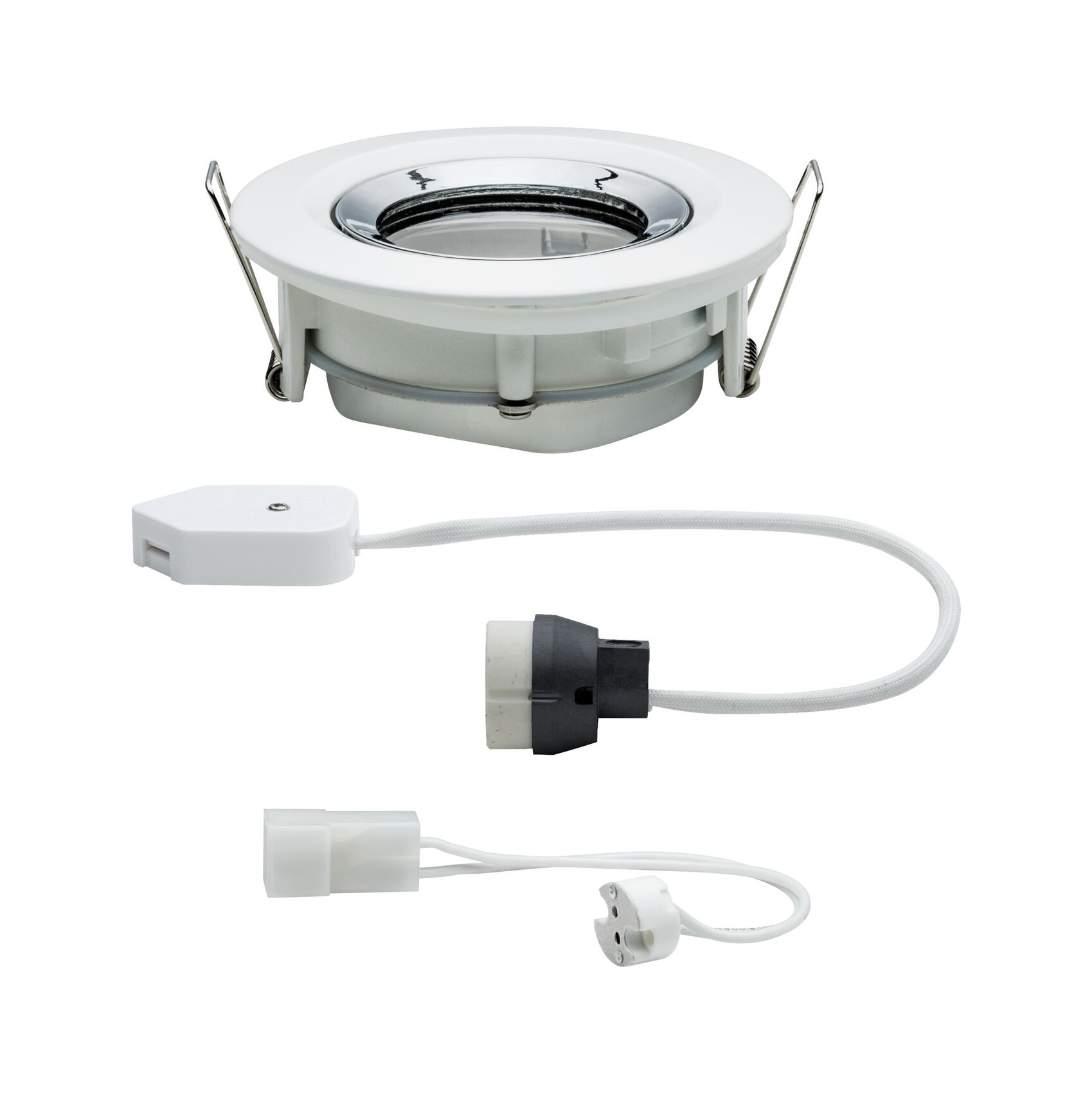

I plan to use the LED Nova IP65 recessed light round max. 35W white/chrome 1-piece set pivotable (item no.: 936.63) from Paulmann in the panel ceiling of my bathroom. Now I am wondering how this works with the HaloX boxes.
Looking at the pictures on the Paulmann website, it seems these recessed lights are designed more for suspended ceilings because of the two small side legs that, with the springs, are pressed against the suspended ceiling.
How is it possible to install these spotlights with HaloX boxes? Using a 100mm (4 inches) box probably won’t work, as the side legs would likely hit the box walls. So, you would need to use a (significantly?) more expensive 180mm (7 inches) box so that it resembles a "suspended" ceiling and the legs rest on the front edge of the box. Or am I misunderstanding this?

The spring tension on your Paulmann lights leaves a lot to be desired. Especially when these units have a sealing ring and the springs don’t pull properly, it can be frustrating. There are better manufacturers out there.I can only speak about the Basic 5-watt dimmable lamps. The springs grip a drywall panel like there’s no tomorrow! I’m already dreading having to remove them again...
Alessandro17 Apr 2020 09:00That’s exactly what I mean. In the Halox box, you still have the cable for connection and a terminal box. All of this needs to be stored inside the Halox box, which then presses against the fixture from above or the side. If the spring is not strong enough, you need a lot of patience to arrange everything so that it somehow works. It cost me a lot of nerves.
Make sure that the opening of the box is cut out to a maximum of 7cm (3 inches). Then you have all options available.

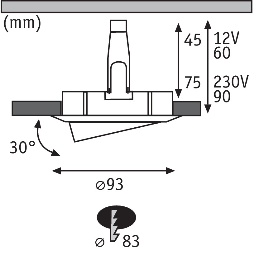

That will probably depend on the recessed spotlight. For the one I mentioned in post #1 (Nova version), you will likely need to cut an 83 mm (3.3 inch) hole for the box (see attachments). The 70 mm (2.8 inch) opening you suggested won’t be nearly enough. Maybe you are referring to a different model? Which one do you have exactly? Perhaps just the base version, which might be why yours look cheaper?
