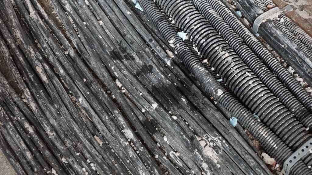

And more:

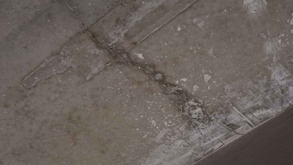

The crack in the basement ceiling in the hallway, which was supposedly within acceptable limits at the time and was accepted by two of my experts, now looks like this:
Cracked concrete floor with stains and moisture

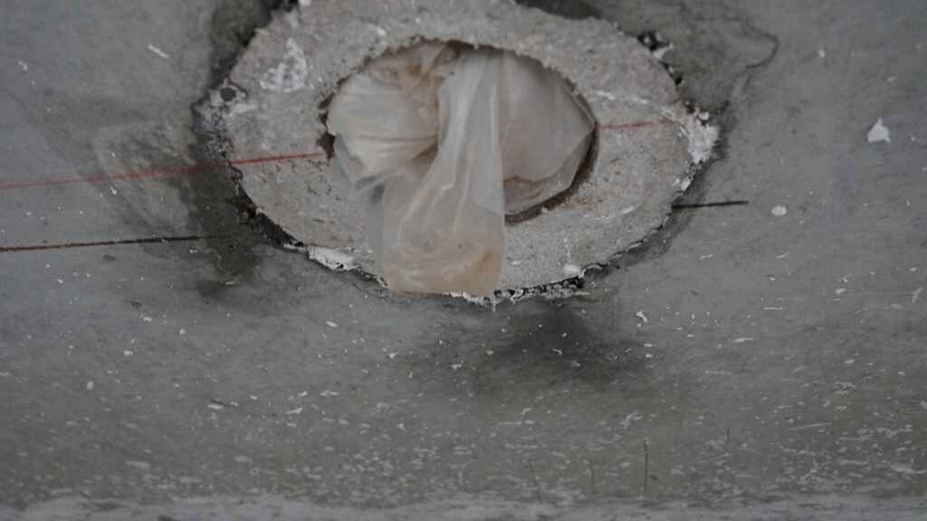

Concrete floor with round hole and plastic bag during shell construction work
Long grooved pipes and cable ducts lying on a construction site

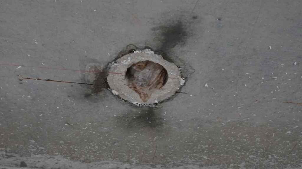

Core drilling in concrete floor with cement dust and visible reinforcement

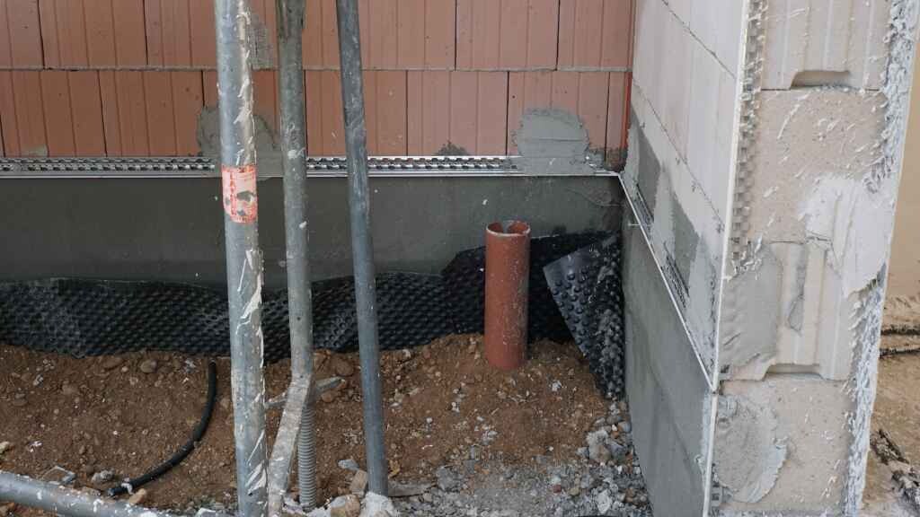

Construction site at shell stage with foundation, pipes, and waterproofing visible

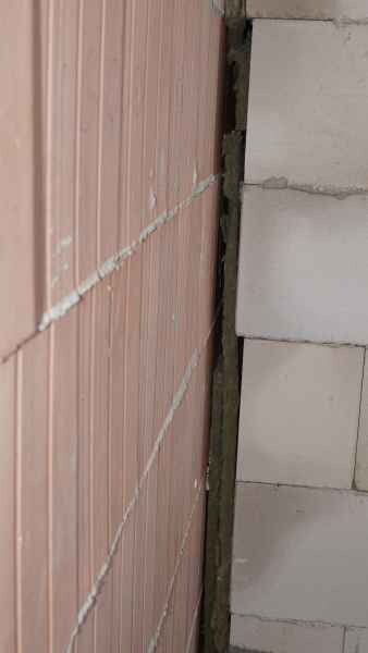

Construction joint between brick wall and concrete wall with gap

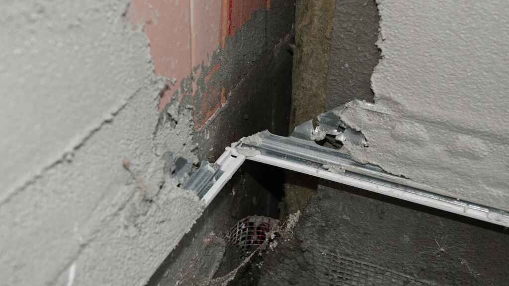

Interior wall with plaster detachment, concrete and metal frame—construction defect scene
This high-quality-looking work is located between the house and the garage.

The site manager’s response is already available. He assumes the water comes from plastering and not from a construction defect.
He says he cannot imagine such a massive water ingress through the basement walls, as in the basement area they used waterproof concrete, an external waterproofing layer, and Pentaflex sheets in the joints.
Therefore, such a high level of water ingress cannot originate from the walls or from the rain, as it would have occurred much earlier otherwise.
