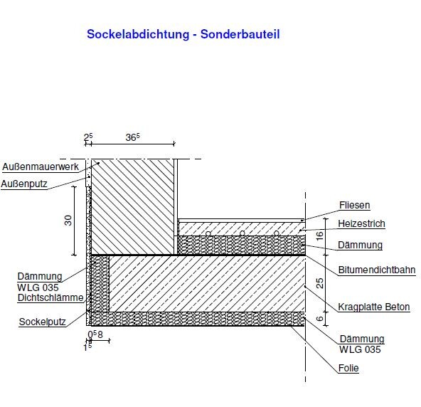

Here is finally a detailed drawing of the base waterproofing, which has been the subject of prolonged discussion.
Section of a base waterproofing: insulation, bitumen waterproof membrane, plaster, and concrete.
