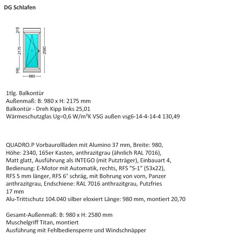

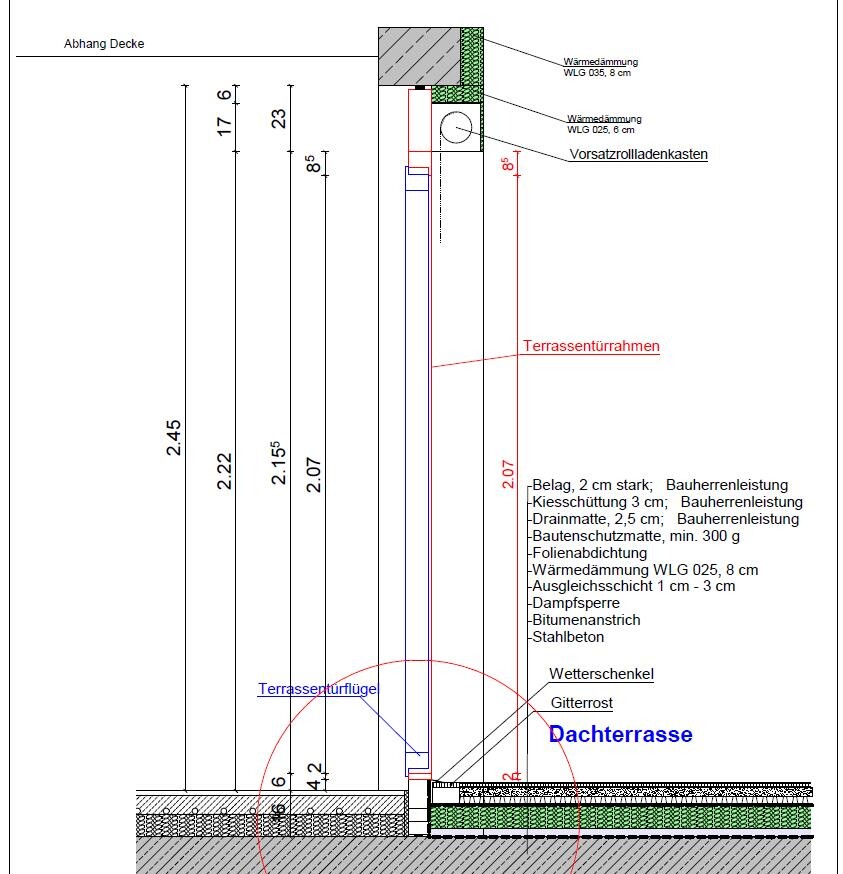

R.Hotzenplotz13 Aug 2018 16:03Finally, the offer for the modification of the terrace doors has arrived. It costs €13,000 plus owner-provided services, as shown in the attached diagram. As I understand it, these owner-provided services would also apply in the other option since they are part of the floor installer’s contract. At first glance, the amount of additional glass area (clear height) gained seems very limited.
From a budget perspective, it’s feasible... whether the benefit justifies the cost, I have to consider now... after all, you live there for decades... but how much extra glass area do you really get...

R.Hotzenplotz13 Aug 2018 19:14No, it concerns the entire floor on the terrace side. The lighting is one issue, the other is the annoying threshold, which will never be just 15cm (6 inches).
I only copied the bedroom window as an example. I have this for every room.
