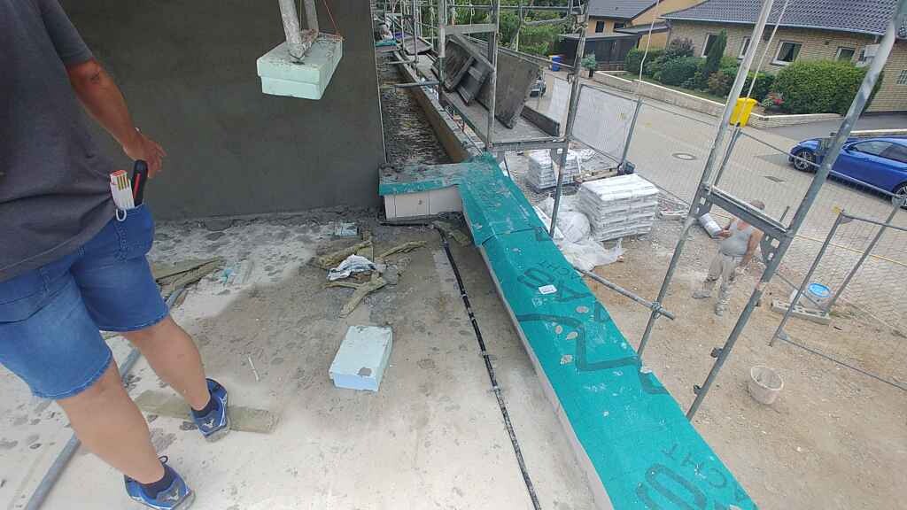

Snowy36 schrieb:
Aren’t you still at the interior plastering stage? So why are the gutters removed?Interior plastering was done last week; since yesterday they have been working on the exterior plaster. I suspect they removed the gutters last week, against all logic. Another possibility is that the plastering schedule had been set weeks ago and was abruptly stopped by the general contractor due to the expert and the lawyer’s involvement. It’s not impossible that the pipes had already been removed then.
The site manager also noticed yesterday that the garage roof isn’t properly drained yet. He plans to report this to his colleague so it can be addressed after the vacation.
Here, all the water from the gutter spilled onto the area, stood there, and apparently found its way into the house.
R.Hotzenplotz schrieb:
and suddenly the entire basement is wet, and everyone tells you that this is not normal to this extent despite cleaning. So far, I only know plastering water from cleaning, not from applying plaster (?) – obviously, water is bound in the plaster, but after application, it is not soaked like a rice field. Therefore, without the photos of the leak points, I would have thought they were just fooling you.
So far, I’ve only heard of “plaster water” in the context of cleaning, not during plastering (?) – obviously, water is bound within the plaster, but after application, it’s not wetted again like a rice field. So without the photos of the leak points, I would have thought someone was just fooling you.Do you wet walls in new construction beforehand? No idea. But the plastering machine does have a water hose; otherwise, it would be a very dusty process.

R.Hotzenplotz21 Aug 2018 19:29The site manager said that they usually carry some kind of thick water hose through the house and bend it during transport, but that is not enough to prevent water from leaking. No idea how the processes work there.
Our exterior plastering still has to be done, but I don’t think the gutters will be removed for that; otherwise, they might as well have left them off from the start...
Why leave the garage without drainage? In the other thread, you posted pictures that don’t look very good; won’t the plaster get damaged by that?
