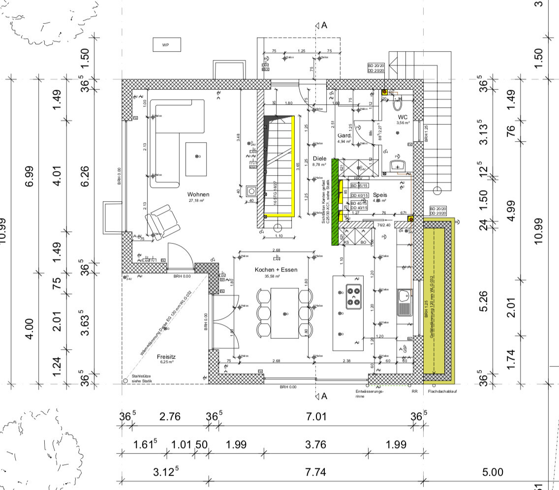

benediktr8 Feb 2021 21:07Lote1971 schrieb:
Great, then I wish you good luck.Thank you as well. I think you could manage with your budget. The heating/plumbing item is estimated quite high. I see potential for savings there. I find the house style very appealing, but the ground floor layout wouldn’t suit me. The idea of having cooking, dining, and living all in a row feels uncomfortable to me. But of course, that’s a matter of personal taste. Here is the layout of our ground floor at the final stage. The orientation is pretty much the same, but we also have a basement.
benediktr schrieb:
Thank you as well. I think your budget could work. The heating/plumbing estimate seems quite high. I see potential for savings there. I find the house style very appealing, but the floor plan on the ground floor wouldn't suit me. The idea of having the kitchen, dining, and living areas arranged in a line feels uncomfortable to me. But of course, that’s a matter of personal taste. Here is the floor plan of our ground floor in its final stage. The orientation is quite similar, but we also have a basement.
I really like your project. Thumbs up!benediktr schrieb:
How am I supposed to understand thisbenediktr schrieb:
Here is the floor plan of our ground floor in its final stage.Yes, you can clearly see some differences there. However, I mentioned your house more as an example of a house design that I consider a practical approximation of the original poster’s current plans, aiming for a less impactful integration into their building area. I also deliberately did not link, for example, post 9858 https://www.hausbau-forum.de/threads/haus-bilderthread-zeigt-her-eure-hausbilder.14011/page-1643#post-453294, but started with your thread to allow following the development. Not least because your house was, at first, not my favorite project and still isn’t, but it has evolved.https://www.instagram.com/11antgmxde/
