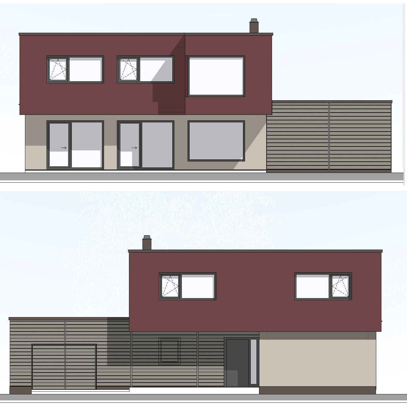

Modern two-story house front: brown upper floor, beige ground floor, large windows.

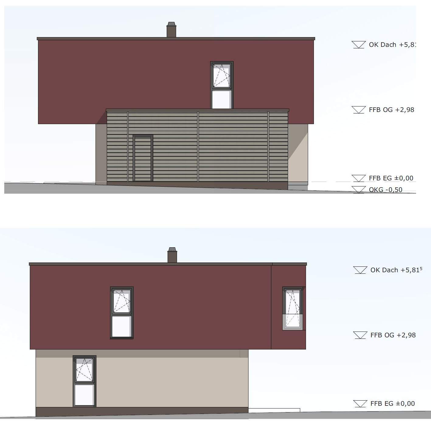

Two facades of a modern house: brown attic, wood cladding, doors and windows

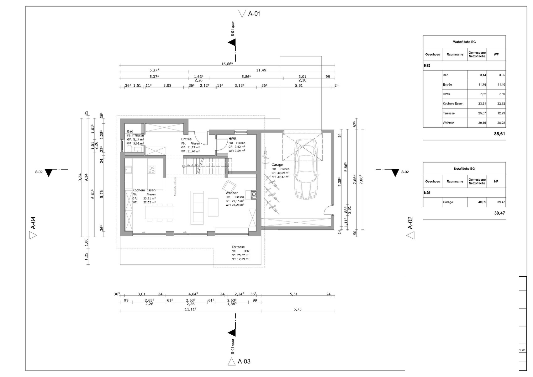

Ground floor plan: kitchen/dining, living room, bathroom, entrance, utility room, garage, terrace.

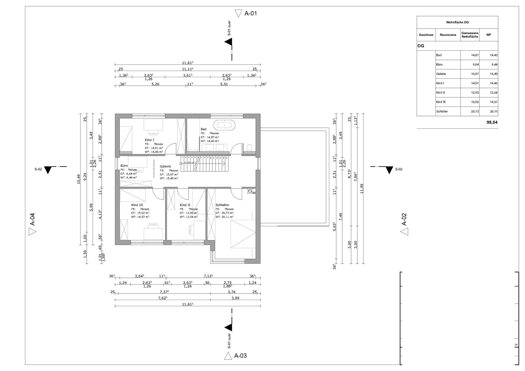

Upper floor plan with bedroom, children’s rooms I–III, office, gallery, bathroom, staircase

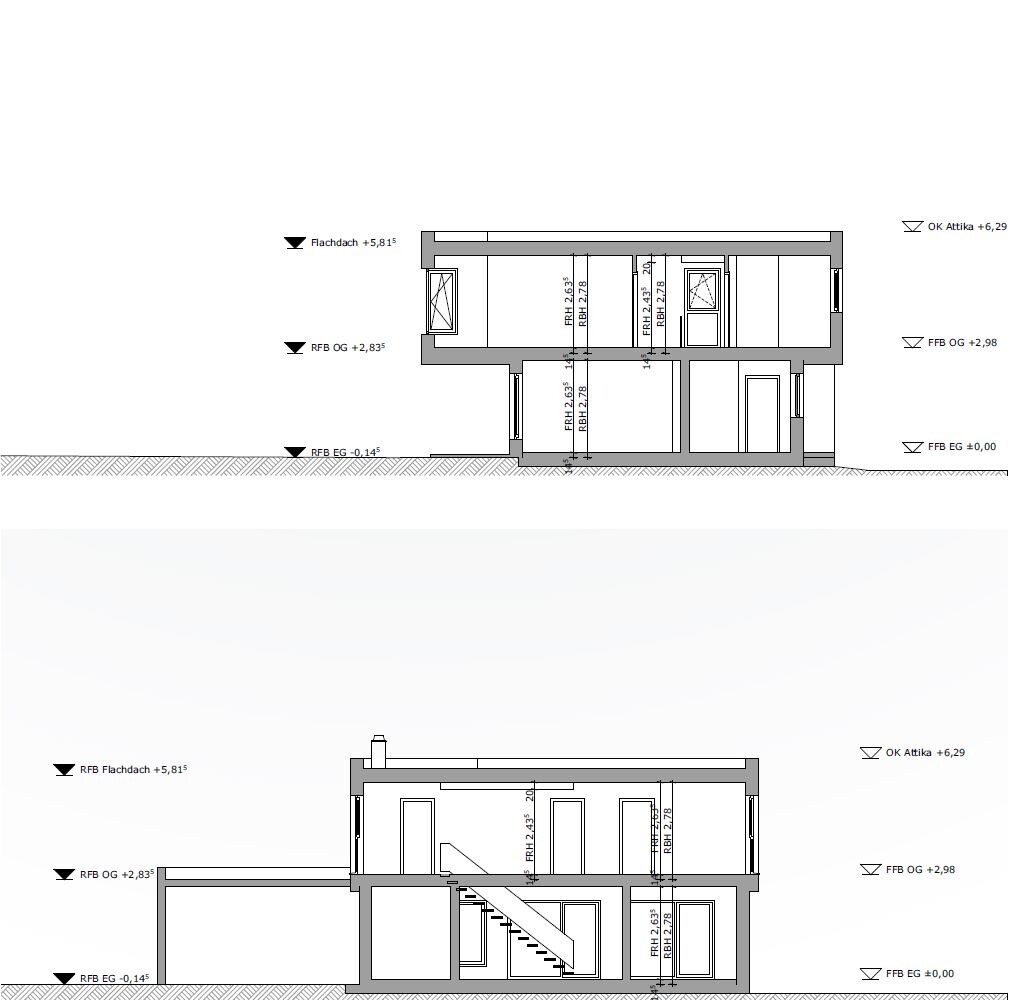

Cross-section through a two-story building: stairs, doors, windows, floor height details

Would you like to explain what your intentions are with this?

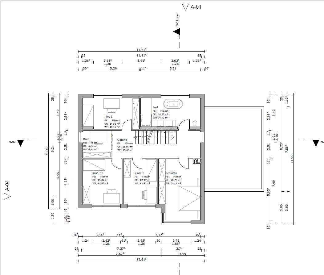

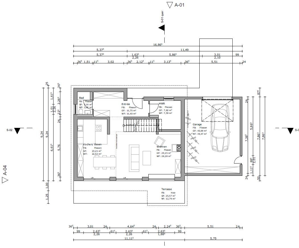

And could you please upload the floor plans in better quality? Important dimensions are not readable.

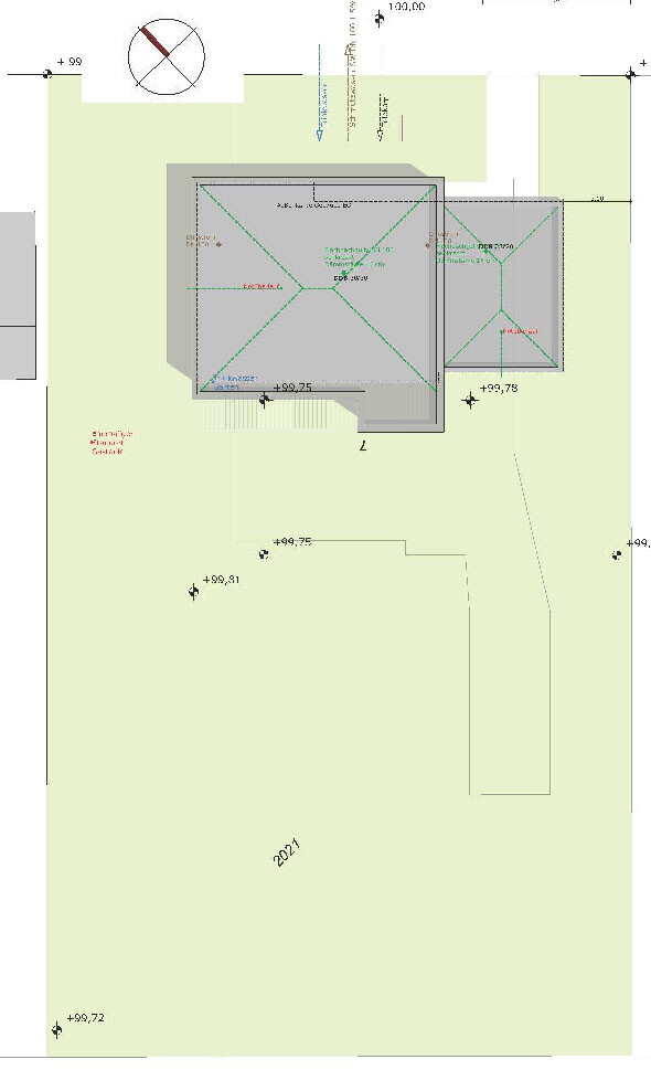

I see complications with approval under Section 34.
In principle, I don't find the exterior design bad. Specialists can certainly judge the floor plan.
Depending on the execution, the construction costs are underestimated. Today, I wouldn’t build without controlled residential ventilation.
I wouldn’t call it Bauhaus yet. It’s more cubist with a flat roof.

Regarding the design: at first glance, I liked the basic concept.
However, the kitchen will be very dark, and when guests are over, it will be difficult to move freely in the kitchen alcove. It also won’t be easy for two people to work there simultaneously. Where are the refrigerator and oven located?
The flow of many daily tasks seems quite complicated and not smooth here. Definitely not smooth at all.
The staircase looks very steep or short to me.
There is fundamentally no storage space. The limited 7sqm (75 sq ft) is only enough for a shelf with tools, light bulbs, and cleaning supplies.
I don’t see any space for drying easy-care laundry, beverage crates, decorative items, mop buckets, recycling bags, or an ironing board. (All placeholders for many things)
Unfortunately, the questionnaire is not filled out regarding the number of people and their preferences or needs. One can see the current situation, but the target situation is unknown.

first of all, please provide sharper floor plans

Having an office in the hallway is the biggest distraction during video conferences,

Nida35a schrieb:
Planning such a bulky building in an established residential area,
expect a rejection from the authorities, it doesn’t fit the neighborhood
We took inspiration from (see attachment), and we liked this design very much:
Also: if everyone builds like the surrounding houses from the 1930s,
there would hardly be any modern buildings:

Ground floor plan: kitchen, dining, living, bathroom, garage, and terrace.
Upper floor plan: bathroom, office, gallery, bedroom, children’s rooms I-III, stairs.

Regarding the design: at first glance, I kind of liked it.
But the kitchen will be very dark, and when guests are over, it becomes difficult to access the kitchen nook easily. Working there with two people won’t be easy either. Where are the refrigerator and oven located?
The workflow for many daily tasks seems quite complicated here—not smooth at all. Definitely not smooth.
Thanks, I will think about that some more.
Basically, there is no storage space at all. The limited 7sqm (75 sq ft) is only enough for a shelf with tools, light bulbs, and cleaning supplies.
I don’t see any space for drying low-maintenance laundry, beverage crates, decorative items, mop buckets, recycling bags, or an ironing board. (All placeholders for many things)
All of that will go into the large garage ;-)
