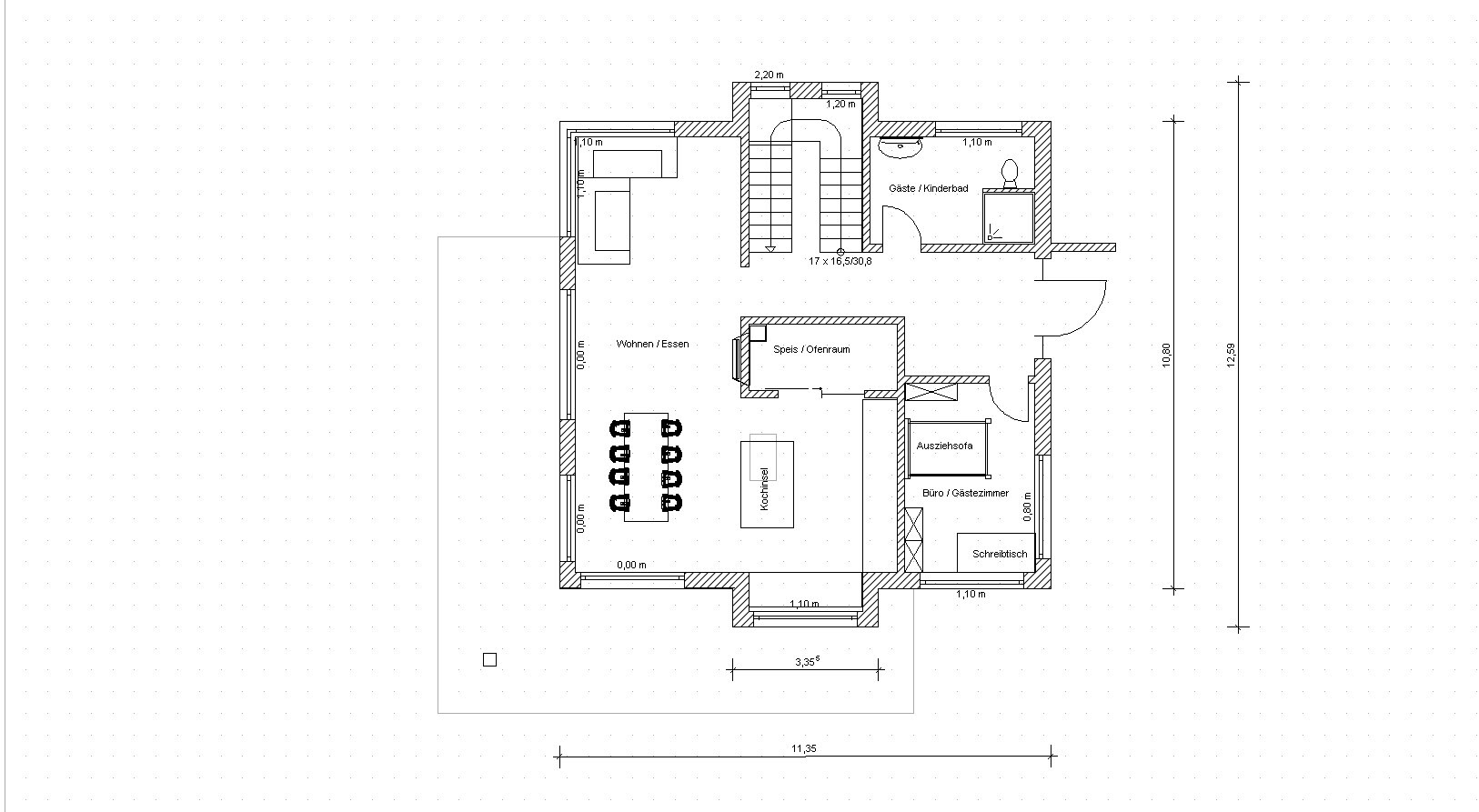

after a long period of quietly reading, we have now reached an important step. We are planning a single-family house with approximately 210 sqm (2,260 sq ft) of living space on an existing plot of land (about 900 sqm (9,690 sq ft), almost square, no special building regulations) in the district of Landshut.
Through several visits to show homes and discussions with various providers, a floor plan has gradually developed that reflects our ideas very well.
We would greatly appreciate constructive feedback from you. We are currently unsure about distances, passageways, and hallway sizes, especially how the planned widths will feel in practice or if they are practical.
An initial cost estimate is around 2,500 €/sqm (DIY or self-managed trades work is possible and even preferred) plus 100,000 € for the basement and demolition costs (mostly self-performed), totaling approximately 625,000 € (excluding kitchen and other fittings). Does this seem realistic?
Thanks in advance!
Sebastian

Without measurements, it is difficult to assess the distances accurately.
The toilet in the ground floor bathroom should be rotated to avoid too little space.

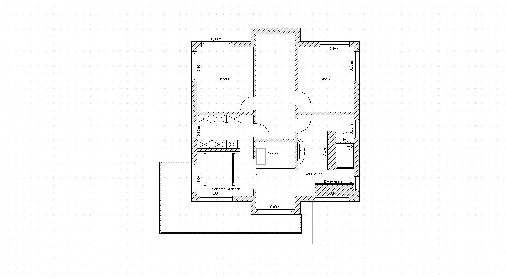

Upstairs, the bathtub stands out as it seems very narrow.
The bedroom does not really feel like a comfortable room.
Without measurements, I find the design unworthy of further consideration: for 210 m² (2260 sq ft), the children's bathroom is combined with the guest toilet, and there is a long corridor running through the entire house to reach the kitchen, passing along the lounge area. I have already mentioned the bedroom and the bathroom being larger than the children's room...

Should the children on the ground floor always have to use the bathroom there and go up and down the stairs? The bathroom on the upper floor is huge, and if a child were to use the toilet there, they would first have to close the sliding door, which would also need to be lockable. That is very impractical.

All nice features on their own, but as modules in your design they don’t work well because practical everyday aspects haven’t been considered—especially those concerning children (which you can tell from the fact that these rooms are unfurnished). A pantry heated by a stove is not ideal for food storage. The distance from the entrance to the kitchen is long—you don’t want to have to walk that far. And others already mentioned...
What to do?
Make a list like the one above, and add another list that outlines what you (all) like to do and how your daily life looks or is supposed to look. Then take this to someone eager to design a building based on your functional and non-functional requirements. Whether that’s a prefabricated house manufacturer, a general contractor, or an architect is secondary for now—my pick would again be the latter. How large the house will be will become clear—you’re not fixed on 215m² (2,313 sq ft), right? Sometimes smaller is better—even without necessarily being cheaper.
The budget looks roughly okay for now.
What to do?
