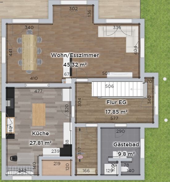

I’m a bit overwhelmed with our floor plan and keep running into the same problems...
The main issue is probably how to integrate a straight staircase from the ground floor to the upper floor, and how we would have to modify or extend the hallway to fit such a staircase without "breaking up" the other rooms.

Overall, the floor plan is good and was implemented largely according to our ideas.
What do you dislike? Why?

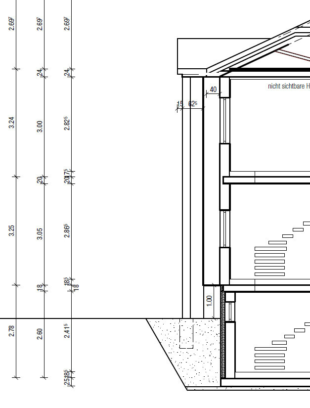

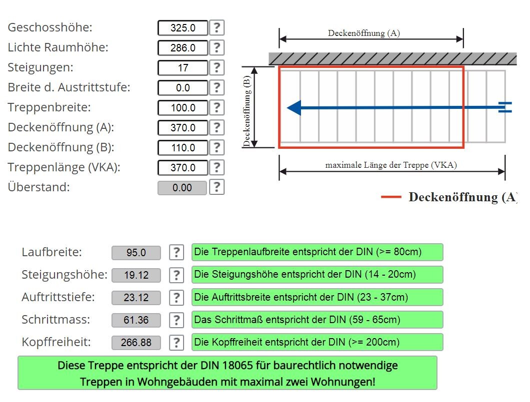

We would prefer a straight staircase. According to a staircase calculator tool, it would require a length of 3.70 m (12 ft).
From research, this might be rather uncomfortable and therefore unrealistic.
We would be willing to extend the hallway for the straight staircase if necessary.
Symmetry, especially in the front view of the house, is very important to us, so we want to keep the type of front door as is.

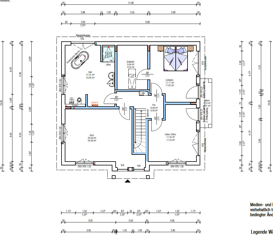

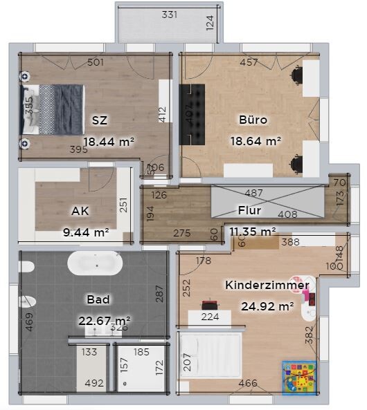

The awkward corner in the upper hallway is not very appealing (bedroom / office).
Furthermore, the hallway window was initially placed in the child’s bedroom, but that will be changed so there is natural light in the upper floor hallway.
I’m also wondering if the chimney flue on the upper floor can still be routed freely, possibly offset within the ceiling/floor. Or does it have to go straight up from the ground floor fireplace? Because then it would end up right in the middle of the upper floor hallway.
If you have to give up something, which details or fittings could you do without?
- Could you compromise on: I’m open to suggestions for now
- Cannot compromise on: ideally the straight staircase
See differences between our design and the construction company’s plan
- straight staircase instead of quarter-turn
- kitchen recessed
- window in the hallway instead of in the child’s room
- ideally no hallway obstruction on the upper floor

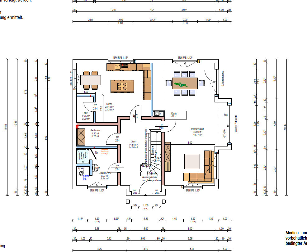

Your floor plans do not align
Why are there two dining areas?
Why the bay window?
Why the huge bathroom on the ground floor?
Why the basement?
The house seems oversized in many areas, as if you don’t know how to use the space.
A straight staircase with a length of 3.7 meters (12 feet) won’t work. It needs to be 4 meters (13 feet). The entrance is one example:
You open the door and almost fall down the basement stairs. And yet there is a 9-square-meter (97-square-foot) guest bathroom—who or what is that for?

haydee schrieb:
We would like a small everyday dining area and a larger one for guests. We are the center of our family, and celebrations are usually hosted at our place.
Edit: The dining area in the kitchen is just a bench with a small table.
The bay window is meant to break up the rather large house a bit, and we also like how it looks.
We currently live in just under 160sqm (1,722 sq ft) in an apartment and had a large apartment before that; we prefer not to downsize.
The guest bathroom could have been smaller for me. However, my husband wants it a bit bigger since it will also include a large cat litter box.

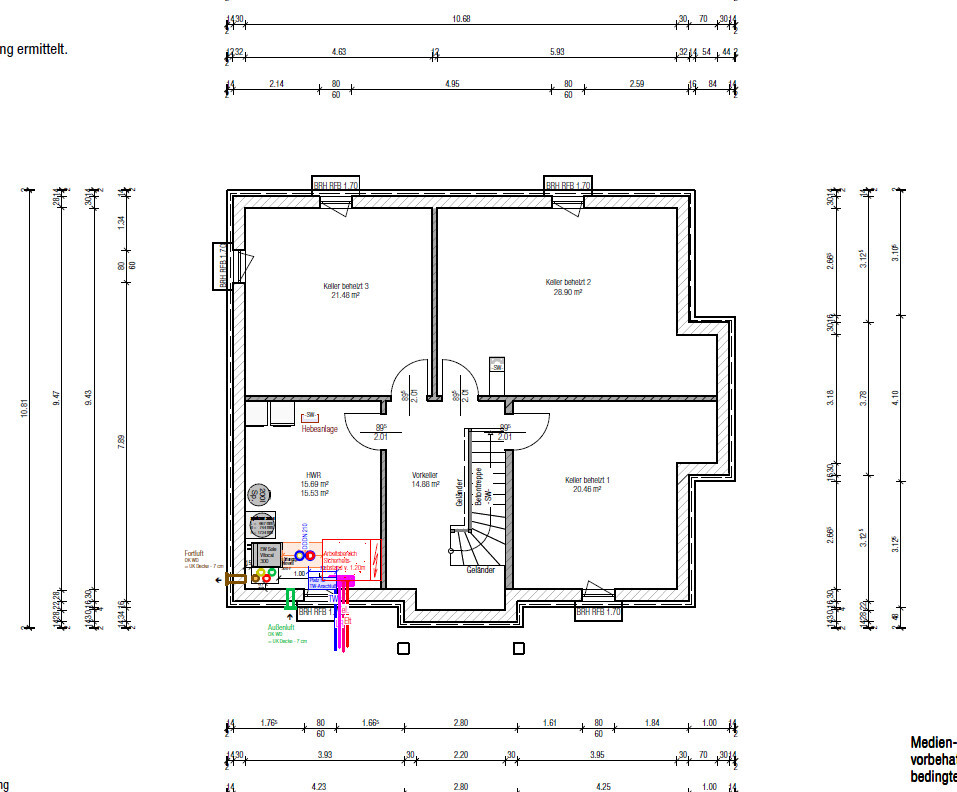

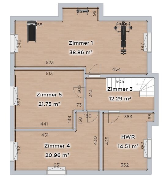

The basement will have a gym, a storage room, the utility room, and a hobby/second home office.
The current estimate from the builder for the house including the basement is about 550,000€.
What exactly do you mean about the staircase?
The basement stairs would start near the living room door; hopefully, no one can accidentally fall down them from the front door area.
Yes, I have also doubted the staircase calculations, but I don’t understand how it can comply with all DIN standards and still apparently not work.

So, your statement @11ant basically means:
1) Either leave it as is and accept the compromise, or
2) Redesign everything so the straight staircase can fit differently?

Your rooms are completely oversized.
200m² (2,153 sq ft) is certainly large, but a guest bathroom of 9m² (97 sq ft), a kitchen of 28m² (301 sq ft), a children’s bedroom of 25m² (269 sq ft), and a main bathroom of 23m² (247 sq ft) are simply unnecessary.
When you furnish the rooms, it looks thrown together.
