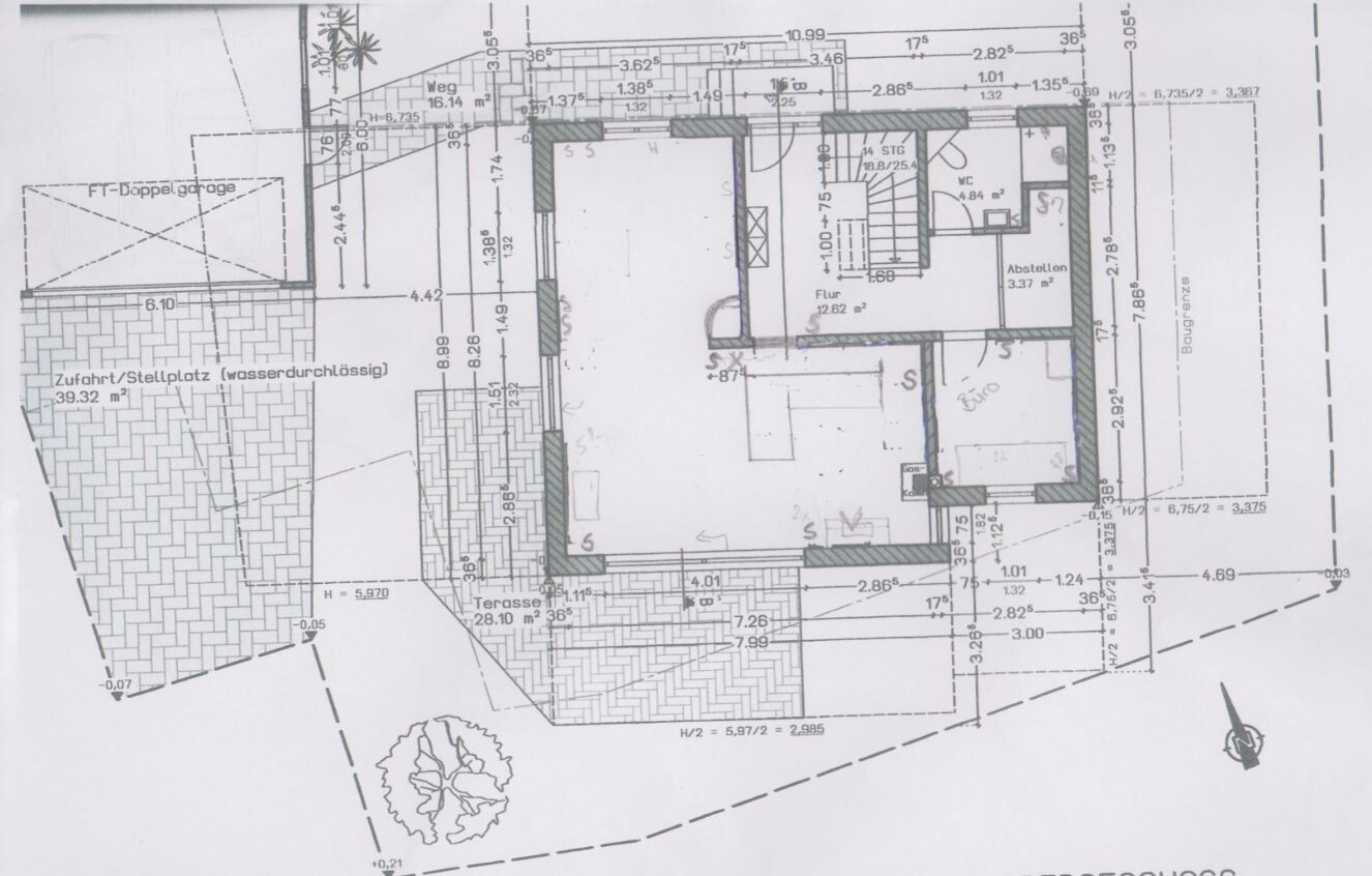

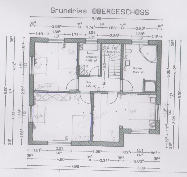

Hausherrin4713 May 2018 19:00Hello,
we are currently planning our single-family house. The design was created by the architect based on our specifications and submitted; the municipality has already approved the exterior dimensions and the few deviations from the development plan. The design is now with the district office, and we are waiting for the final approval. As mentioned, the exterior dimensions are fixed, but we can still optimize the interior, and I wanted to gather more opinions regarding the windows (number, size) and general suggestions – is anything too big or too small? Are the distances acceptable? What should we consider? The floor plan is closely based on my parents’ semi-detached house, and we are very satisfied with the layout, but maybe we have become “too close” to it and don’t see further possibilities…
I have already tried to place the furniture on the ground floor and first floor. "S" marks possible power outlet locations. Anyone who notices something can feel free to comment on that as well 🙂
The kitchen has not been planned yet...
Thanks in advance for all ideas!
Best regards 🙂
Plot size: 400 sqm (4,306 sq ft), planned house area 170 sqm (1,830 sq ft)

Ideas for optimization suggestions regarding interior design / windows / doors, as there might still be room for changes. For example, I cannot quite fit the dining table at the moment… General remarks regarding size – which rooms are too big or too small?

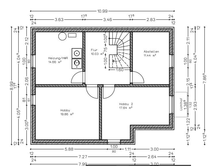

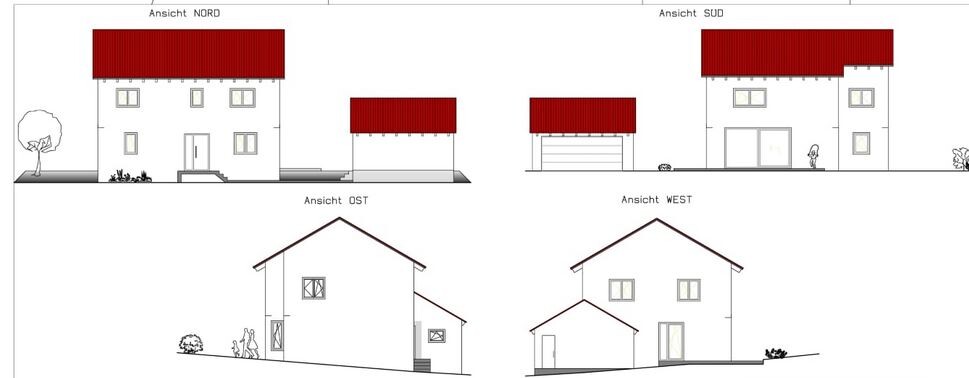

Hausherrin47 schrieb:
The design was created and submitted by the architect according to our specifications; the local authority has also approved the exterior dimensions and the few deviations from the development plan. The design is now with the district office, and we are waiting for the final approval. Apart from moving non-load-bearing walls or doors and windows, I don’t see much left to “rescue” – though this isn’t significantly necessary. For the bathroom and kitchen, I am still expecting some suggestions; I haven’t found any “errors.”
Hm, placing a double bed would be an advantage.
But beyond that, nothing else can be done. While a window can be moved by about 20cm (8 inches), it cannot be enlarged (energy saving regulations) or the facade design changed without submitting an extended building permit / planning permission.
But otherwise, nothing more can be done. You can shift a window by about 20cm (8 inches), but you cannot enlarge it (energy saving regulations) or change the facade design without submitting an extended building permit / planning permission application.We were told that windows can be changed without any formal application as long as the stated energy efficiency is not affected (which makes sense to me).
Climbee schrieb:
We were told that windows can be changed without further approval as long as the specified efficiency does not change (which makes sense to me)Exactly, that's what I'm saying.
For example, enlarging a window or replacing a window with a patio door needs to be recalculated.
Some things might not matter to the building authority, but others do for structural engineers and KfW.
Exactly, that's what I’m saying. Well, yes and no. You also said "or change the facade design," and that would also apply to a window that is just moved (especially if a corresponding window is not moved as well). In this case, I appreciate the building authority’s approach of not requiring a formal change—they keep things reasonable.
