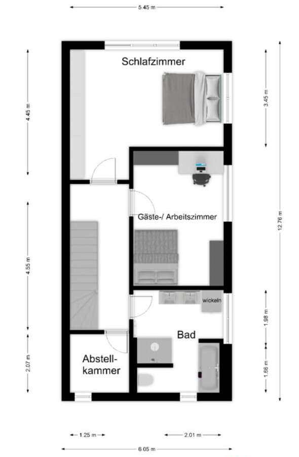

Is it possible to add a toilet on the upper floor? This reduces the risk of sleepy children falling down the stairs at night on their way to the bathroom. Also, you get more peace at night if the bathroom next to your pillow is not being used (although you might consider swapping the guest room with the bathroom).

Good evening everyone,
glad to see some activity here!
Before I respond specifically to individual posts, here is a version with the swapped guest room/family bathroom. The wall around the bathtub is, of course, only as high as the tub itself, and the sill height of the wide window is 145 cm (57 inches).
Best regards, Tamicat
