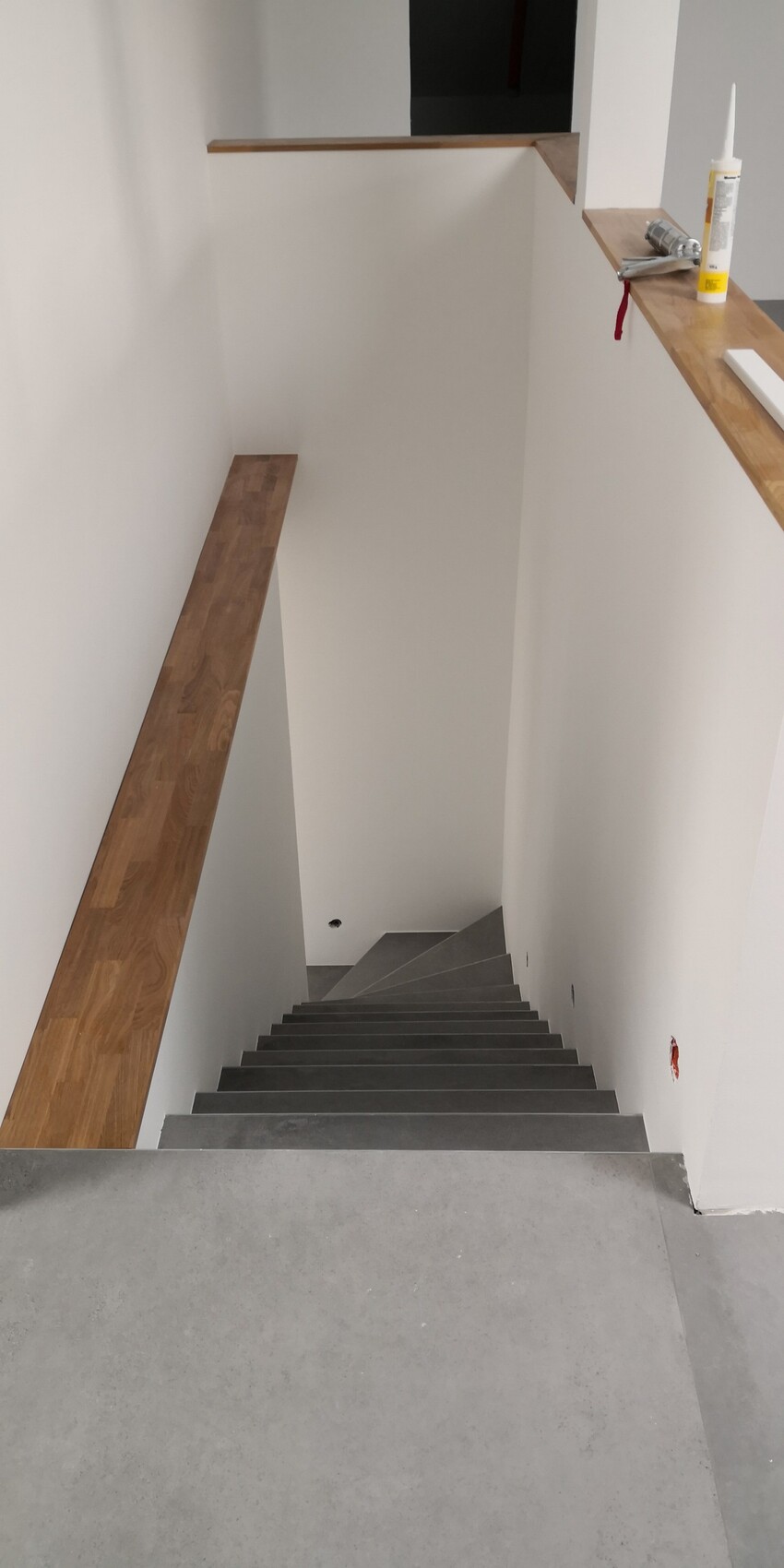

In our new house, we have a staircase quite similar to the one you are planning. Large items simply can't be carried through. For example, the box spring bed will have to be transported up using an external lift.
