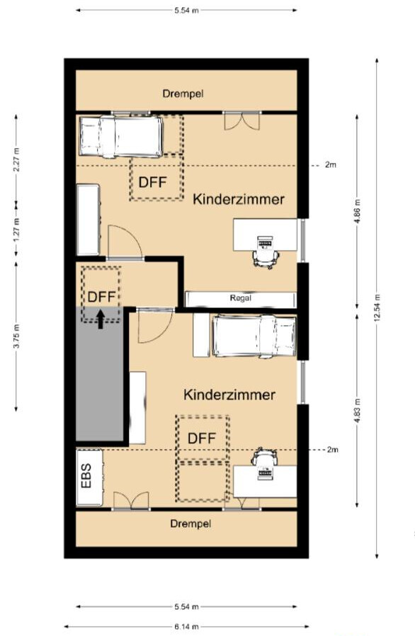

So,
here is the furnished version of the attic floor promised last night.
Floor plan of a house with two children's rooms, beds, desks, and a shelf.
Tamicat
14 Jul 2020 21:50
You should swap the rooms because of the pipes so that the bathroom is above the utility room. The window arrangement can be adjusted to compensate for that.
Would someone perhaps be willing to explain the reason related to the pipes in a more detailed and factual way? The planners and architects from four different companies all considered the implementation to be unproblematic. What exactly are they not telling us? Is it simply about the length of the pipes? Would additional soundproofing not be enough to prevent "disturbances"? Or is it just done that way by convention?
