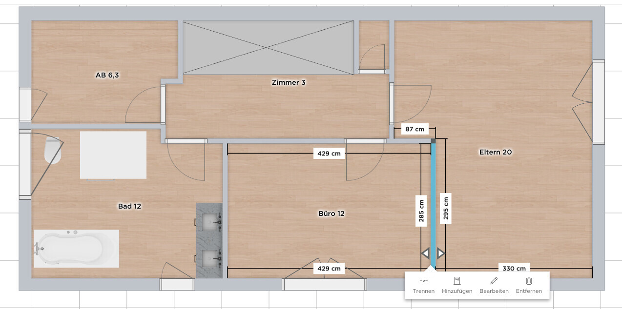

Tamicat schrieb:
@ ypg: Can you show dimensions on your alternative drawings, or is that more complicated?Unfortunately, the software doesn’t offer that feature. However, I can measure something manually. I still have the sketch saved. It was really meant just as a concept and inspiration.
Which measurements would you like to know?
Unfortunately, the program doesn’t offer that option. However, I can measure something for you. I still have the sketch saved. It was really meant just as an idea and inspiration.
Which dimension would you like to know? The relevant area would be in the office/guest room, to the left of the door, where the bed is marked on my plan. Thank you!
Tamicat schrieb:
- With a narrower bathroom door, a left-hand hinge could potentially allow collision-free opening
- Possibly a 5-10cm (2-4 inch) deeper coat closet niche
- Design of the living room door and glazing: right/left/both sides
- Height and width of the partition wall between living and dining areas
- If applicable, double-spiral staircases between floors
1. From my point of view, it is already collision-free now, probably a 76cm (30 inch) door, and the hinge side is just right; 2. or more, depending on the modular grid step; 3. leave as drawn; 4. keep the width as is (estimated 220cm (87 inch)), you need to measure the height with your partner: at least the chest height of the shorter person, maximum the chin height of the taller person; 5. from my perspective, worse in the attic, otherwise neutral.https://www.instagram.com/11antgmxde/
Tamicat schrieb:
What matters is the space to the left of the door in the study/guest room, where the bed is marked on my plan. Thanks!I don’t quite remember where you marked the bed, and I also made some changes near the exterior walls, but here is a screenshot: ypg schrieb:
I’m not sure anymore where exactly the bed is placed in your plan, and I made some adjustments to the exterior walls, but here’s a screenshot:
[ATTACH alt="Screenshot 2020-11-06 at 22.10.32.png"]53284[/ATTACH][ATTACH alt="Screenshot 2020-11-06 at 22.12.55.png"]53285[/ATTACH] Thanks. But the small room next to the stairs—is that a new addition?
