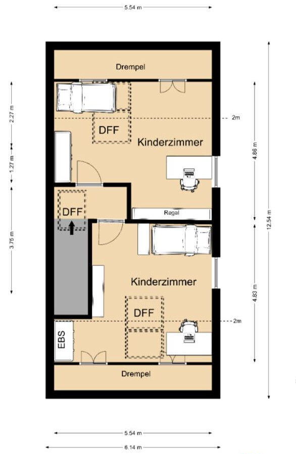

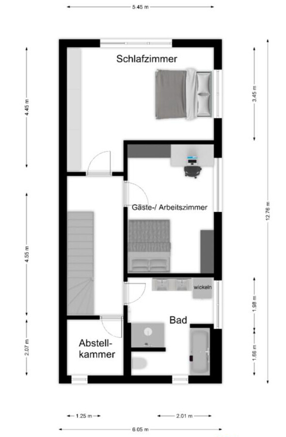

Initially, we plan to place the children’s bedroom shared between both kids and the master bedroom on the upper floor. Later on, the children will each have their own room in the attic.

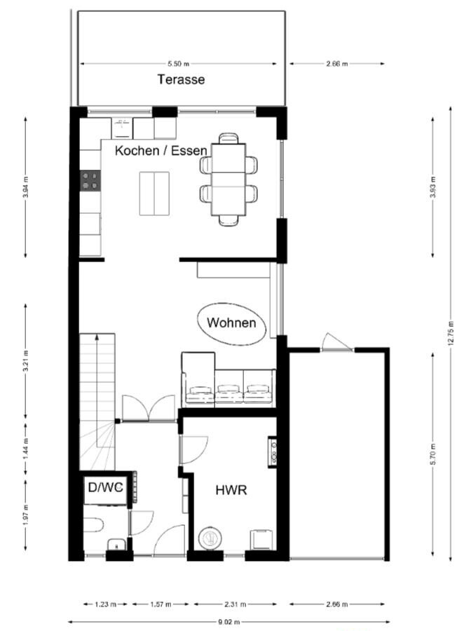

I just noticed something. Is the cloakroom area on the ground floor next to the utility room wide enough? If necessary, jackets and shoes could also be stored in the utility room. It might be possible to create a larger niche for the cloakroom by taking space from the utility room.Yes, the utility room is a recurring topic for us. The niche is sufficient for basic shoe racks and coat hooks, but not for nicer cabinets. After choosing a home builder and a specific heating system, the space requirements for the utility room should become clear. At that point, we will fine-tune the layout again...

I just took another look at the plan in #1. Adjusting it once you have the exact technical specifications is definitely a good idea. A niche for a wardrobe would be really useful.
I would consider placing a wall on the left side of the sofa in the living area (only about as deep as a sofa) to create a more separated seating space, so you’re not sitting with your back to the people entering through the front door. I hope that’s clear—I can’t find better words to explain it right now...
