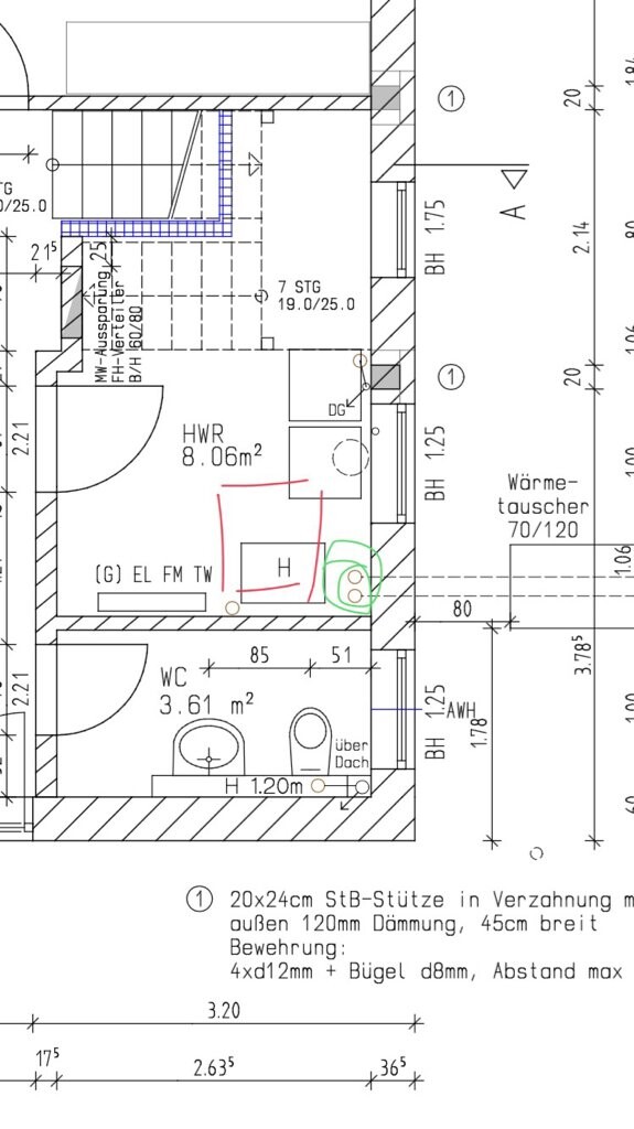

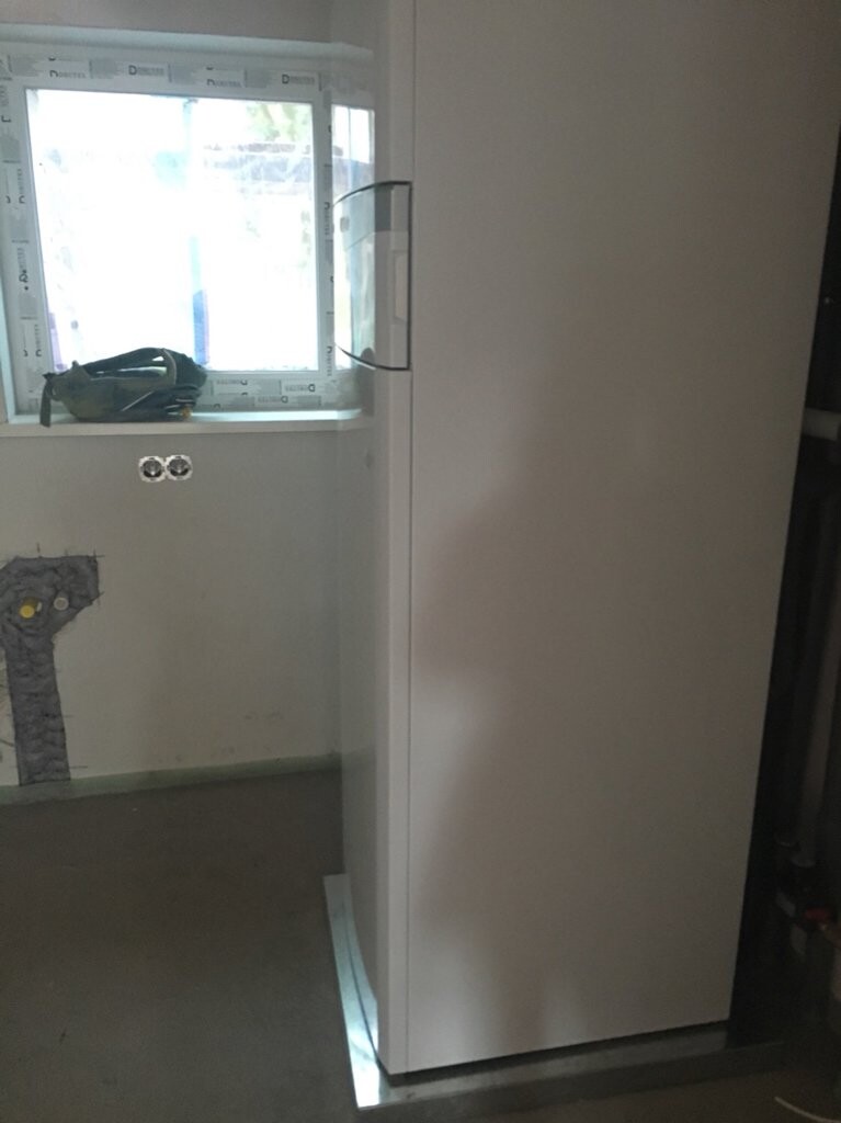

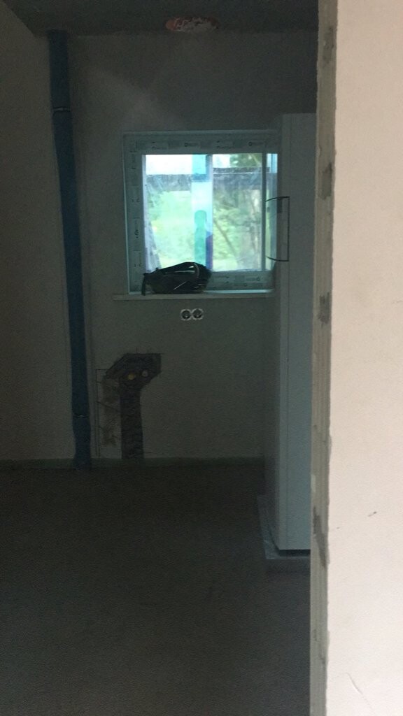

Unfortunately, its dimensions do not match the planned measurements. As a result, the heater now partially blocks the window, and the window cannot be fully opened.
According to the plan, the heater was supposed to be positioned to allow enough space by the window.
The site manager prepared the plan and the specifications and presented them to us for signature. We then commissioned the heating system.

The site manager claims that his drawing was only schematic.

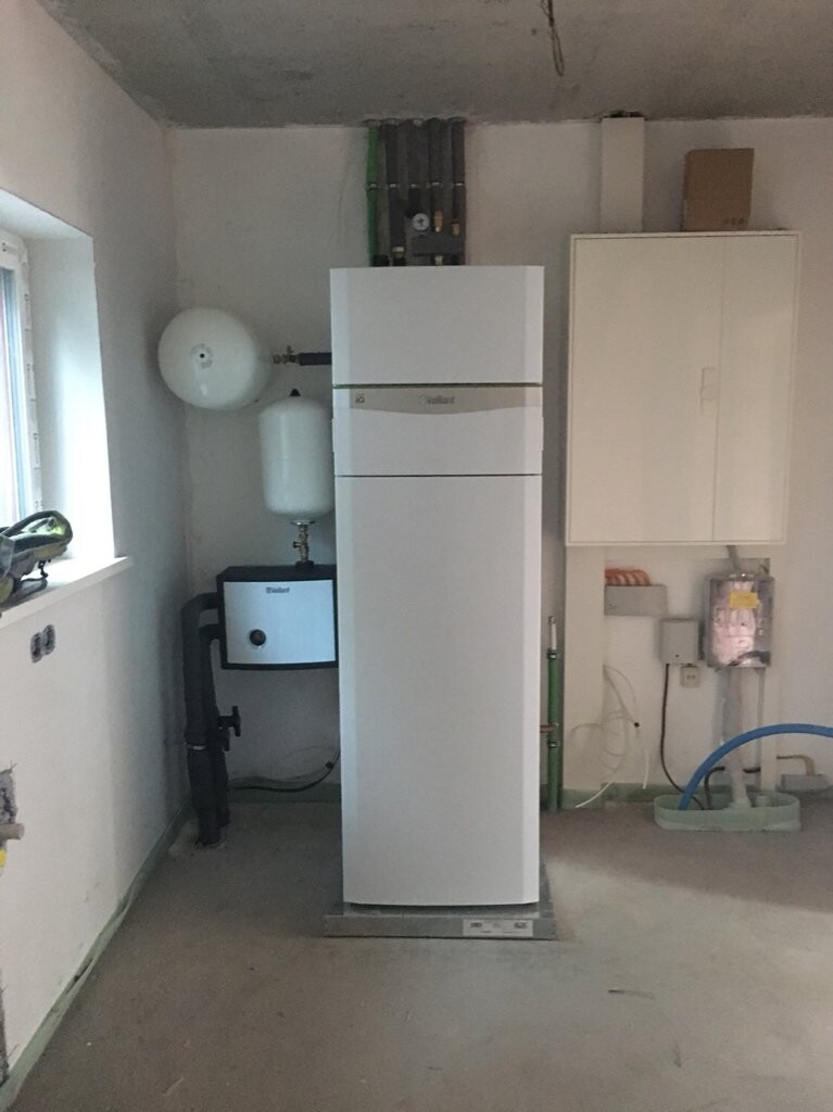

The heater is placed in the rear right corner, angled in front of the window, about 70 cm (28 inches) from the exterior wall. Next to the heater, in the direction of the window, an expansion vessel and a filling station for the external unit are installed.
If these could be relocated to a different position, it might be possible—if at all feasible—to rotate the heater and place it directly against the exterior wall. (Theoretically, there is enough space. The heater is 70 cm (28 inches) wide, and the space is 80 cm (31 inches).
Is this even possible? Can the expansion vessel and filling station be relocated?

Do you have to accept something like this? The actual dimensions differ from those in the plans.In my opinion, yes. This is not a construction-ready plan.

If this were relocated to another site, it might be possible to rotate the heating system, if at all, and place it directly against the exterior wall. (There would theoretically be enough space. ThRotating heating units is always a bit tricky. Sometimes there are specified working clearances to the left and right of the equipment that must be observed. Clearances at the back and elsewhere are also important. Usually, the manufacturer provides this information in the installation manual.
On the other hand, the position of the filling station or the external expansion vessel is more flexible.
By the way, your photo of the situation is not very helpful.
